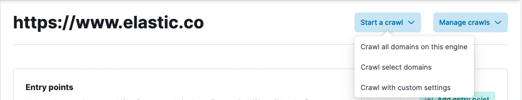

Start crawl
editStart a crawl from the web crawler or domain dashboard, or using the App Search API.
To use a dashboard, navigate to Web Crawler, then optionally choose a domain to manage. Choose the Start a Crawl button at the top of the dashboard.
Each engine may have only one active crawl. The start button changes state to reflect a crawl is in progress.
To start a crawl programmatically, refer to the following API reference:

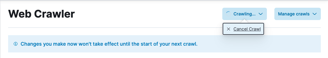

Cancel crawl
editCancel an active crawl from the web crawler or domain dashboard, or using the App Search API.
To use a dashboard, navigate to Web Crawler, then optionally choose a domain to manage. Expand the Crawling… button at the top of the dashboard. Choose Cancel Crawl.
To cancel a crawl programmatically, refer to the following API reference:
