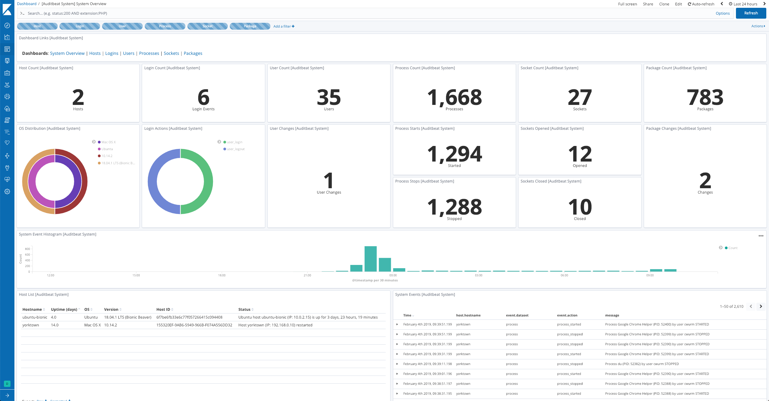

Example dashboard
editThe module comes with a sample dashboard:
