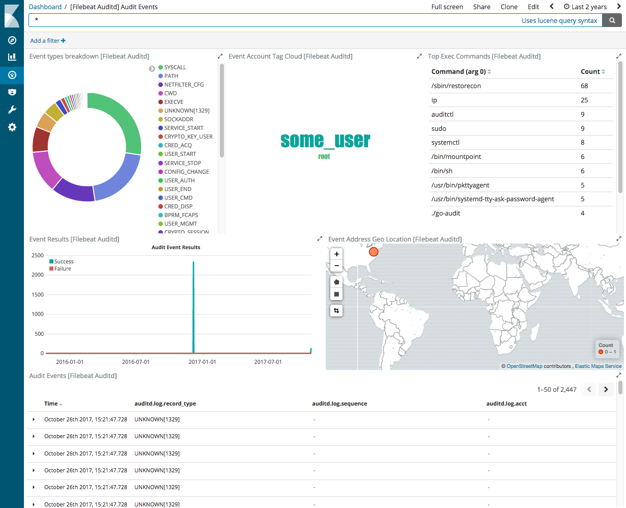

Example dashboard
This module comes with a sample dashboard showing an overview of the audit log data. You can build more specific dashboards that are tailored to the audit rules that you use on your systems.
kibana audit auditd
