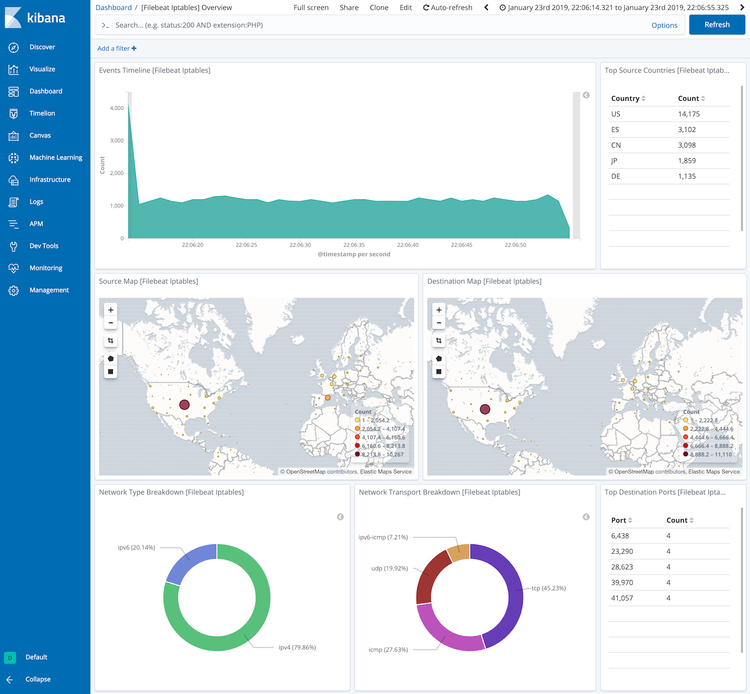

Example dashboard
editThis module comes with sample dashboards showing geolocation and network protocols used. One for all iptables logs:

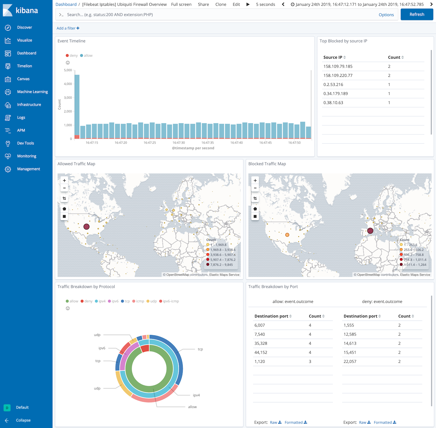

and one specific for Ubiquiti Firewall logs:
