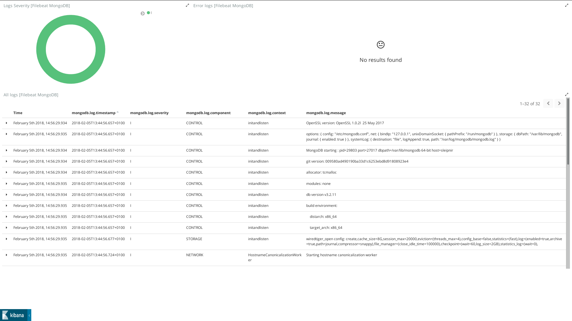

editThis module comes with one sample dashboard including error and regular logs.
