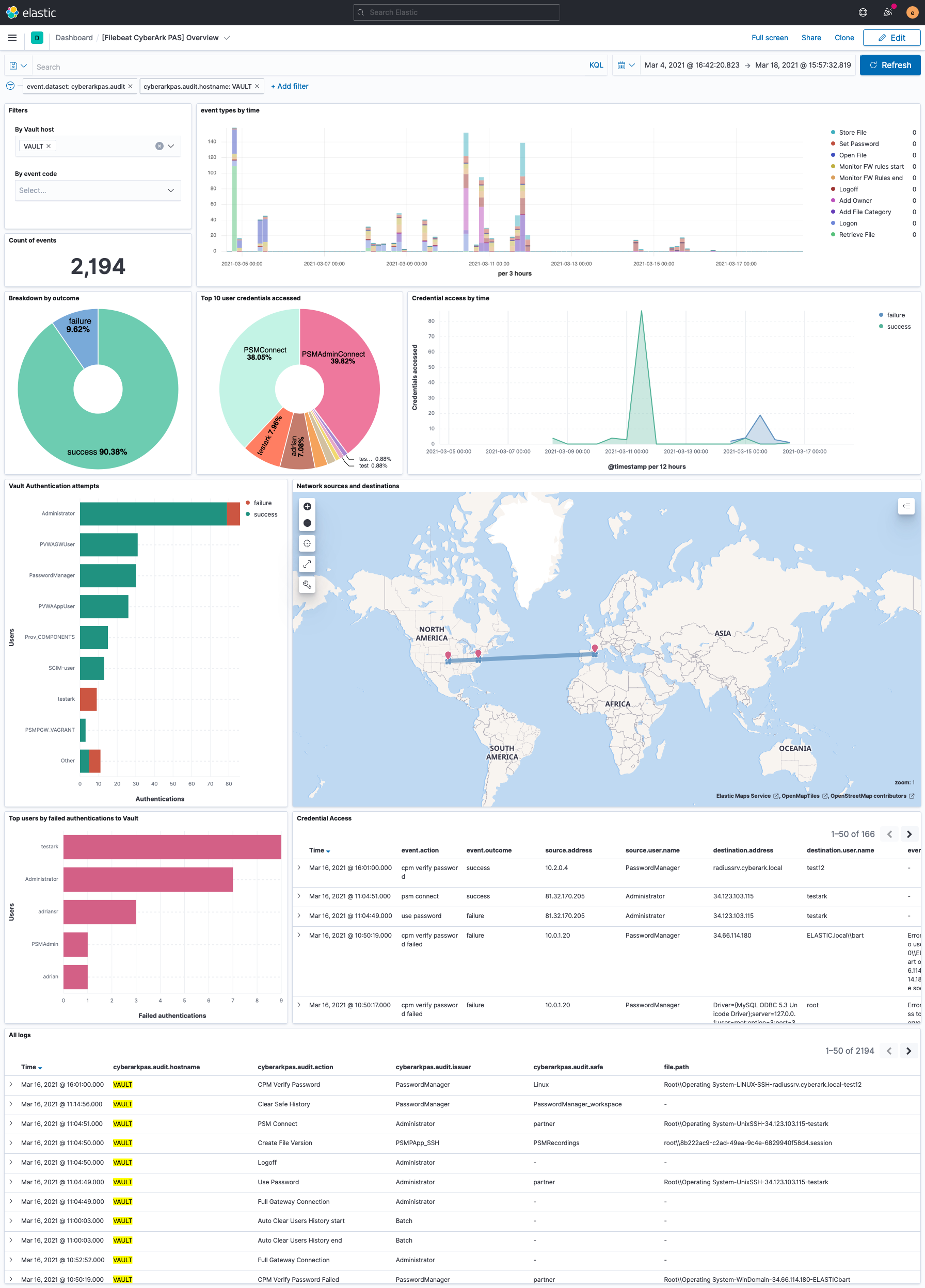

Example dashboard
This module comes with a sample dashboard:
filebeat cyberarkpas overview
