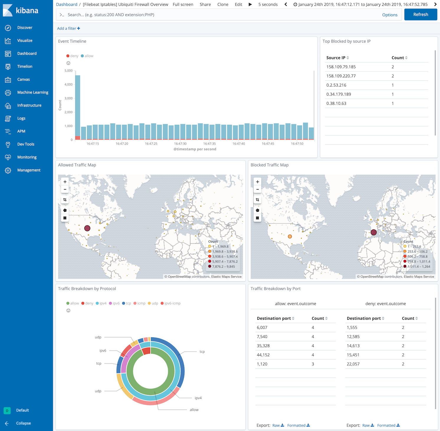

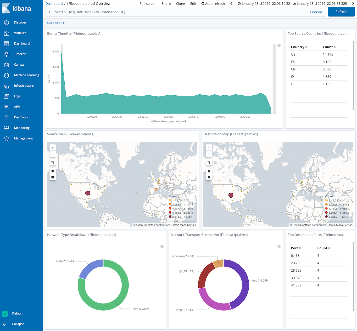

This module comes with sample dashboards showing geolocation and network protocols used. One for all iptables logs:
kibana iptables
and one specific for Ubiquiti Firewall logs:
kibana iptables ubiquiti
