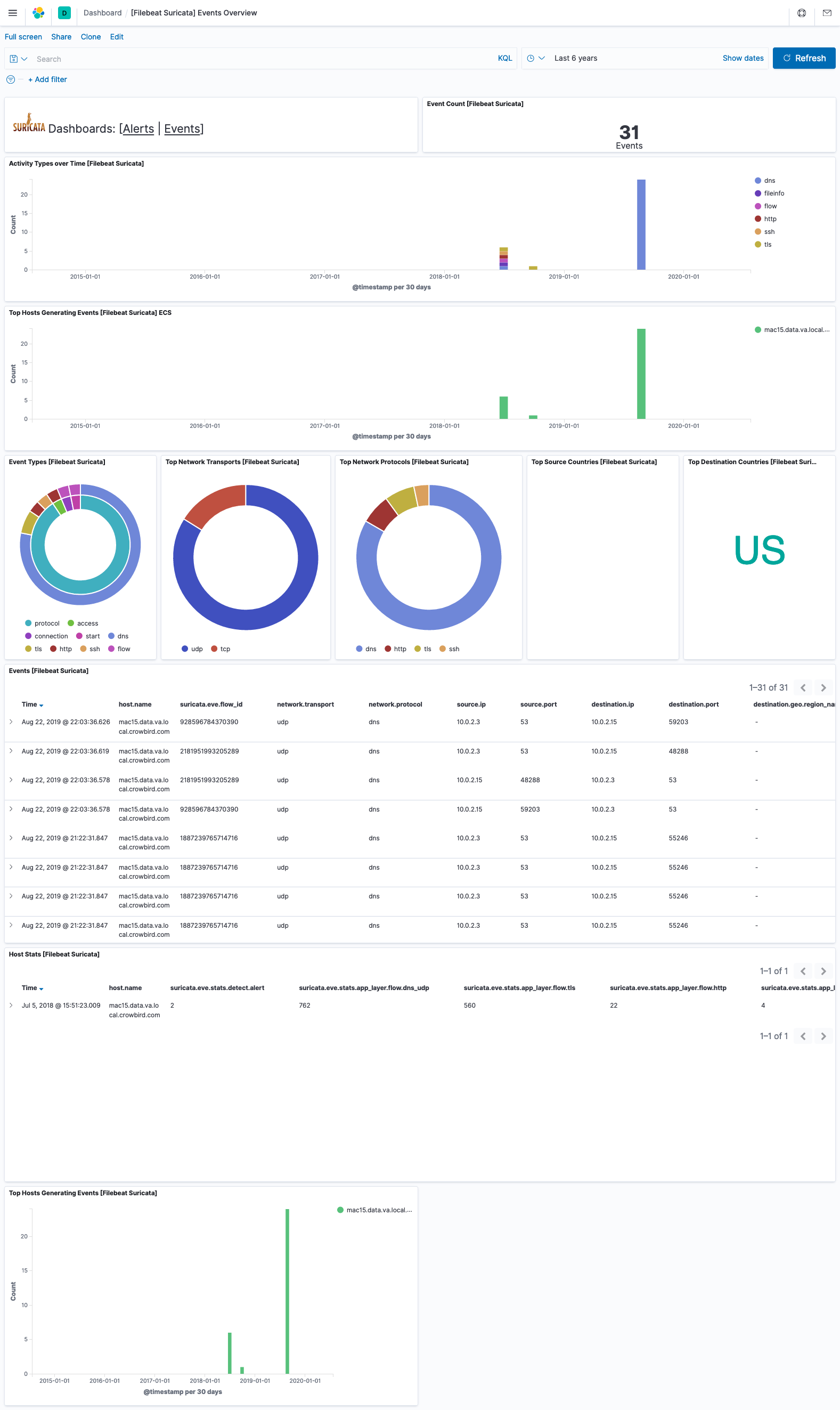

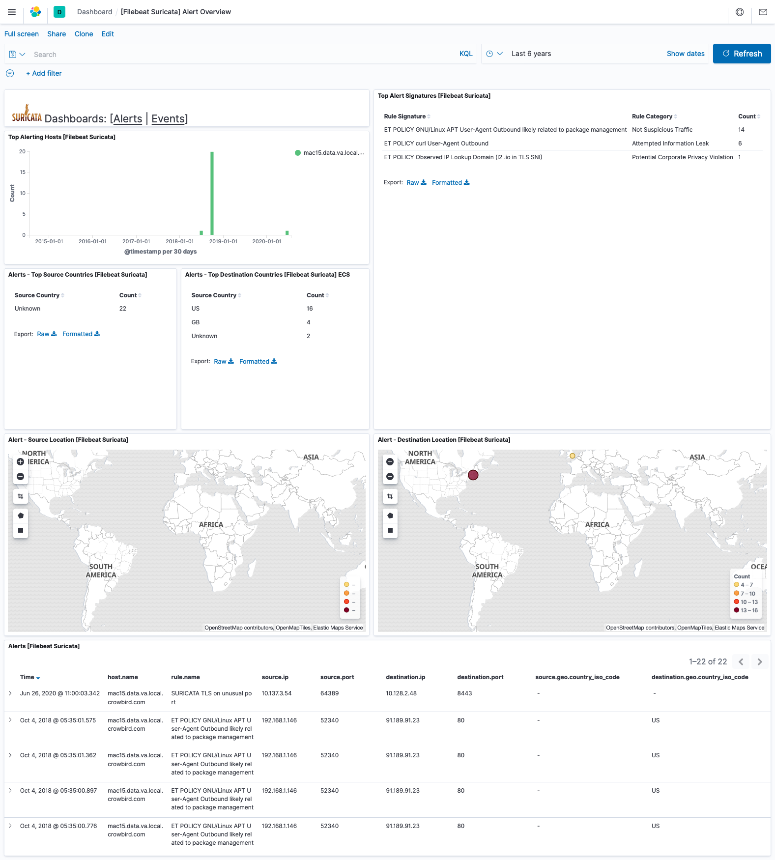

Example dashboard
This module comes with sample dashboards. For example:
filebeat suricata events
filebeat suricata alerts
