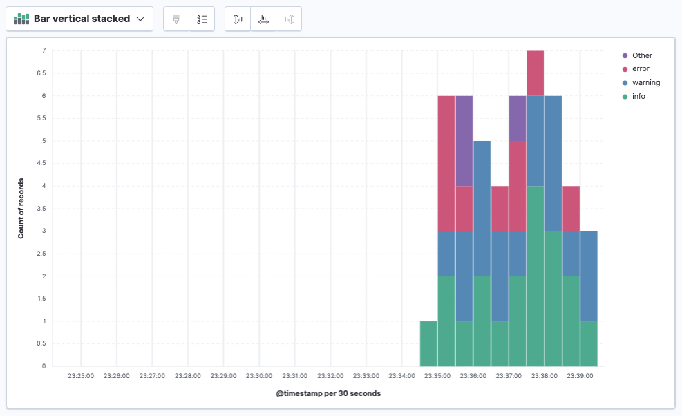

- Open the Kibana main menu and click Dashboard and then Create dashboard.
- Click Create visualization. The Lens visualization editor opens.
- In the index pattern dropdown box, select filebeat-, if it isn’t already selected.
- In the CHART TYPE dropdown box, select Bar vertical stacked, if it isn’t already selected.
- Check that the time filter is set to Last 15 minutes.
- From the Available fields list, drag and drop the @timestamp field onto the visualization builder.
- Drag and drop the log.level field onto the visualization builder.
- In the chart settings area, under Break down by, click Top values of log.level and set Number of values to 4. Since there are four log severity levels, this parameter sets all of them to appear in the chart legend.
Click Refresh. A stacked bar chart now shows the relative frequency of each of the four log severity levels over time.
- Click Save and return to add this visualization to your dashboard.

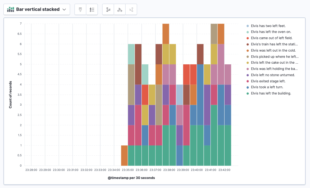

Let’s create a second visualization.
- Again, make sure that CHART TYPE is set to Bar vertical stacked.
- Drag and drop the http.request.body.content field onto the visualization builder.
- In the chart settings area, under Break down by, click Top values of http.request.body.content and set Number of values to 12. Since there are twelve different log messages, this parameter sets all of them to appear in the chart legend.
Click Refresh. A stacked bar chart now shows the relative frequency of each of the log messages over time.

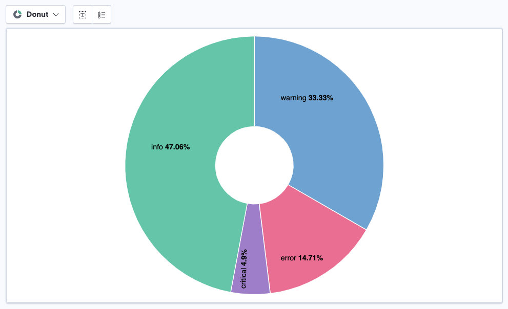

And now for the final visualization.
- In the CHART TYPE dropdown box, select Donut.
From the list of available fields, drag and drop the log.level field onto the visualization builder. A donut chart appears.

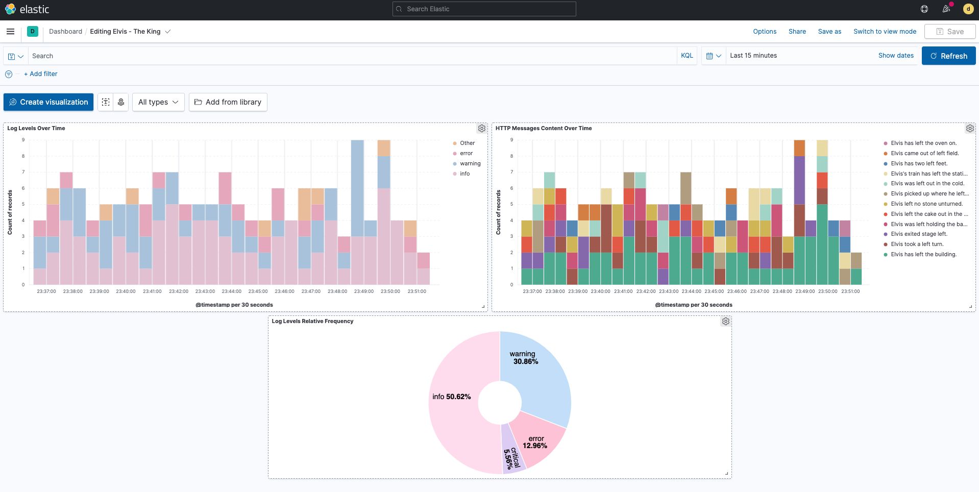

- Click Save and add a title to save your new dashboard.
You now have a Kibana dashboard with three visualizations: a stacked bar chart showing the frequency of each log severity level over time, another stacked bar chart showing the frequency of various message strings over time (from the added http.request.body.content parameter), and a donut chart showing the relative frequency of each log severity type.
You can add titles to the visualizations, resize and position them as you like, and then save your changes.
