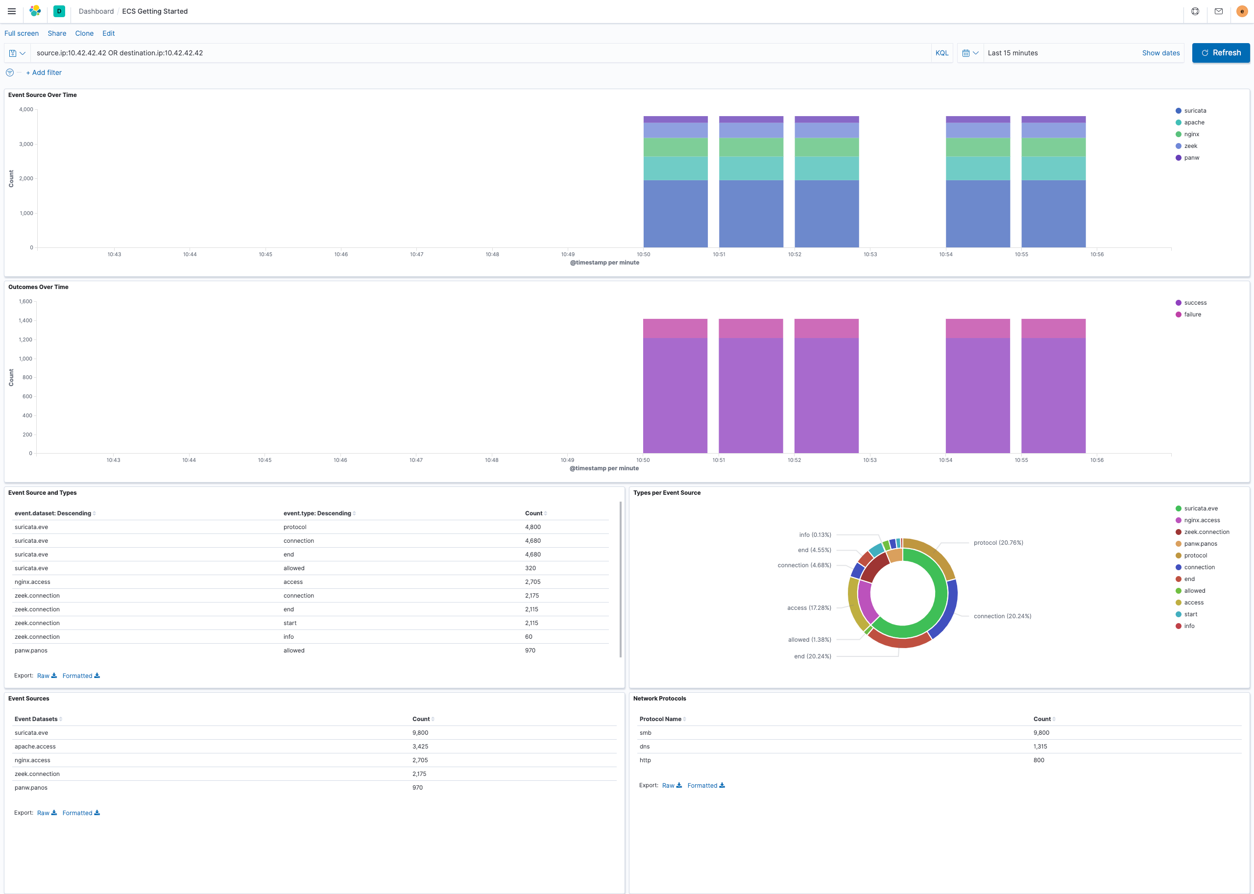

Unified Visualizations
With normalized data from different data sources, building insightful visualizations across sources is simple. From a single, centralized dashboard, events from web servers, IDS/IPS devices, and firewalls can be aggregated and visualized, and enhanced with drill-downs, and pivoting for delving into deeper investigations. Centralized monitoring of diverse data sources is straightforward with normalized ECS data.
Simplify visualization using ECS
