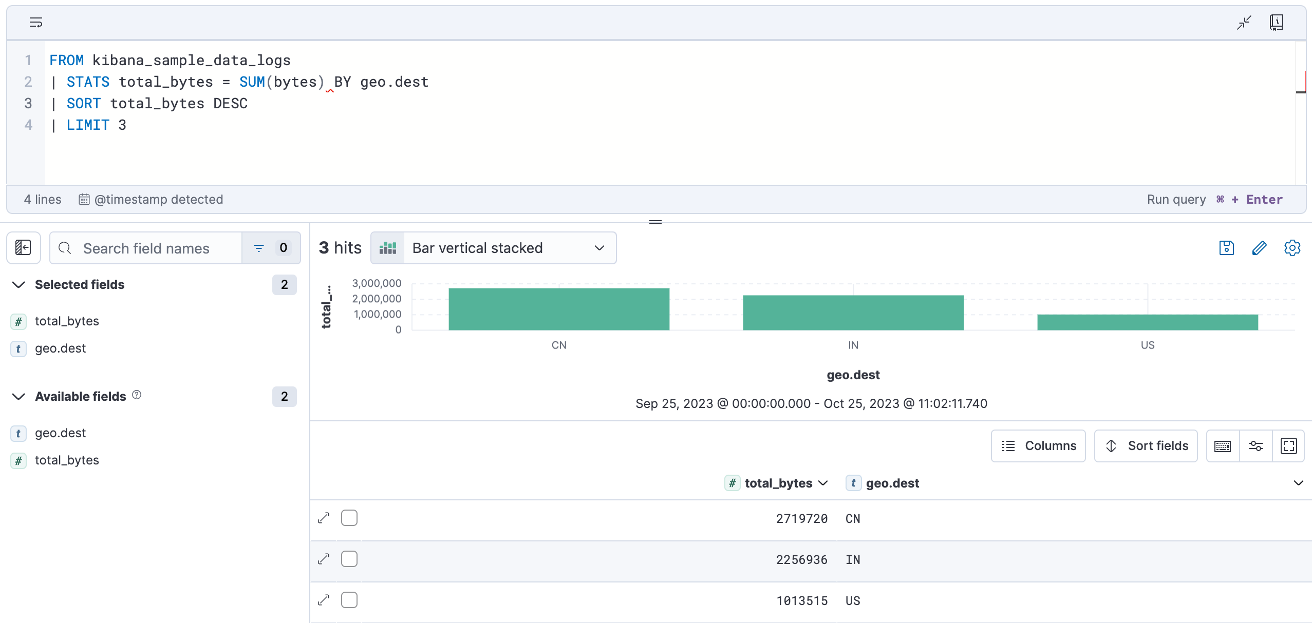

The visualization adapts to the query. A query’s nature determines the type of visualization. For example, this query aggregates the total number of bytes per destination country:
FROM kibana_sample_data_logs
| STATS total_bytes = SUM(bytes) BY geo.dest
| SORT total_bytes DESC
| LIMIT 3
The resulting visualization is a bar chart showing the top 3 countries:
esql kibana bar chart

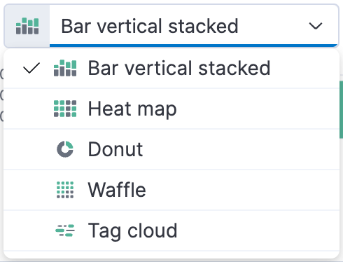

To change the visualization into another type, click the visualization type dropdown:
esql kibana visualization type

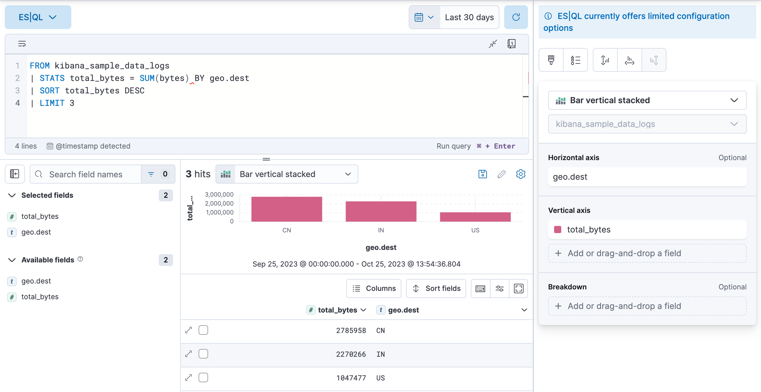

To make other changes to the visualization, like the axes and colors, click the pencil button (esql icon edit visualization). This opens an in-line editor:
esql kibana in line editor

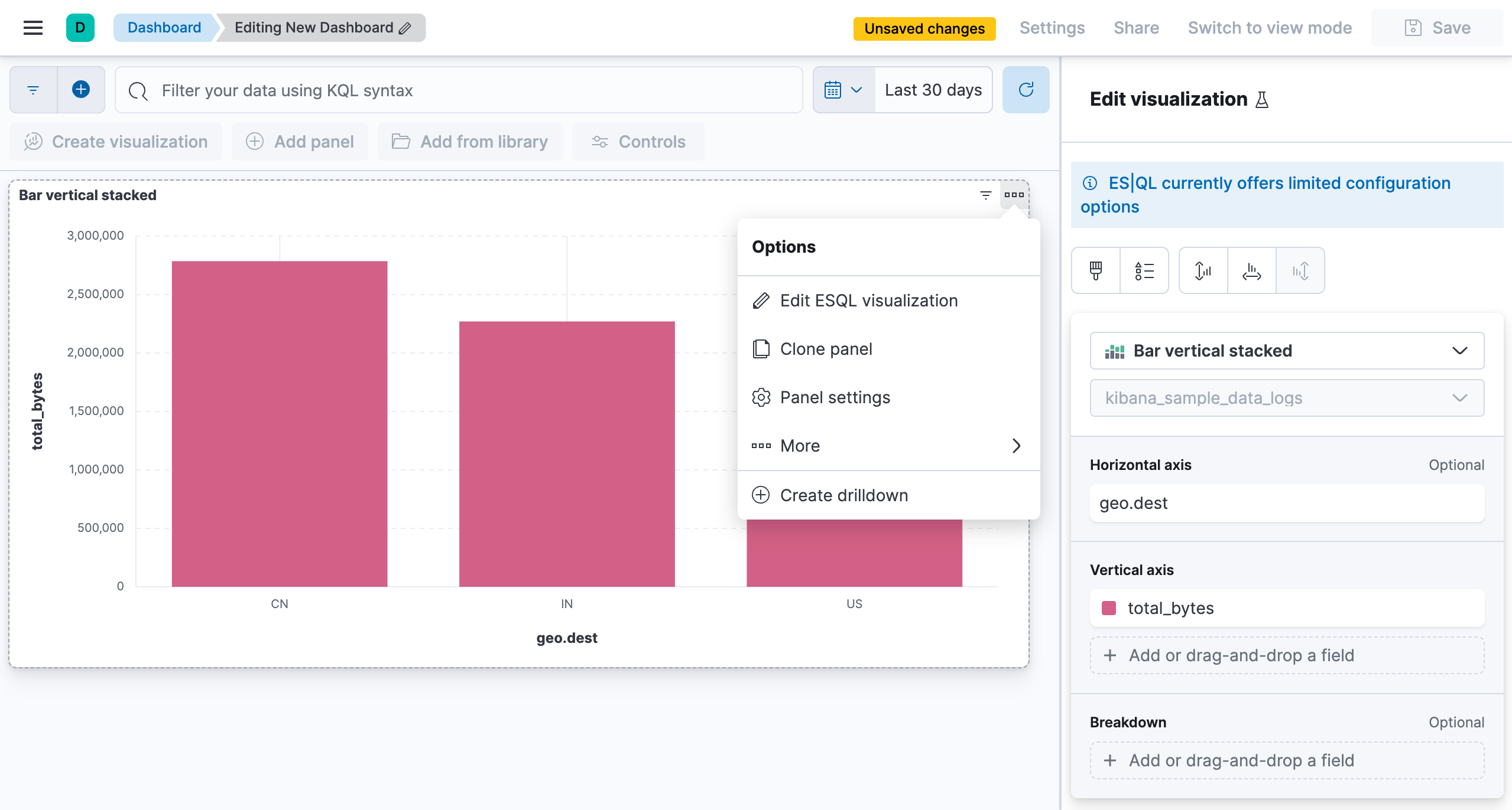

You can save the visualization to a new or existing dashboard by clicking the save button (esql icon save visualization). Once saved to a dashboard, you can continue to make changes to visualization. Click the options button in the top-right (esql icon options) and select Edit ESQL visualization to open the in-line editor:
esql kibana edit on dashboard

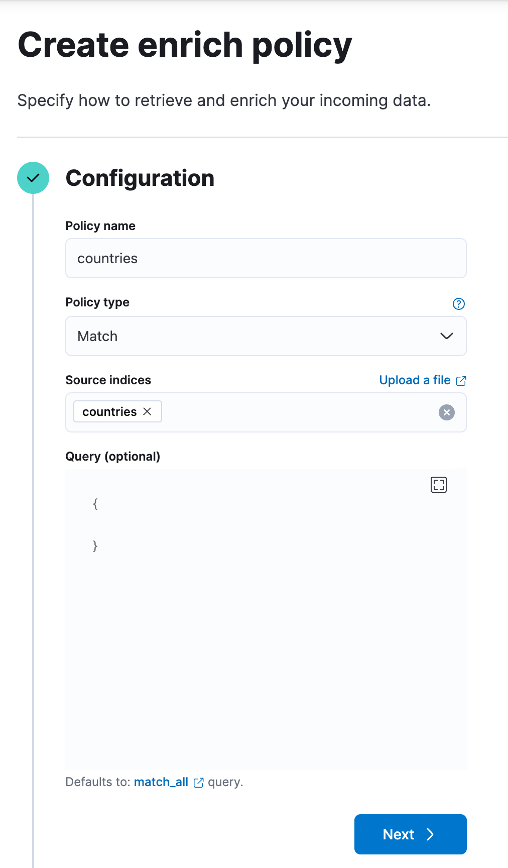

Create an enrich policy

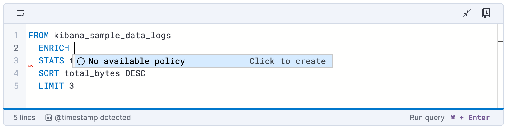

The ES|QL ENRICH command enables you to enrich your query dataset with fields from another dataset. Before you can use ENRICH, you need to create and execute an enrich policy. If a policy exists, it will be suggested by auto-complete. If not, click Click to create to create one.
esql kibana enrich autocomplete
Next, you can enter a policy name, the policy type, source indices, and optionally a query:
esql kibana enrich step 1

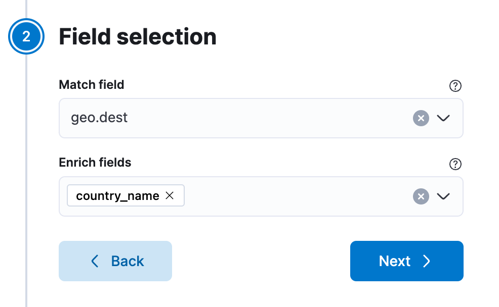

Click Next to select the match field and enrich fields:
esql kibana enrich step 2
Finally, click Create and execute.

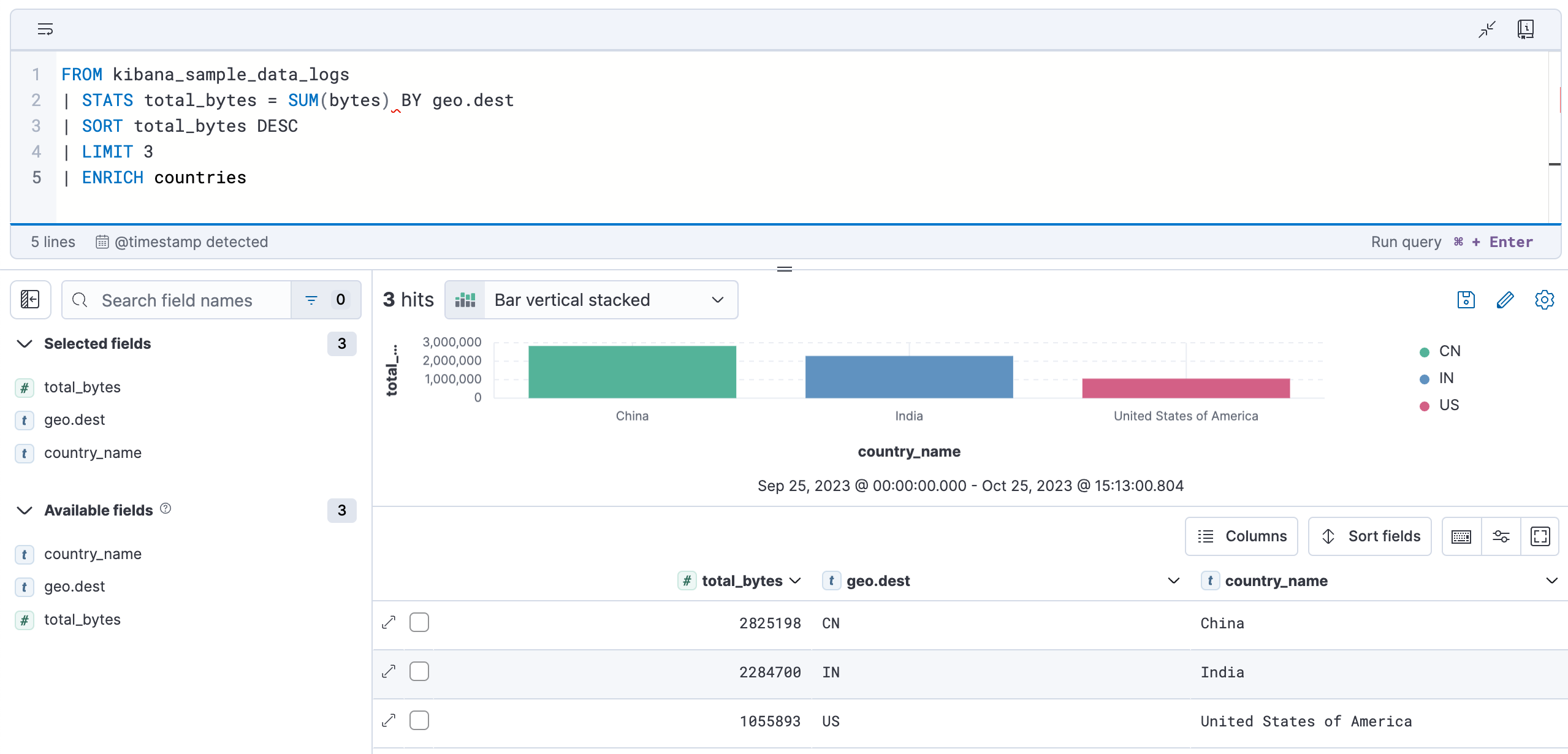

Now, you can use the enrich policy in an ES|QL query:
esql kibana enriched data

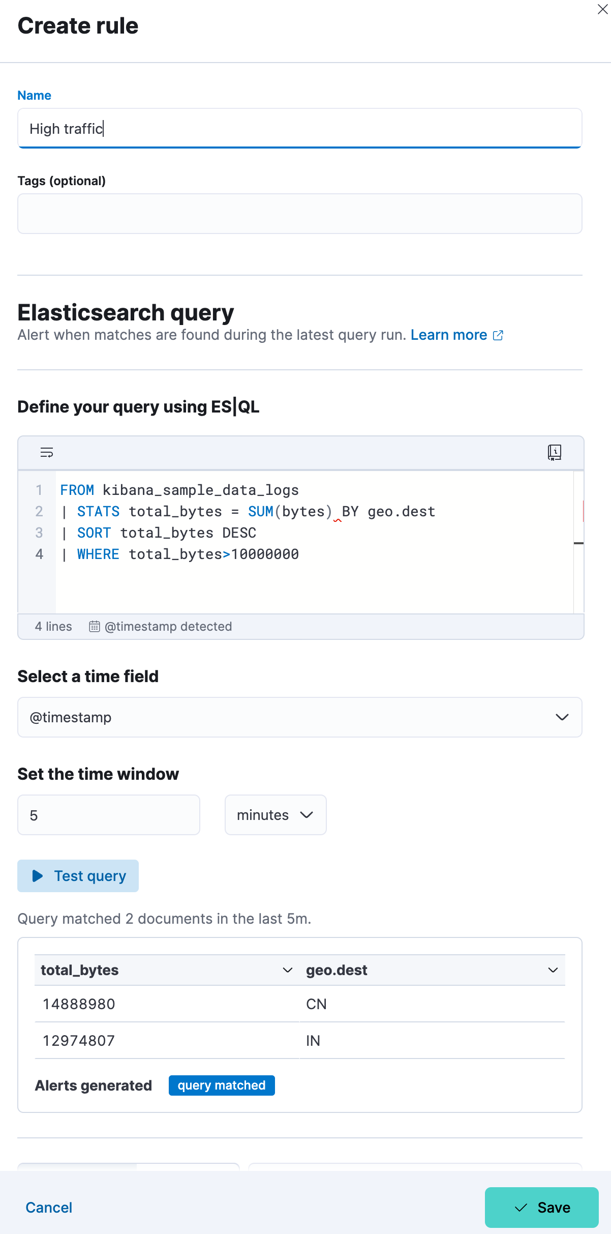

Create an alerting rule
You can use ES|QL queries to create alerts. From Discover, click Alerts and select Create search threshold rule. This opens a panel that enables you to create a rule using an ES|QL query. Next, you can test the query, add a connector, and save the rule.
