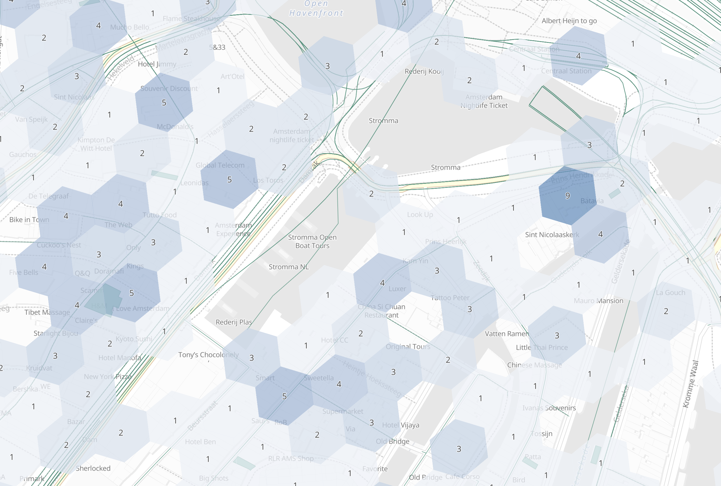

  • As is the case with geotile_grid, a single shape can be counted for in multiple tiles. A shape will contribute to the count of matching values if any part of its shape intersects with that tile. Below is an image that demonstrates this:
geoshape hexgrid
