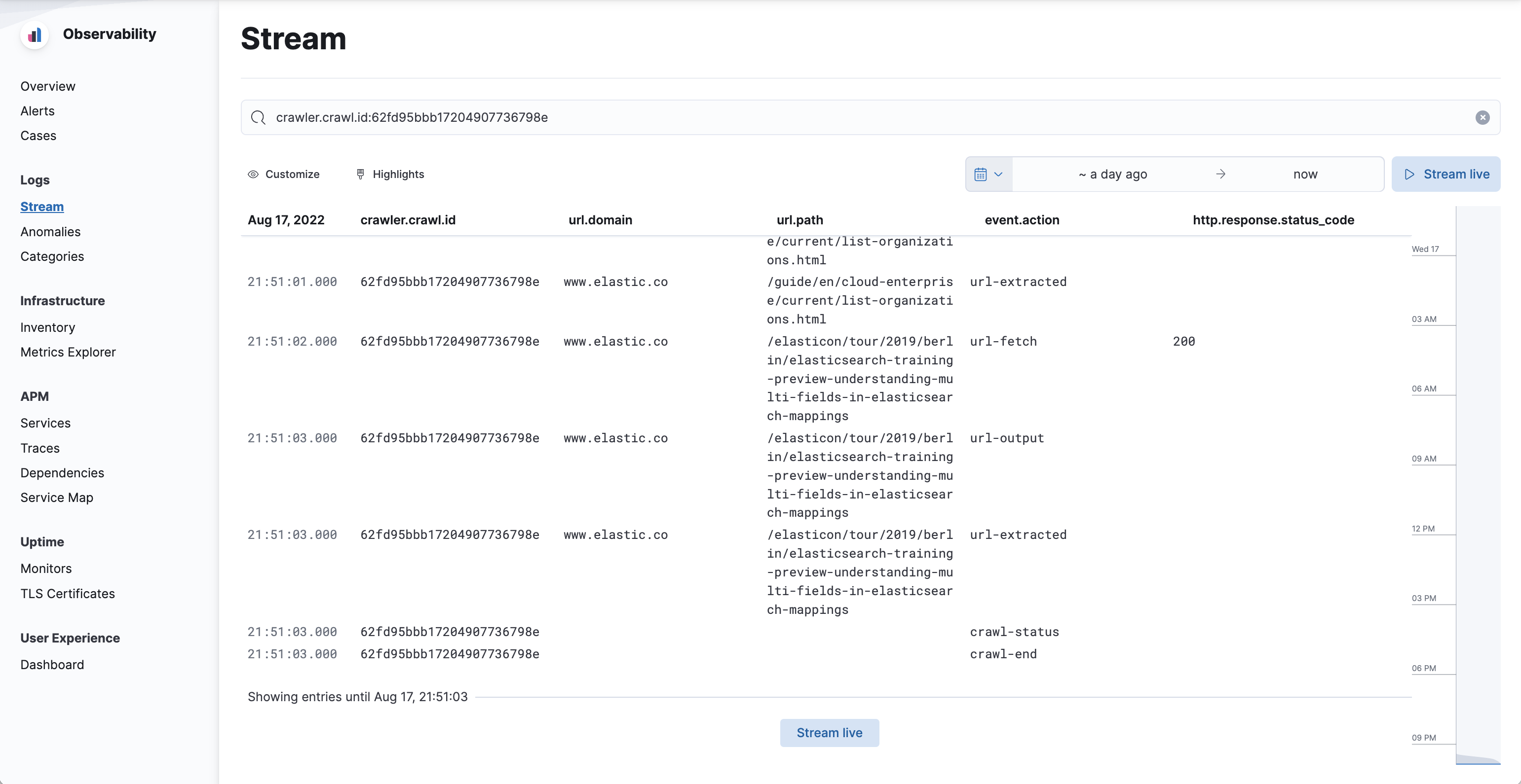

Analyze web crawler events logs for the most recent crawl:
First:
  1. Find the crawl request ID for the most recent crawl. In the Kibana UI, find this under Recent crawl requests.
  2. Filter the web crawler events logs by that ID. See View web crawler events logs to learn how to view these logs in Kibana.
A picture of the crawler events logs viewer, filtering by a crawl request ID.
Figure 4. Crawler events logs viewer
Then:
  • Order the events by timestamp, oldest first. If using the Observability Logs stream, scroll to the end of the list.
  • Locate the crawl-end event and preceding events. These events communicate what happened before the crawl failed.

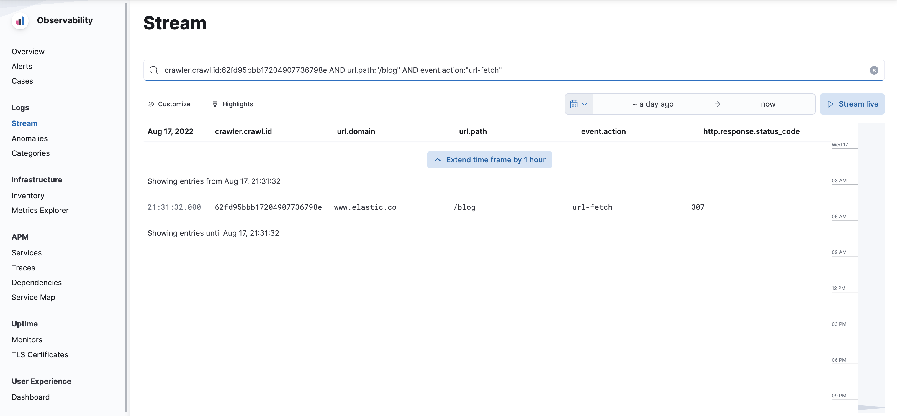

See View web crawler events logs to learn how to view crawler events logs in Kibana.
First:
  3. Find the URL of a specific document missing from the engine.
  4. Filter the web crawler events logs by that URL.
Then:
  • Locate url-discover events to confirm the crawler has seen links to your page. The outcome and message fields may explain why the web crawler did not crawl the page.
  • If url-discover events indicate discovery was successful, locate url-fetch events to analyze the fetching phase of the crawl.
A picture of the events logs viewer, filtering by a crawl request ID, URL, and url-fetch event.
Figure 5. Crawler events logs viewer
