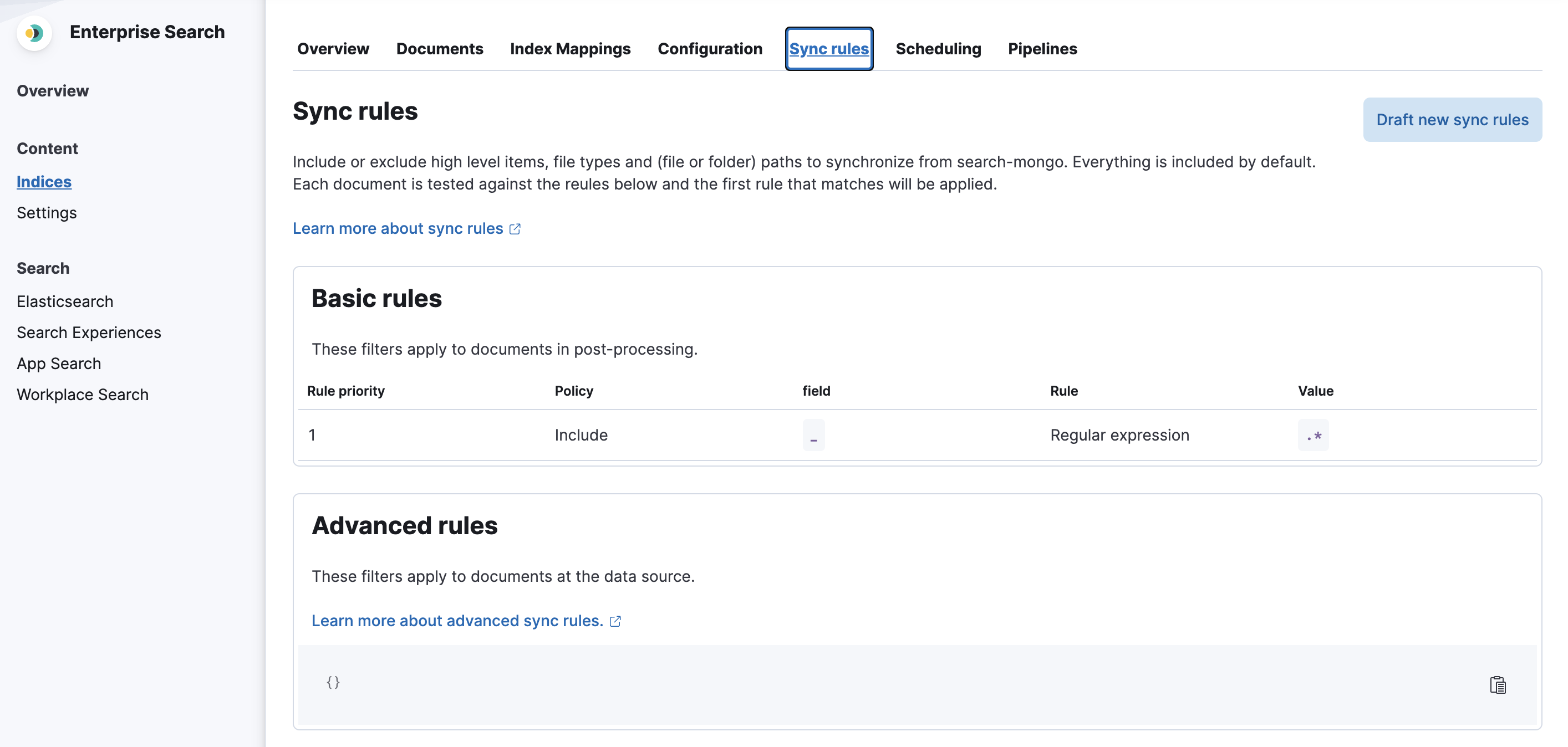

Use connector sync rules to help control which documents are synced between the third-party data source and Elasticsearch. Define sync rules in the Kibana UI for each connector index, under the Sync rules tab for the index.
Sync rules apply to native connectors and connector clients.

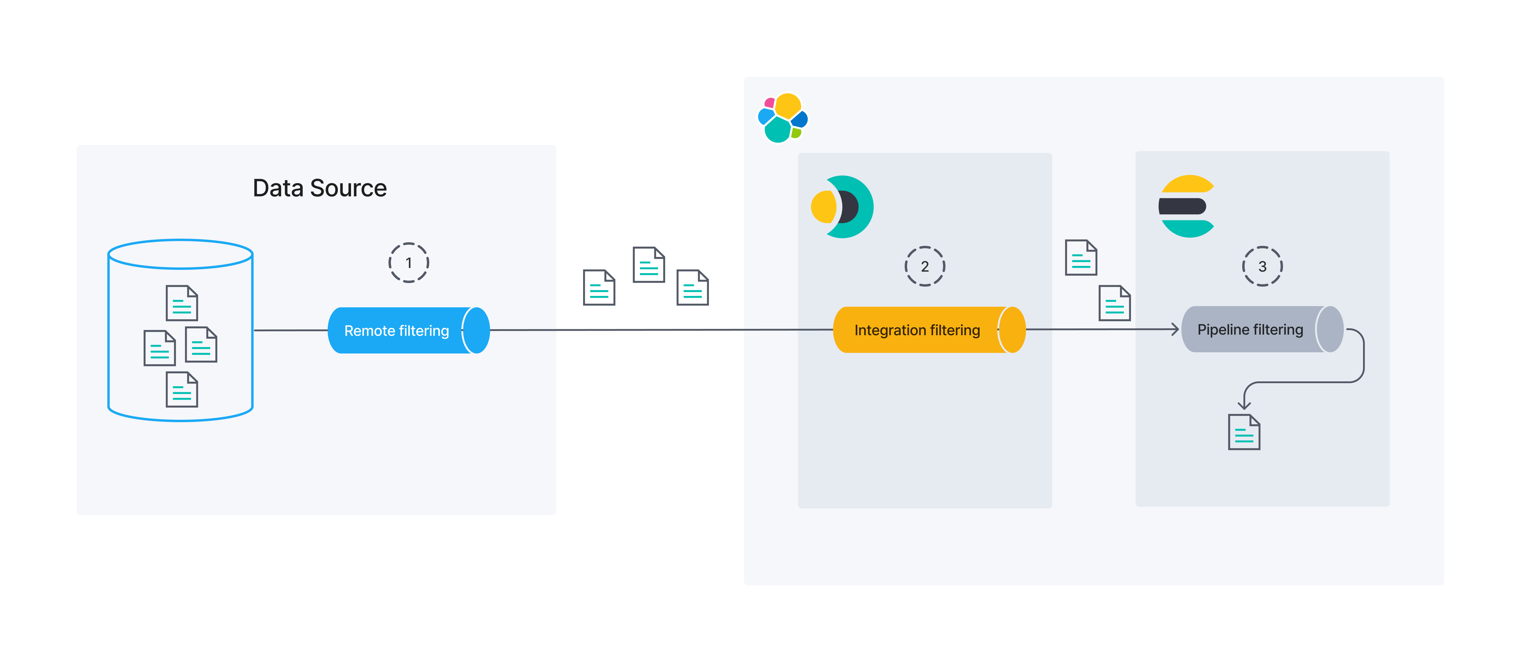

General data filtering concepts
Before discussing sync rules, it’s important to establish a basic understanding of data filtering concepts. The following diagram shows that data filtering can occur in several different processes/locations.
Filtering
In this documentation we will focus on remote and integration filtering. Sync rules can be used to modify both of these.
Remote filtering
Data might be filtered at its source. We call this remote filtering, as the filtering process is external to Elastic.
Integration filtering
Integration filtering acts as a bridge between the original data source and Elasticsearch. Filtering that takes place in connectors is an example of integration filtering.
Pipeline filtering
Finally, Elasticsearch can filter data right before persistence using ingest pipelines. We will not focus on ingest pipeline filtering in this guide.

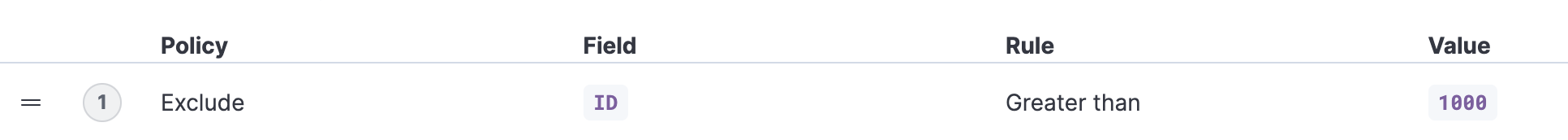

Example 1
Exclude all documents that have an ID field with the value greater than 1000.
Simple greater than rule

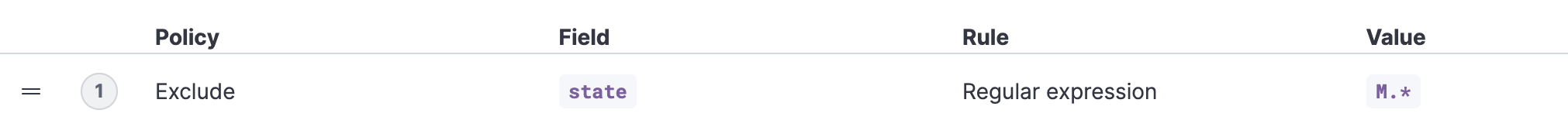

Example 2
Exclude all documents that have a state field that matches a specified regex.
Simple regex rule

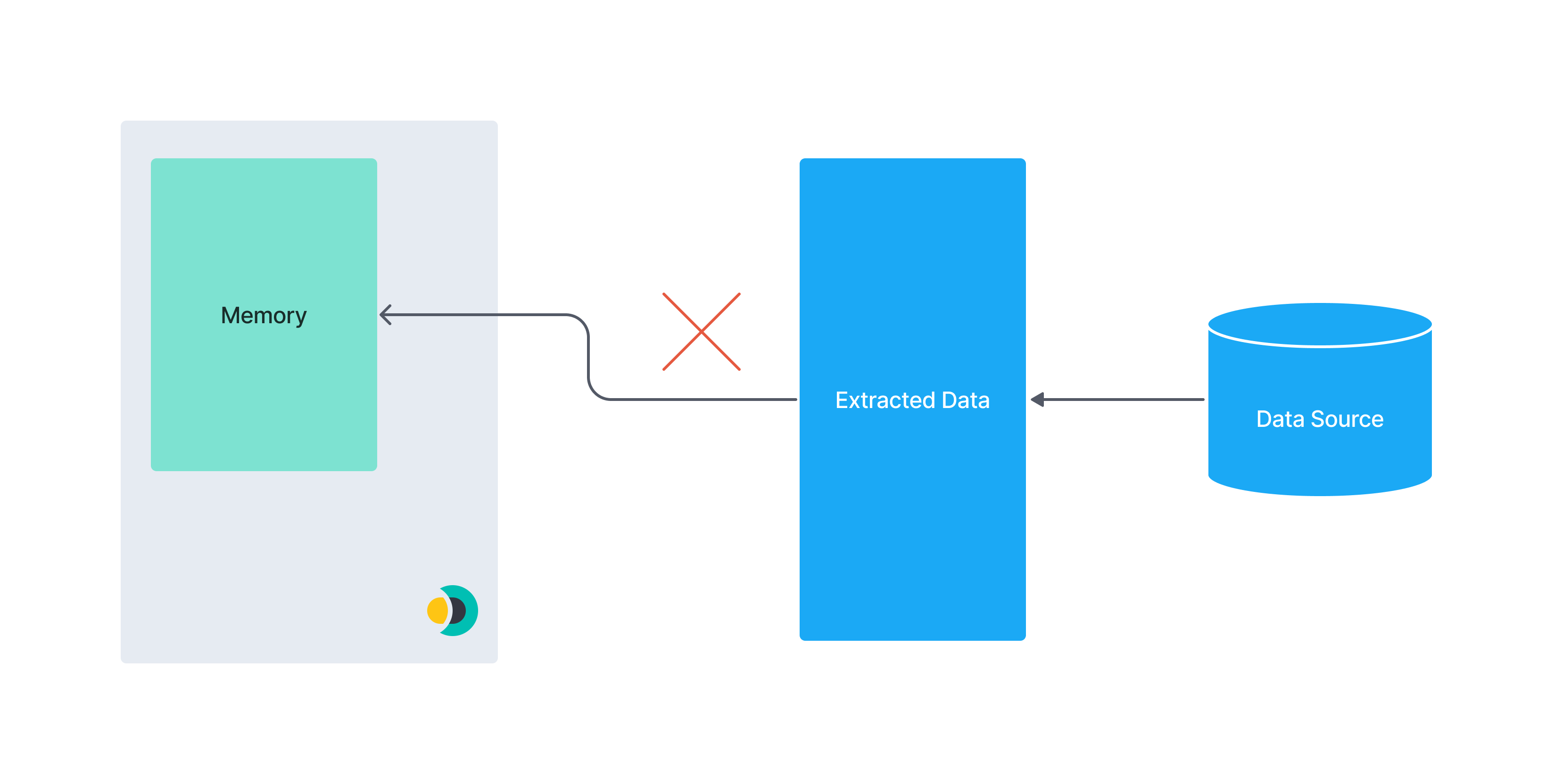

  • If you’re relying solely on basic sync rules in the integration filtering phase the connector will fetch all the data from the data source
  • For data sources without automatic pagination, or similar optimizations, fetching all the data can lead to memory issues. For example, loading datasets which are too big to fit in memory at once.
The native MongoDB connector provided by Elastic uses pagination and therefore has optimized performance. Keep in mind that custom community-built connector clients may not have these performance optimizations.

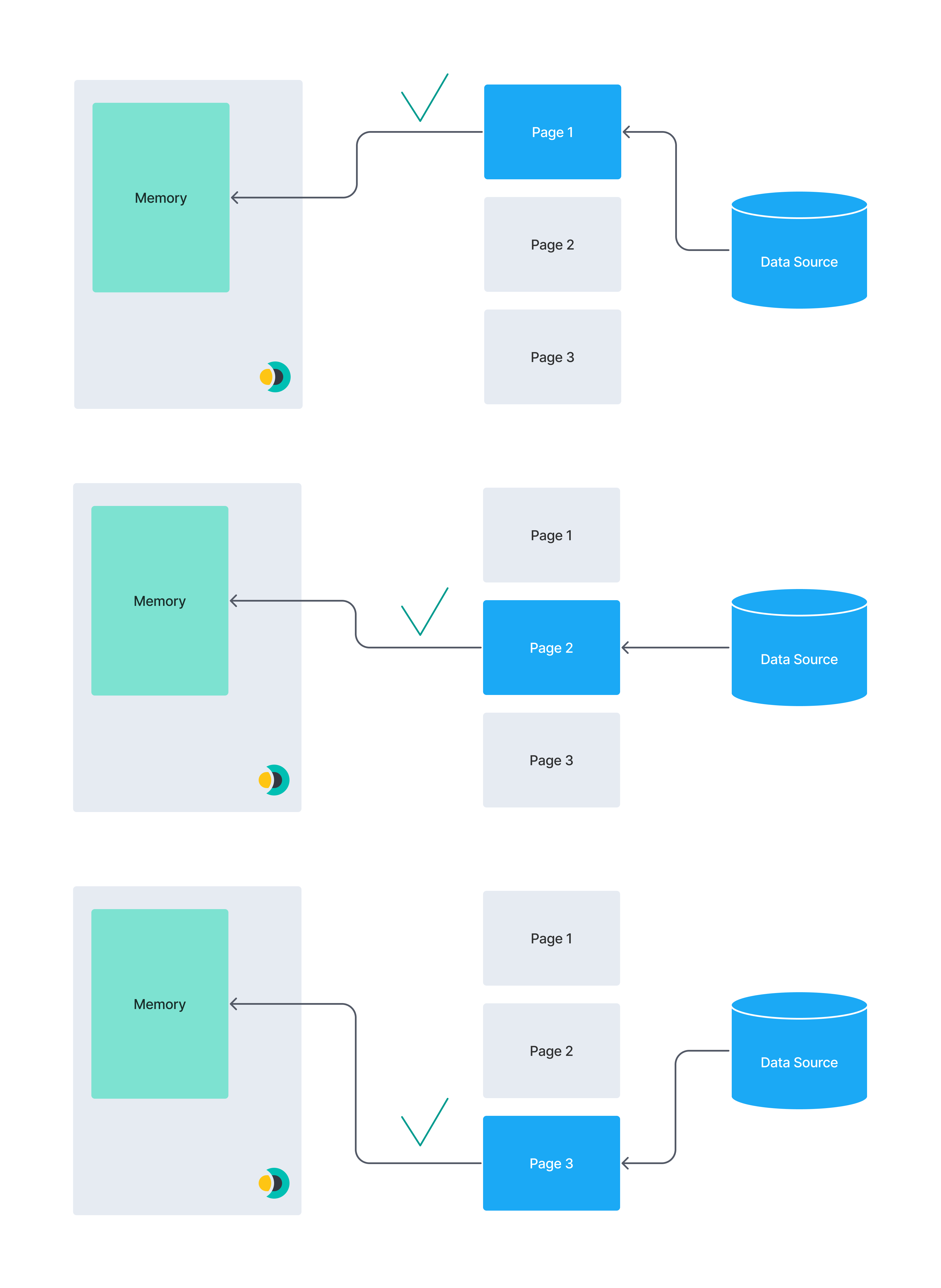

The following diagrams illustrate the concept of pagination. A huge data set may not fit into a connector instance’s memory. Splitting data into smaller chunks reduces the risk of out-of-memory errors.
This diagram illustrates an entire dataset being extracted at once:
Extract whole dataset at once
By comparison, this diagram illustrates a paginated dataset:
Pagination

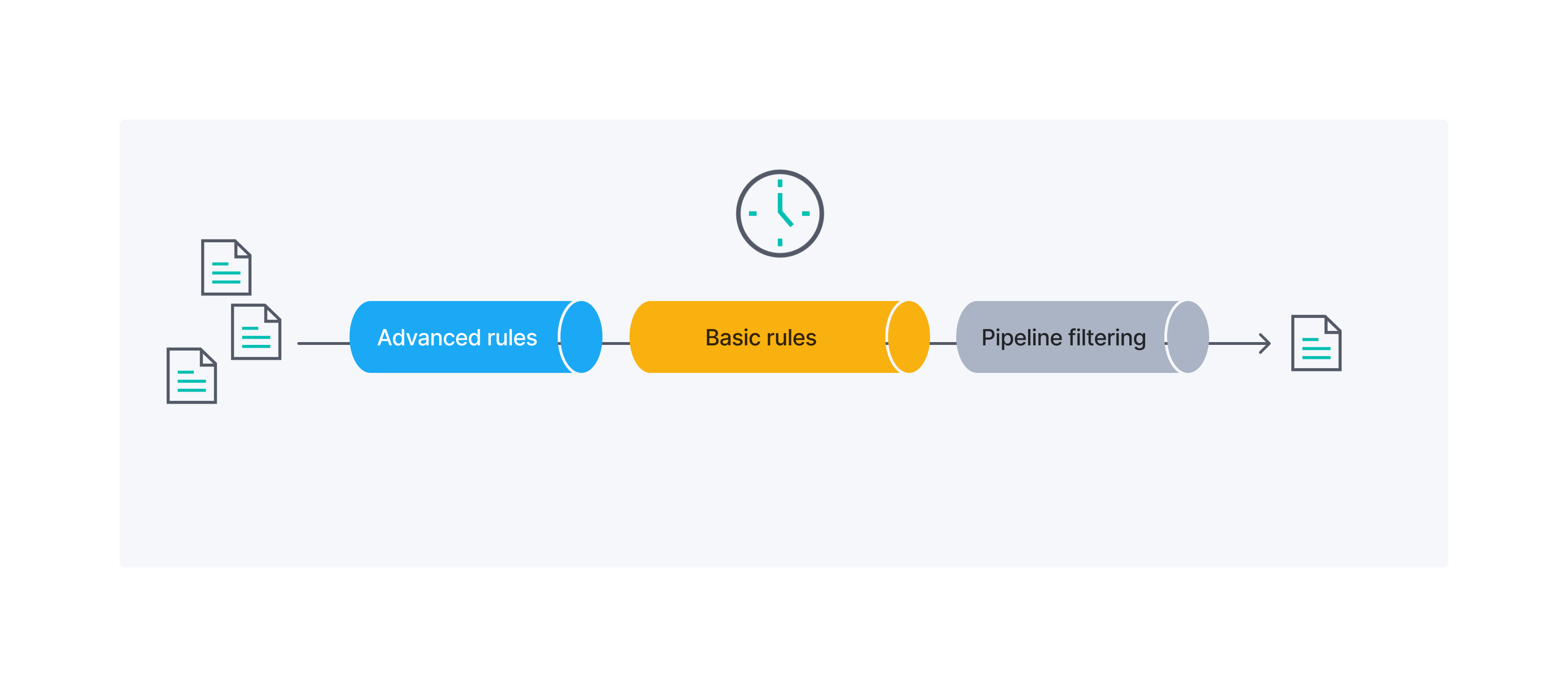

Combining basic and advanced sync rules
You can also use basic sync rules and advanced sync rules together to filter a data set.
The following diagram provides an overview of the order in which advanced sync rules, basic sync rules, and pipeline filtering, are applied to your documents:
Sync Rules: What is applied when?

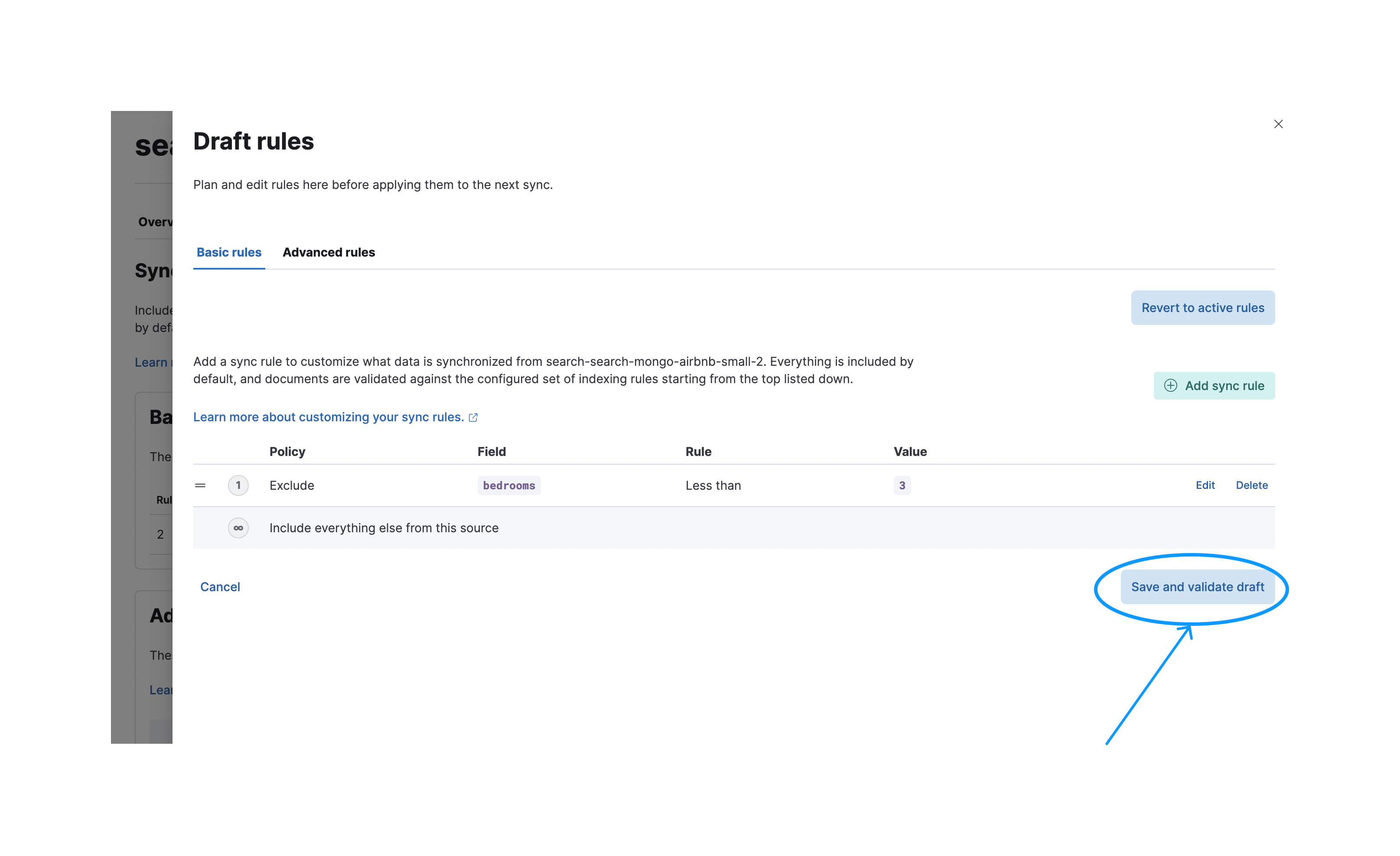

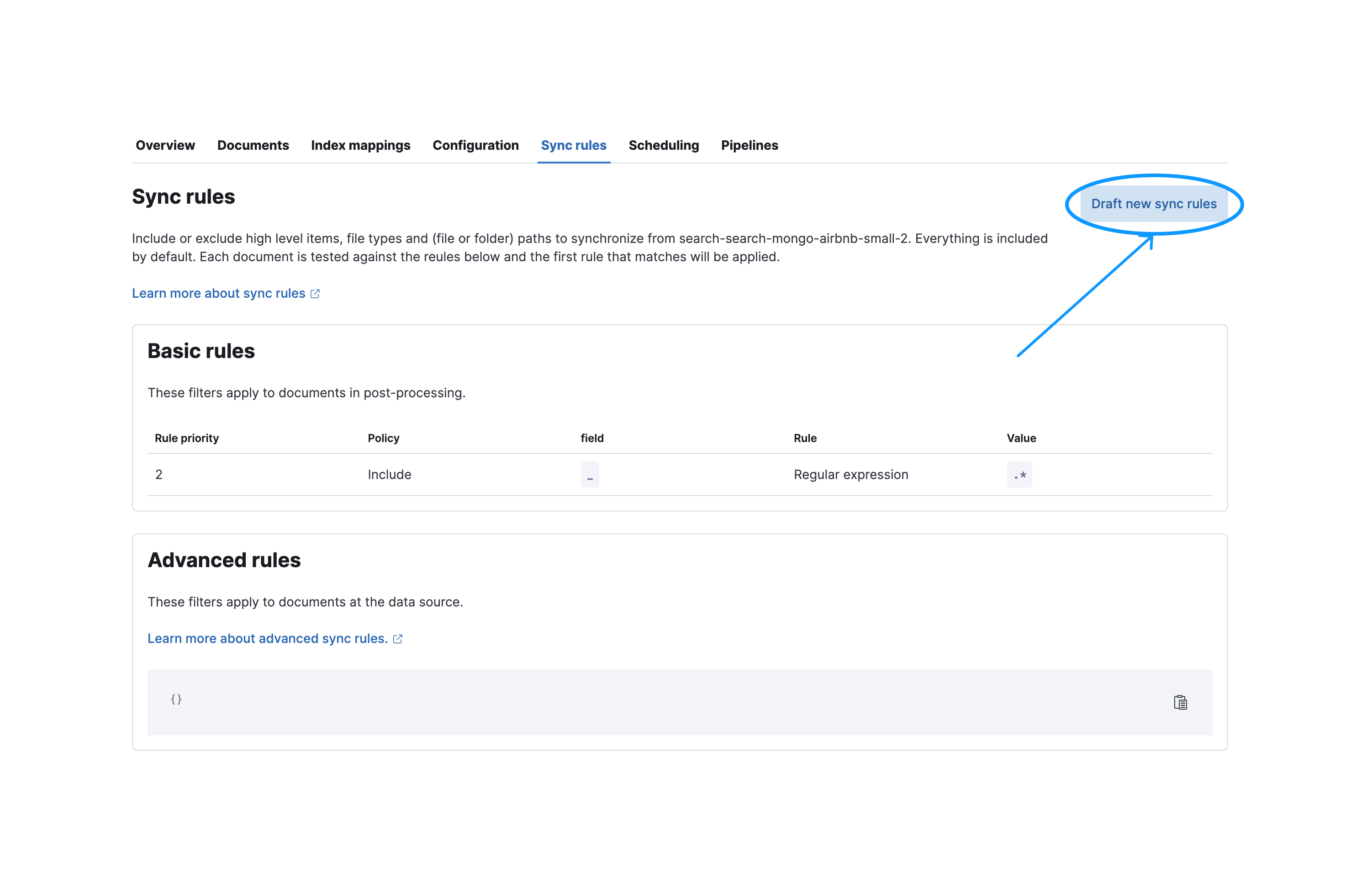

To create a new basic sync rule, navigate to the Sync Rules tab and select Draft new sync rules:
Draft new rules
Afterwards you need to press the Save and validate draft button to validate these rules. Note that when saved the rules will be in draft state. They won’t be executed in the next sync unless they are applied.
After a successful validation you can apply your rules so they’ll be executed in the next sync.

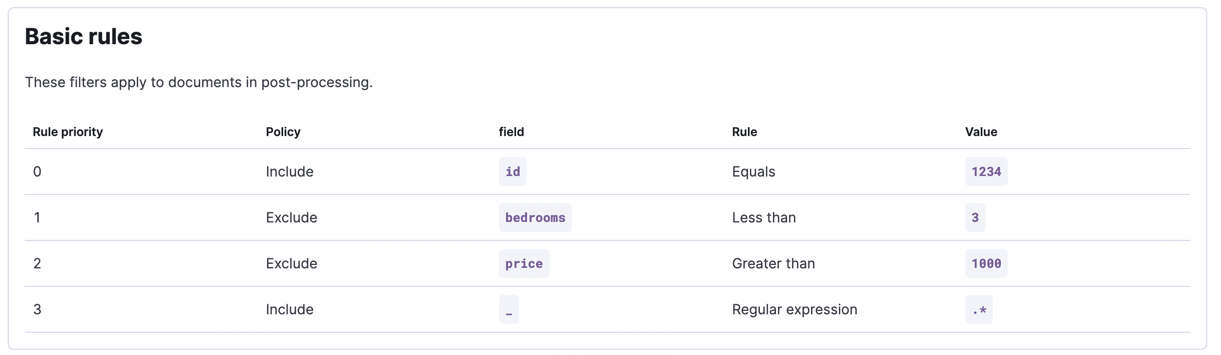

These following conditions can be covered by basic sync rules:
  1. The apartment with id 1234 should get included without considering the first two conditions
  2. Every apartment should have at least three bedrooms
  3. The apartments should not be more expensive than 1000/month
Remember that order matters for basic sync rules. You may get different results for a different ordering.

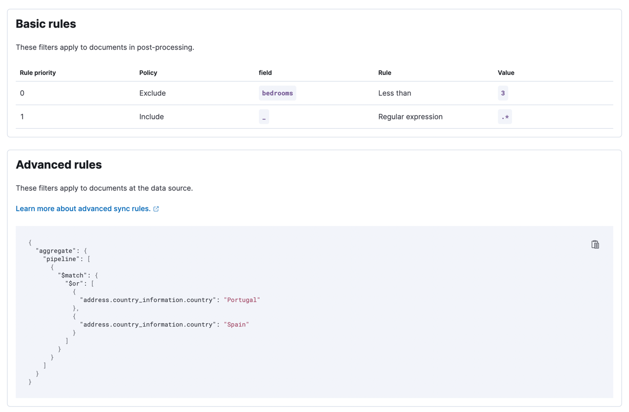

Advanced sync rules example

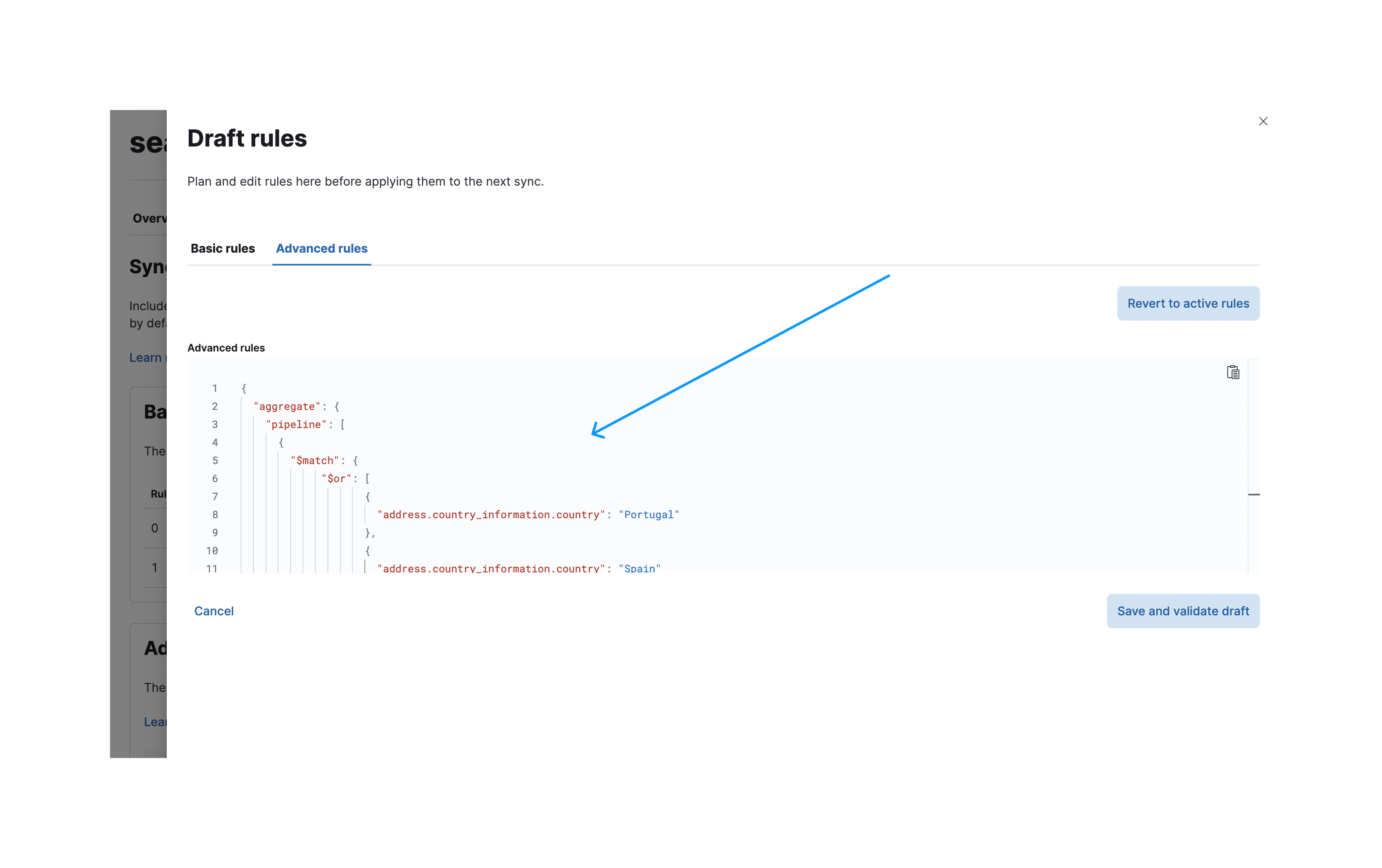

You want to only include apartments which are located in Portugal or Spain. We need to use advanced sync rules here, because we’re dealing with deeply nested objects.
Let’s assume that the apartment data is stored inside a MongoDB instance. For MongoDB we support aggregation pipelines in our advanced sync rules among other things. An aggregation pipeline to only select properties located in Portugal or Spain looks like this:
        "$match": {
             "$or": [
                      "address.country_information.country": "Portugal"
                      "address.country_information.country": "Spain"
To create these advanced sync rules navigate to the sync rules creation dialog and select the Advanced rules tab. You can now paste your aggregation pipeline into the input field under aggregate.pipeline:
Paste aggregation pipeline
Once validated, apply these rules. The following screenshot shows the applied sync rules, which will be executed in the next sync:
Advanced sync rules appeared

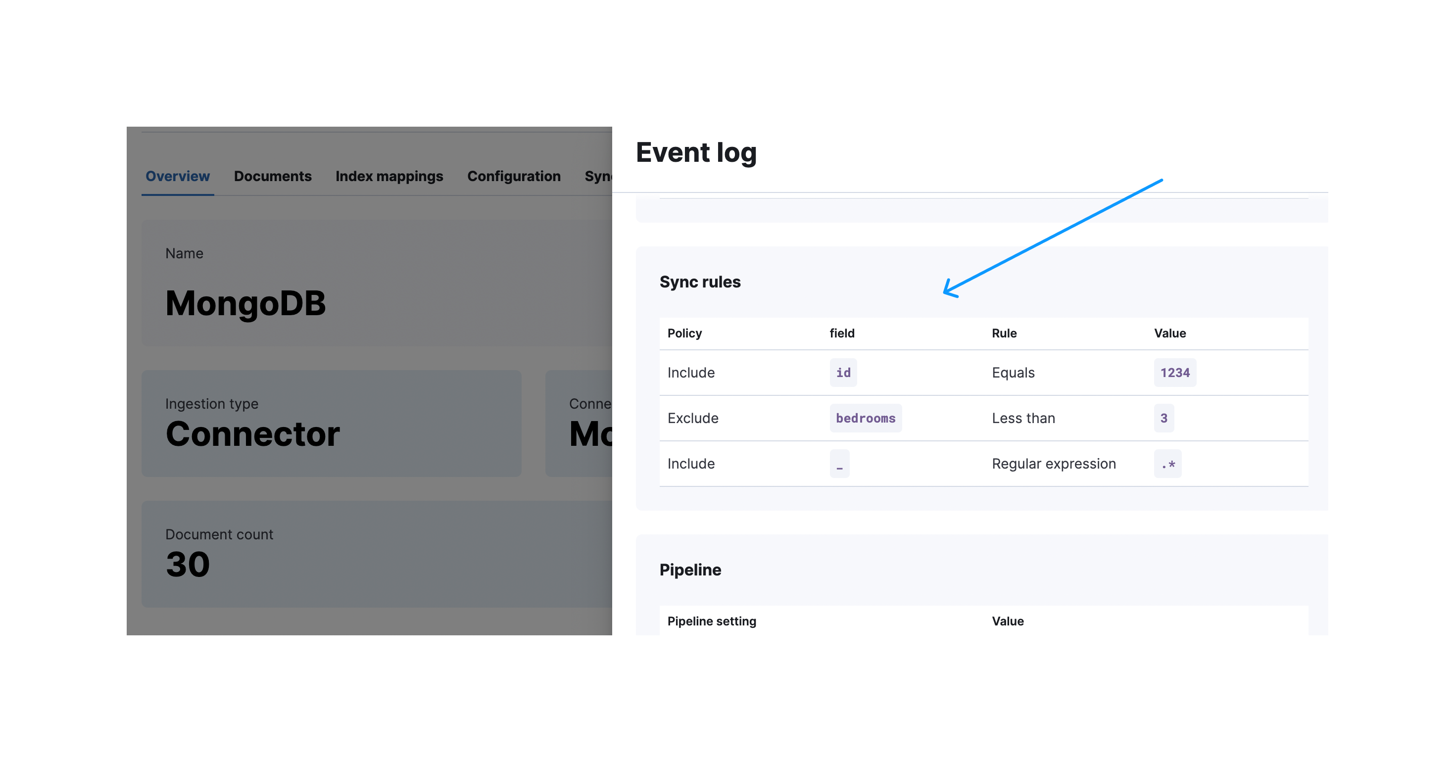

After a successful sync you can expand the sync details to see which rules were applied:
Applied rules during sync
