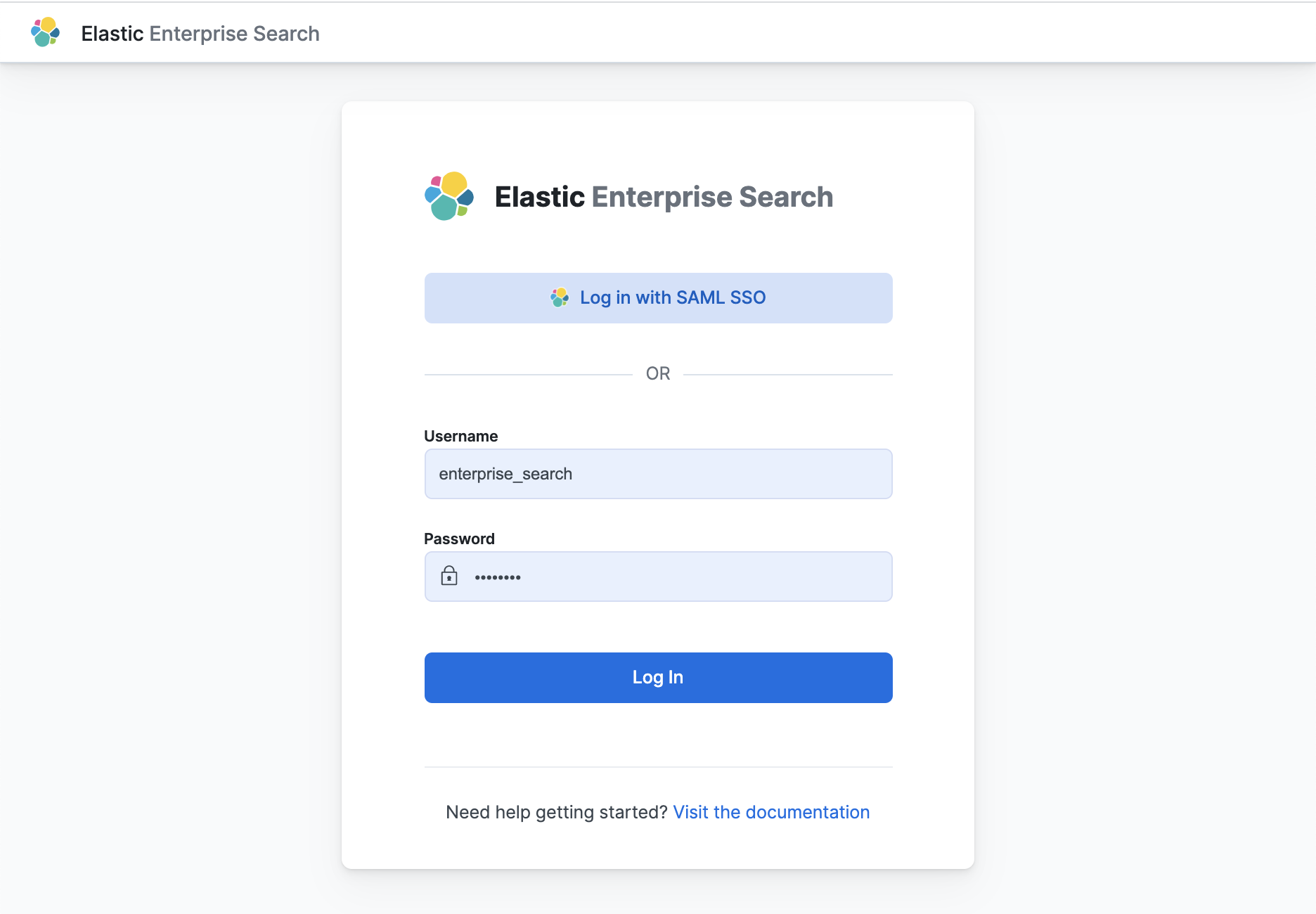

xpack.security.authc.providers: saml: saml1: order: 0 realm: saml1 basic: basic1: order: 1
Finally grant SAML users access to Kibana, using the API instructions on this page.
Save these settings, and wait for your cluster to restart. The next time you select Launch Enterprise Search, you’ll have the option to log in with Okta SSO.
