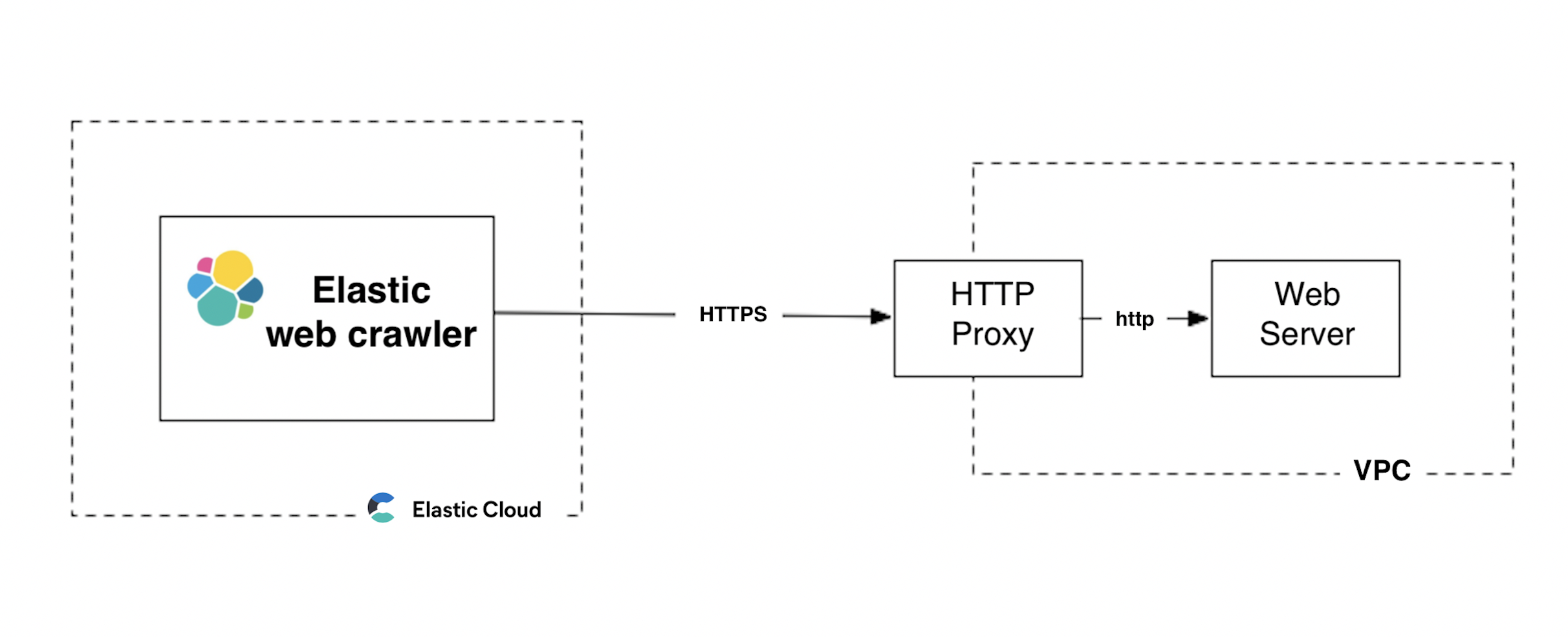

To demonstrate the authenticated proxy server functionality for the web crawler, we will use the infrastructure outlined in this schematic diagram:
crawler proxy schematic
This example includes all the components needed to understand the use case:
  • A VPC (virtual private network) deployed within Google Cloud
  • The VPC contains two cloud instances: web-server and proxy:
    • The web-server hosts a private website, that is only accessible from within the VPC, using a private domain name: http://marlin-docs.internal.
    • The proxy server has basic HTTP authentication set up with the username proxyuser and password proxypass. It is accessible from the public internet using the host name proxy.example.com and the port number 3128.
  • An Enterprise Search deployment running outside of the VPC, in Elastic Cloud.
    • This deployment has no access to the private network hosting our content.

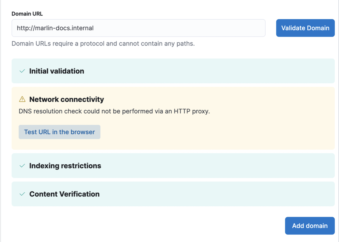

The validation process will look like the one in this image:
crawler proxy validation
The validation process for adding a domain to the web crawler configuration will skip a number of networking-related checks, since these do not work through a proxy. If you do not see the warning like in the above image, check your deployment configuration to ensure you have configured the proxy correctly.
