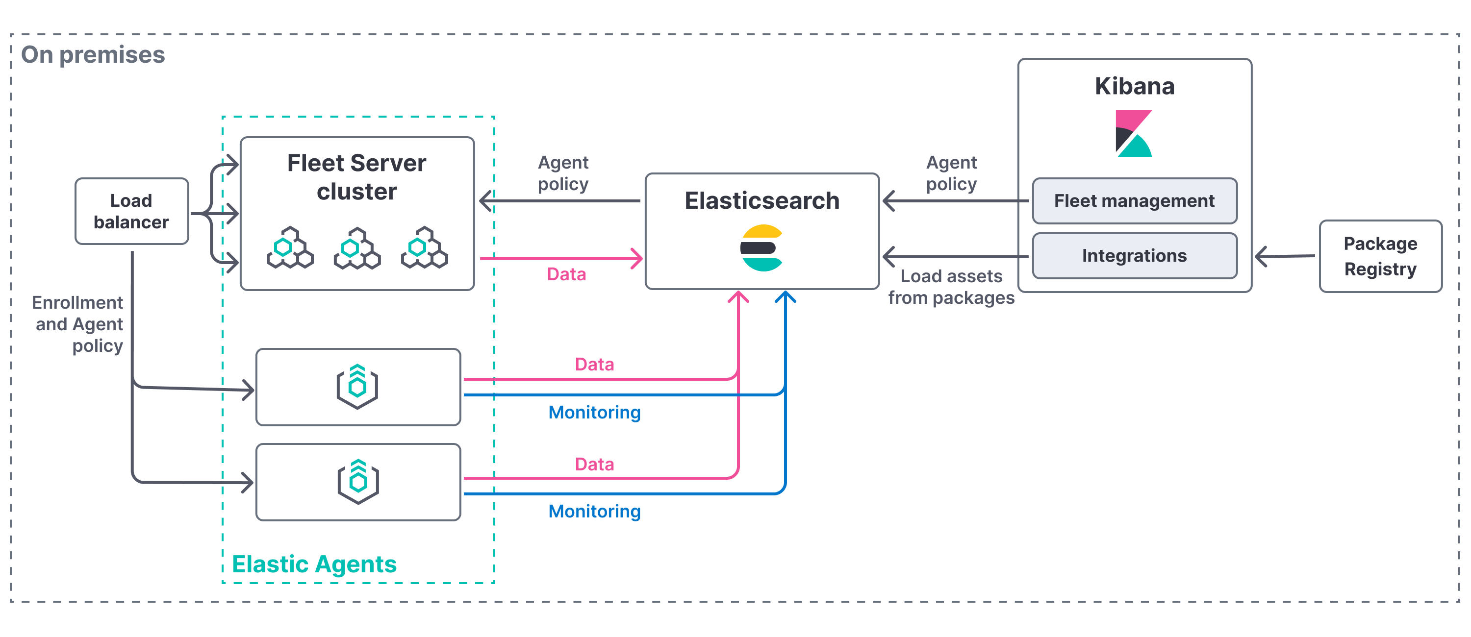

When using this approach, it’s recommended that you provision multiple instances of the Fleet Server and use a load balancer to better scale the deployment. You also have the option to use your organization’s certificate to establish a secure connection from Fleet Server to Elasticsearch.
Fleet Server on-premises deployment model

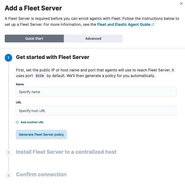

  3. This opens in-product instructions to add a Fleet Server using one of two options: Quick Start or Advanced.
    • Use Quick Start if you want Fleet to generate a Fleet Server policy and enrollment token for you. The Fleet Server policy will include a Fleet Server integration plus a system integration for monitoring Elastic Agent. This option generates self-signed certificates and is not recommended for production use cases.
      In-product instructions for adding a Fleet Server in quick start mode

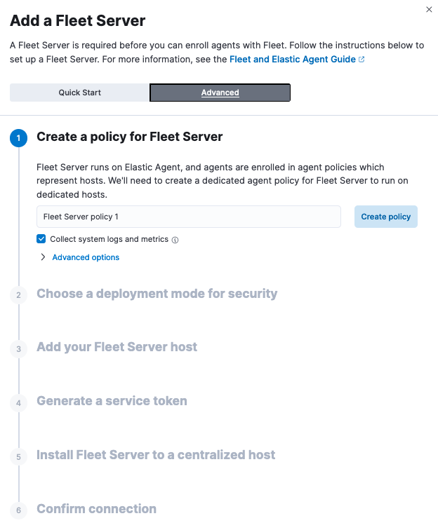

    • Use Advanced if you want to either:
      • Use your own Fleet Server policy. Fleet Server policies manage and configure the Elastic Agent running on Fleet Server hosts to launch a Fleet Server process. You can create a new Fleet Server policy or select an existing one. Alternatively you can create a Fleet Server policy without using the UI, and then select the policy here.
      • Use your own TLS certificates. TLS certificates encrypt traffic between Elastic Agents and Fleet Server. To learn how to generate certs, refer to Configure SSL/TLS for self-managed Fleet Servers.
        If you are providing your own certificates:
        • Before running the install command, make sure you replace the values in angle brackets.
        • Note that the URL specified by --url must match the DNS name used to generate the certificate specified by --fleet-server-cert.
        In-product instructions for adding a Fleet Server in advanced mode
  4. Step through the in-product instructions to configure and install Fleet Server.
    • The fields to configure Fleet Server hosts are not available if the hosts are already configured outside of Fleet. For more information, refer to Fleet settings in Kibana.
    • When using the Advanced option, it’s recommended to generate a unique service token for each Fleet Server. For other ways to generate service tokens, refer to elasticsearch-service-tokens.
    • If you’ve configured a non-default port for Fleet Server in the Fleet Server integration, you need to include the --fleet-server-host and --fleet-server-port options in the elastic-agent install command. Refer to the install command documentation for details.
    At the Install Fleet Server to a centralized host step, the elastic-agent install command installs an Elastic Agent as a managed service and enrolls it in a Fleet Server policy. For more Fleet Server commands, refer to the Elastic Agent command reference.
