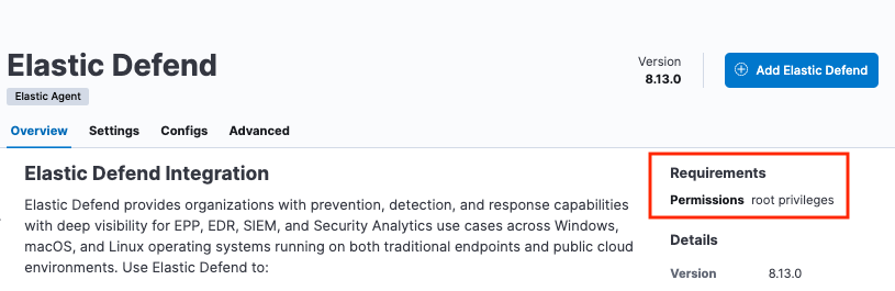

Most Elastic integrations support running Elastic Agent in unprivileged mode. For the exceptions, any integration that requires Elastic Agent to have root privileges has the requirement indicated at the top of the integration page in Kibana:
Elastic Defend integration page showing root requirement

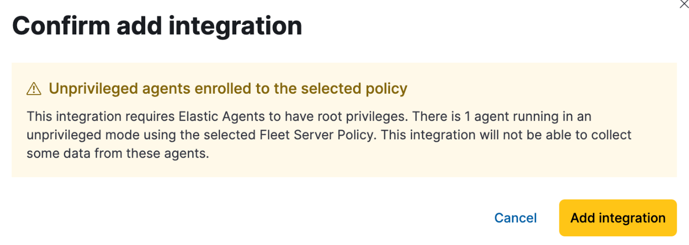

As well, a warning is displayed in Kibana if you try to add an integration that requires root privileges to an Elastic Agent policy that has agents enrolled in unprivileged mode.
Warning indicating that root privileged agent is required for an integration

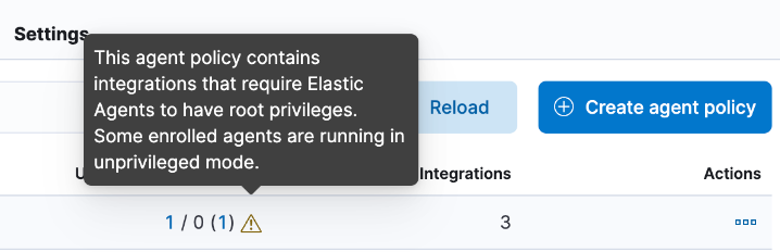

In the event that the Elastic Agent policy has integrations installed that require root privileges, but there are agents running without root privileges, this is shown in the tooltip.
Agent policy tab showing 1 unprivileged agent and 0 privileged enrolled agents
