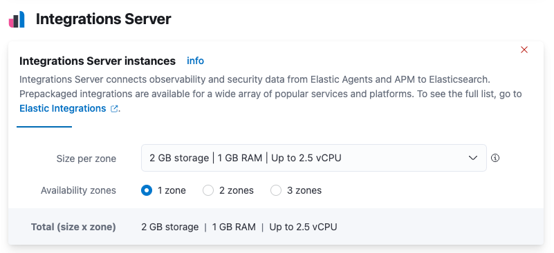

First modify your Fleet deployment settings in Elastic Cloud:
  1. Log in to Elastic Cloud and go to your deployment.
  2. Under Deployments > deployment name, click Edit.
  3. Under Integrations Server:
    • Modify the compute resources available to the server to accommodate a higher scale of Elastic Agents
    • Modify the availability zones to satisfy fault tolerance requirements
    For recommended settings, refer to Scaling recommendations (Elastic Cloud).

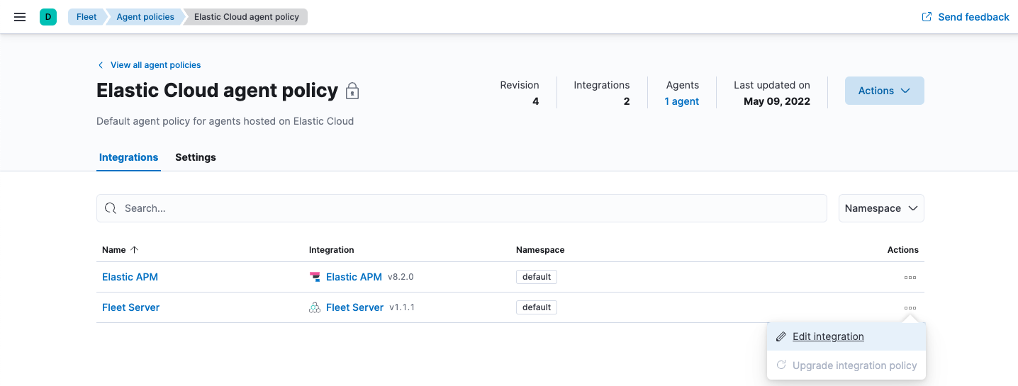

Next modify the Fleet Server configuration by editing the agent policy:
  1. In Fleet, open the Agent policies tab. Click the name of the Elastic Cloud agent policy to edit the policy.
  2. Open the Actions menu next to the Fleet Server integration and click Edit integration.
    Elastic Cloud policy

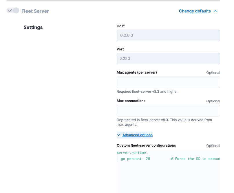

  3. Under Fleet Server, modify Max Connections and other advanced settings as described in Scaling recommendations (Elastic Cloud).
Advanced Fleet Server options
