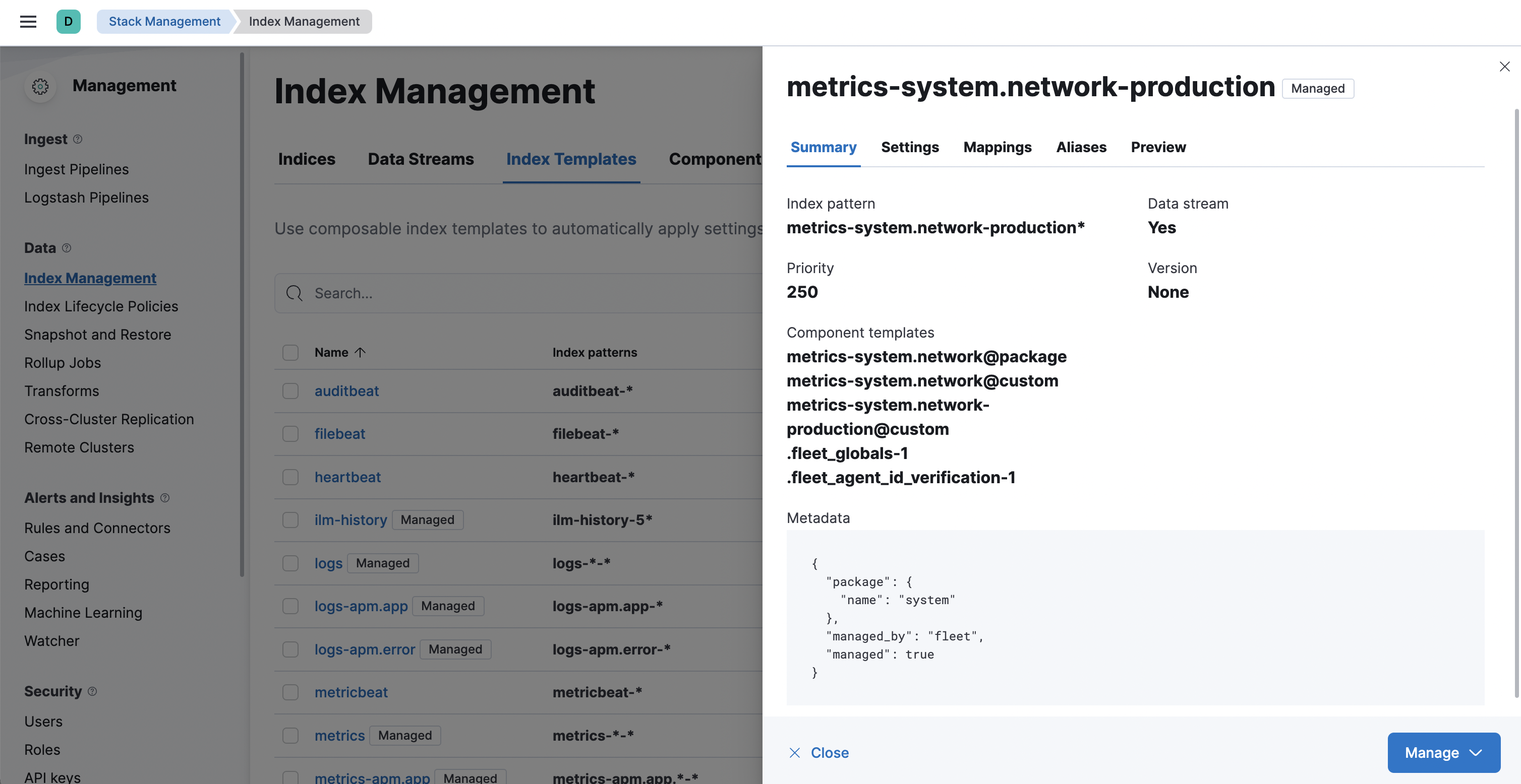

Step 3: Clone and modify the existing index template
editNow that you’ve created a component template, you need to create an index template to apply the changes to the correct data stream. The easiest way to do this is to duplicate and modify the integration’s existing index template.
When duplicating the index template, do not change or remove any managed properties. This may result in problems when upgrading.
- Navigate to Stack Management > Index Management > Index Templates.
Find the index template you want to clone. The index template will have the
<type>
and<dataset>
in its name, but not the<namespace>
. In this case, it’smetrics-system.network
. - Select Actions > Clone.
Set the name of the new index template to
metrics-system.network-production
Change the index pattern to include a namespace—in this case,
metrics-system.network-production*
. This ensures the previously created component template is only applied to theproduction
namespace. -
Set the priority to
250
. This ensures that the new index template takes precedence over other index templates that match the index pattern. -
Under Component templates, search for and add the component template created in the previous step.
To ensure your namespace-specific settings are applied over other custom settings,
the new template should be added below the existing
@custom
template. - Create the index template.
