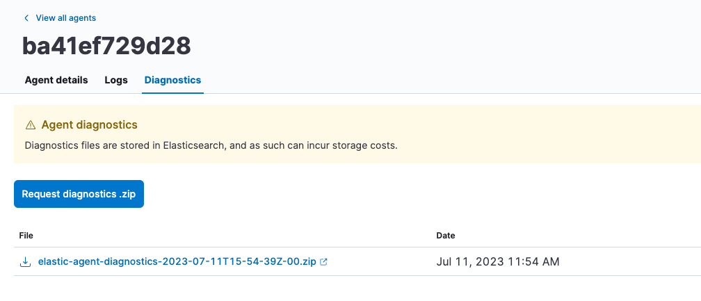

Get the diagnostics bundle through Fleet
Fleet provides the ability to remotely generate and gather an Elastic Agent’s diagnostics bundle. An agent can gather and upload diagnostics if it is online in a Healthy or Unhealthy state. To download the diagnostics bundle for local viewing:
  1. In Kibana, go to Management → Fleet → Agents.
  2. In the Host column, click the agent’s name.
  3. Click the Diagnostics tab.
  4. Click the Request diagnostics .zip button.
    Collect agent diagnostics under agent details
Any in-progress or previously collected bundles for the Elastic Agent will be listed on this page.
Note that the bundles are stored in Elasticsearch and will be removed after 30 days.
