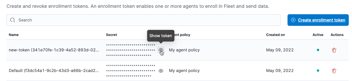

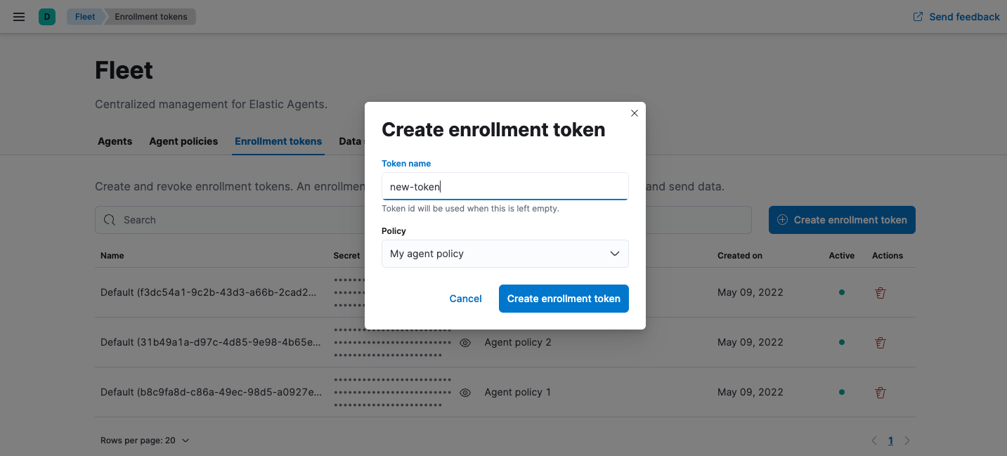

- In Kibana, go to Management → Fleet → Enrollment tokens.
Click Create enrollment token. Name your token and select an agent policy.
Note that the token name you specify must be unique so as to avoid conflict with any existing API keys.
- Click Create enrollment token.
In the list of tokens, click the Show token icon to see the token secret.
All Elastic Agents enrolled through this token will use the selected policy unless you assign or enroll them in a different policy.
To learn how to install Elastic Agents and enroll them in Fleet, refer to Install Elastic Agents.

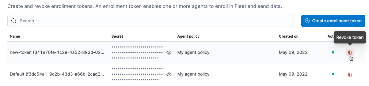

editYou can revoke an enrollment token that you no longer wish to use to enroll Elastic Agents in an agent policy in Fleet. Revoking an enrollment token essentially invalidates the API key used by agents to communicate with Fleet Server.
To revoke an enrollment token:
- In Fleet, click Enrollment tokens.
Find the token you want to revoke in the list and click the Revoke token icon.
Click Revoke enrollment token. You can no longer use this token to enroll Elastic Agents. However, the currently enrolled agents will continue to function.
To re-enroll your Elastic Agents, use an active enrollment token.
