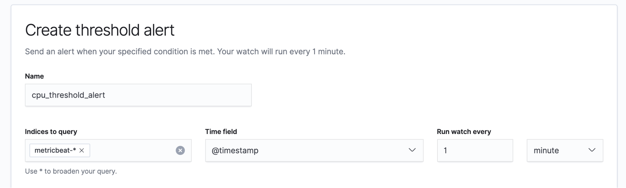

Define the watch input and schedule
edit-
Click Create and then select Create threshold alert.
You’re navigated to a page where you’re asked to define the watch name, the data that you want to evaluate, and how often you want to trigger the watch.
Enter a name that you want to call the alert, for example,
cpu_threshold_alert
In the Indices to query field, enter
metricbeat-*
and select@timestamp
as the time field. -
Use the default schedule to run the watch every 1 minute.

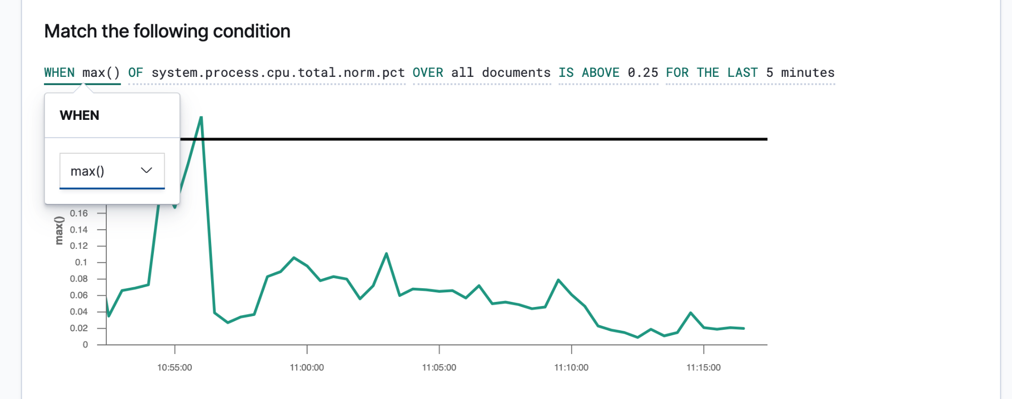

Add a condition
editYou should now see a panel with default conditions and a visualization of the data based on those conditions. The condition evaluates the data you’ve loaded into the watch and determines if any action is required.
Click the
WHEN
expression and change the value tomax()
.The
OF
expression now appears. -
Search for
system.process.cpu.total.norm.pct
and select it from the list. -
Select the
IS ABOVE
expression and change the value to.25
to trigger an alert whenever the CPU is above 25%.As you change the condition, the visualization is automatically updated. The black line represents the threshold (25%), while the green fluctuating line represents the change in CPU over the set time period.

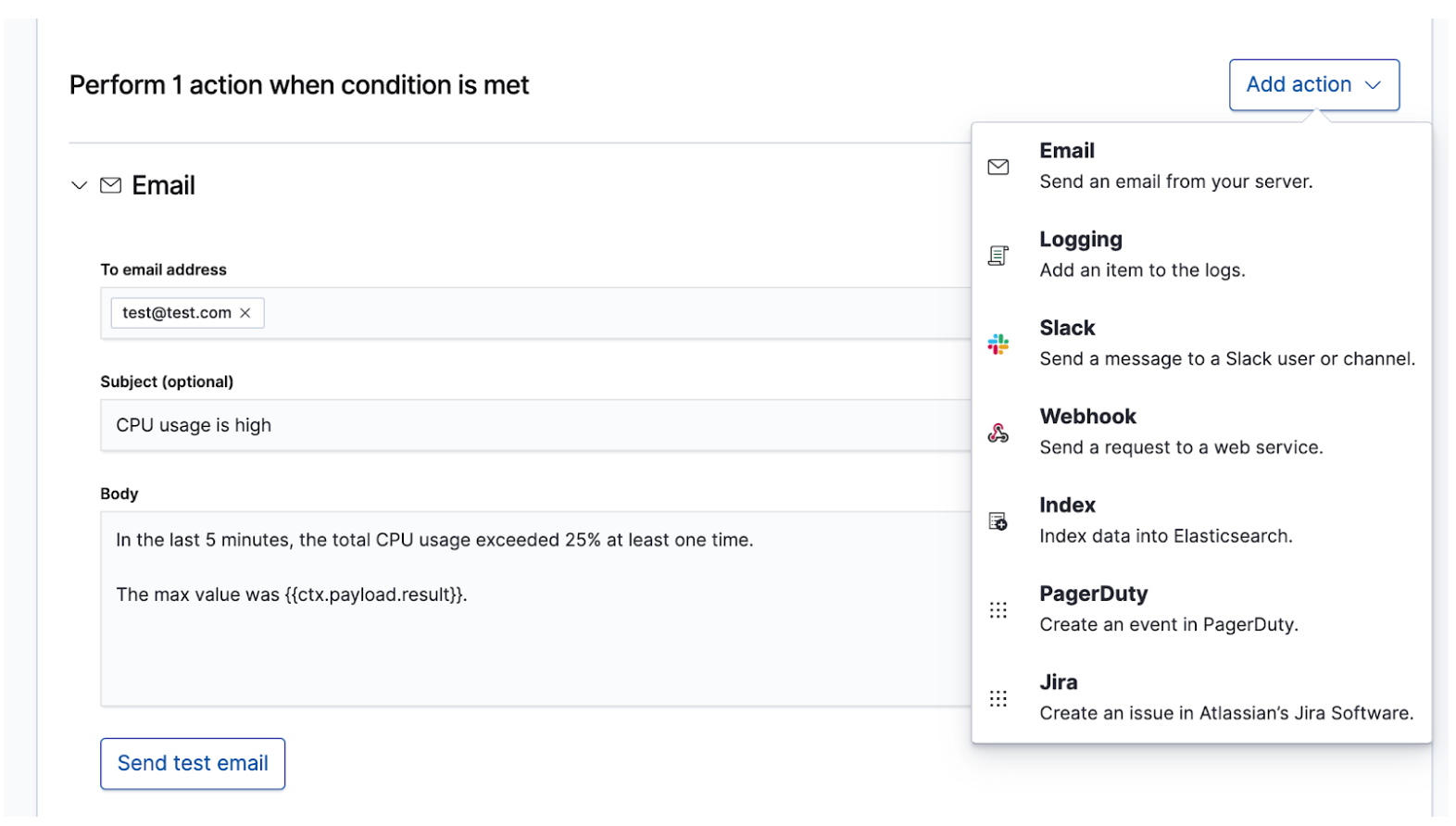

Add an action
editNow that the condition is set, you must add an action. The action triggers when the watch condition is met. For a complete list of actions and how to configure them, see Adding conditions to actions.
In this example, you’ll configure an email action. You must have an email account configured in Elasticsearch for this example to work.
- Click Add action and select Email.
- In the To email address field, enter one or more email addresses to whom you want to send the message when the condition is met.
Enter a subject and body for the email.
To test the action before saving the watch, click Send test email.
A sample email is sent using the configuration you set up.

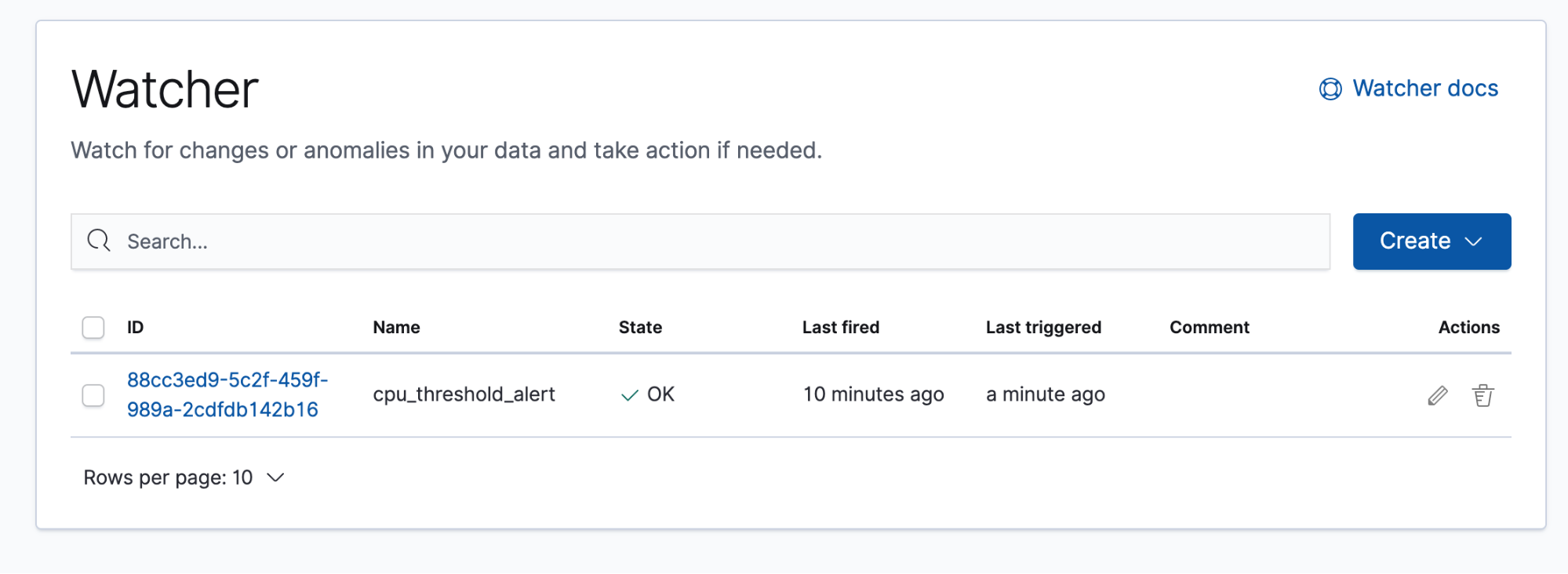

Click Create alert.
The alert appears on the Watcher overview page, where you can drill down into the watch history and status.

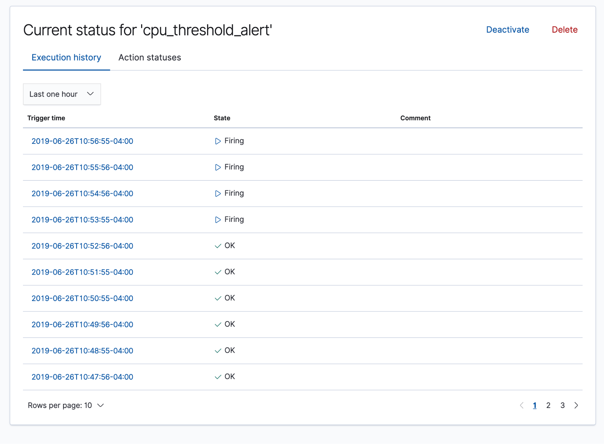

View watch history and status
editThe Watcher overview page lists your watches and includes details such as state, last fired, and last triggered. A watch has one of four states:
- Firing. The watch is triggered and actively performing the associated actions.
- Error. The watch is not working properly.
- OK. The watch is not actively firing but working properly.
- Disabled. The watch will not fire under any circumstances.
From this page you can drill down into a watch to investigate its history and status.
View watch history
editThe Execution history tab shows each time the watch is triggered and the results of the query, whether the condition was met, and what actions were taken.

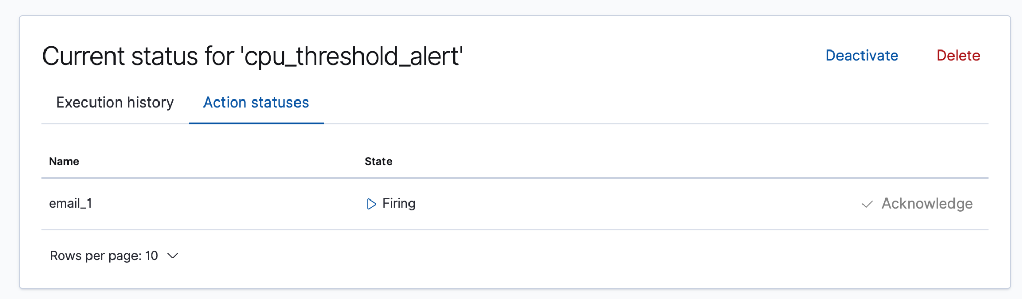

Acknowledge action status
editThe Action statuses tab lists all actions associated with the watch and the state of each action. If the action is firing, you can acknowledge the watch to prevent too many executions of the same action for the same watch. See Acknowledgement and throttling for details.

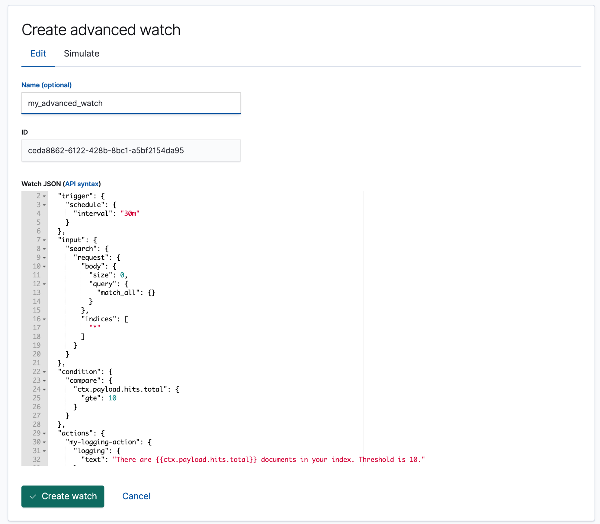

Create an advanced watch
editAdvanced watches are for users who are more familiar with Elasticsearch query syntax and the Watcher framework. The UI is aligned with using the REST APIs. For more information, see Query DSL.
Create the watch
editOn the Watch overview page, click Create and choose Create advanced watch. An advanced watch requires a name and ID. Name is a user-friendly way to identify the watch, and ID refers to the identifier used by Elasticsearch. Refer to Watch definition for how to input the watch JSON.

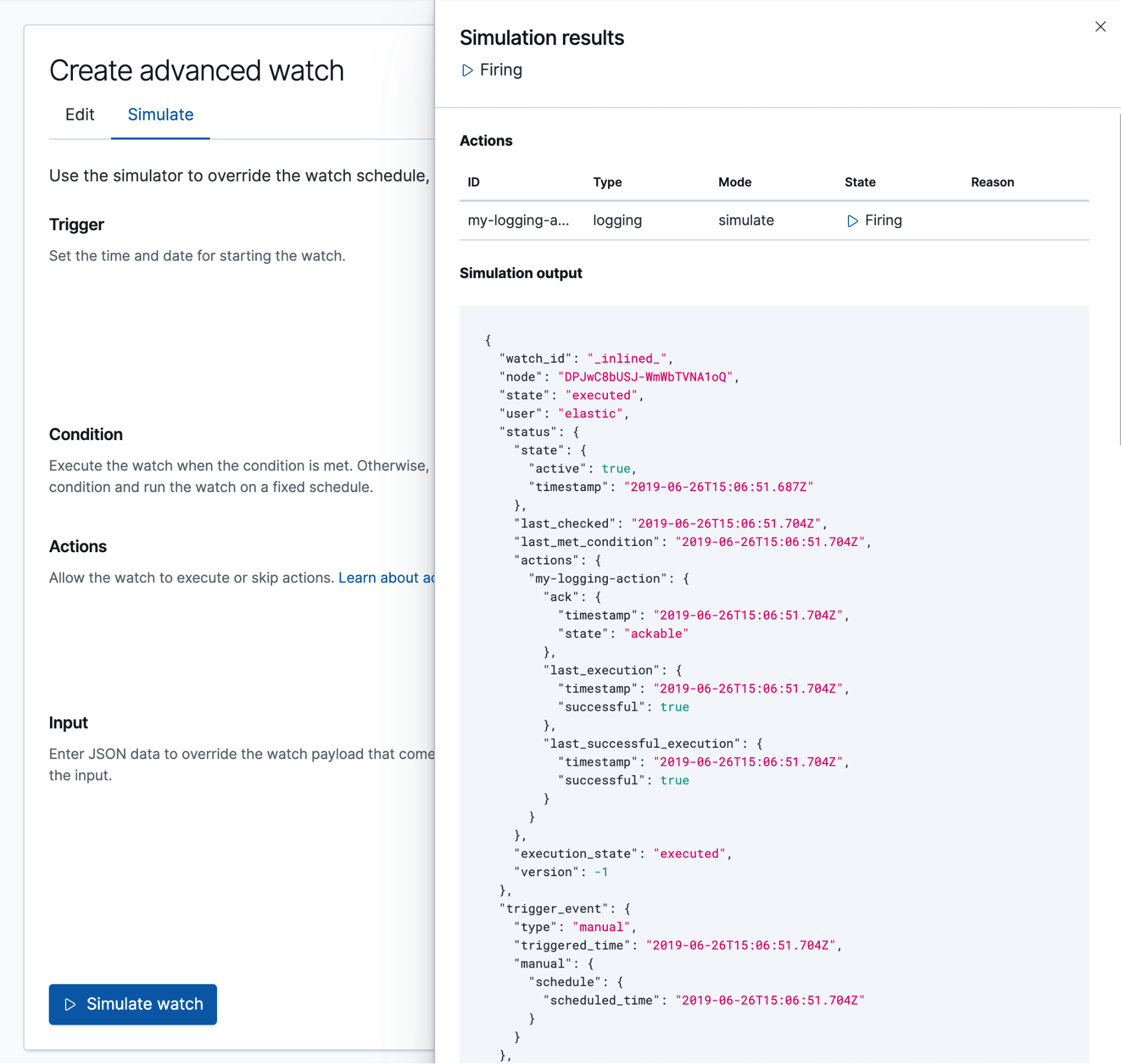

Simulate the watch
editThe Simulate tab allows you to override parts of the watch, and then run a simulation. Be aware of these implementation details on overrides:
- Trigger overrides use date math.
- Input overrides accepts a JSON blob.
Condition overrides indicates if you want to force the condition to always be
true
. - Action overrides support multiple options.
After starting the simulation, you’ll see a results screen. For more information on the fields in the response, see the Execute watch API.
