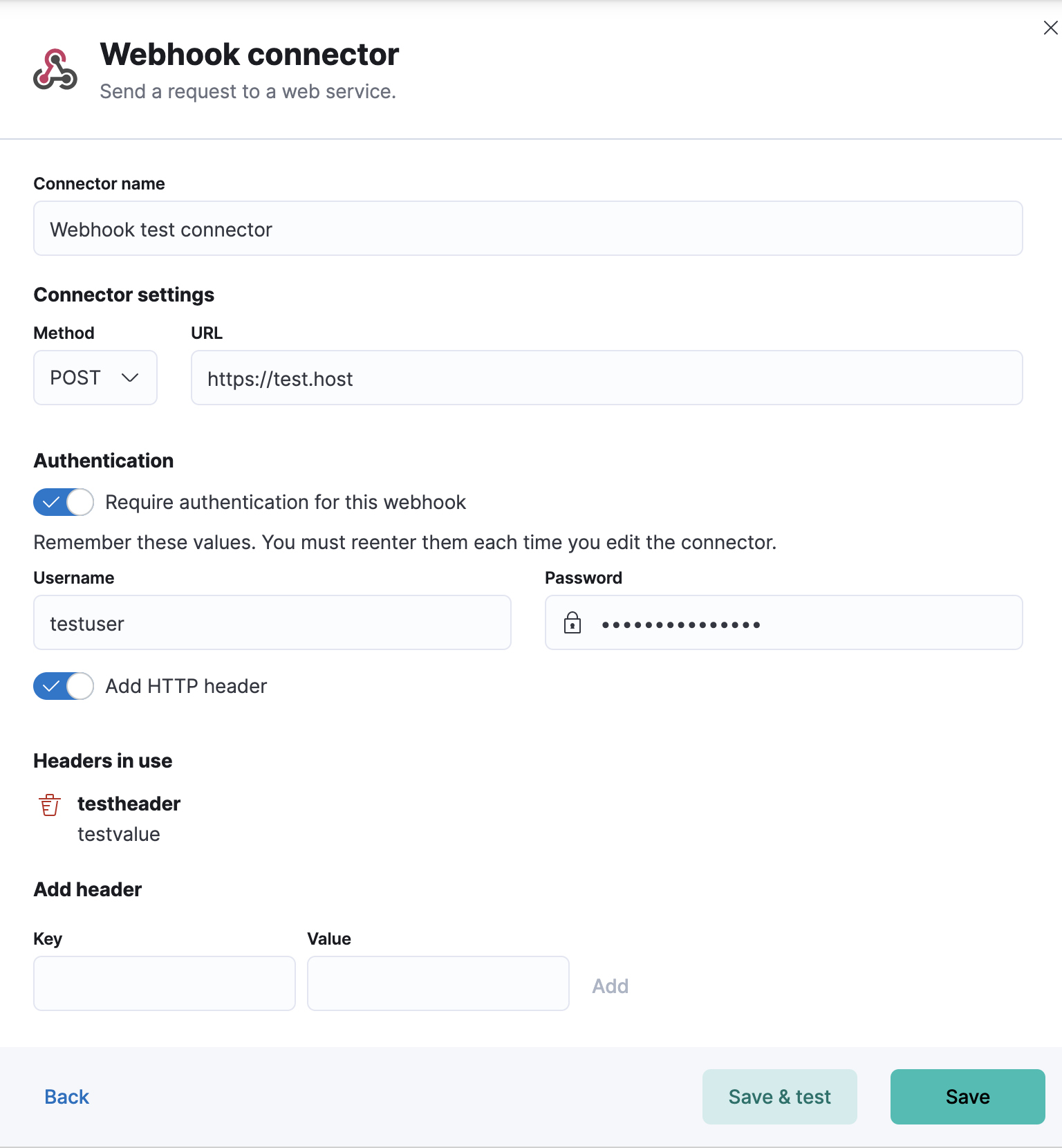

Connector configuration
editWebhook connectors have the following configuration properties.
- Name
- URL
The request URL. If you are using the
xpack.actions.allowedHosts
setting, make sure the hostname is added to the allowed hosts. - Method
HTTP request method, either
POST
(default) orPUT
. - Headers
- A set of key-value pairs sent as headers with the request
- Require authentication
- If true, a username and password for login type authentication must be provided.
- Username
- Username for HTTP basic authentication.
- Password
- Password for HTTP basic authentication.
Preconfigured connector type
editmy-webhook: name: preconfigured-webhook-connector-type actionTypeId: .webhook config: url: https://test.host method: POST headers: testheader: testvalue secrets: user: testuser password: passwordkeystorevalue
url
- A URL string that corresponds to URL.
method
- A string that corresponds to Method.
headers
- A record<string, string> that corresponds to Headers.
hasAuth
A boolean that corresponds to Requires authentication. If
true
, this connector will require values foruser
andpassword
inside the secrets configuration. Defaults totrue
user
A string that corresponds to User. Required if
hasAuth
is set totrue
password
A string that corresponds to Password. Should be stored in the Kibana keystore. Required if
hasAuth
is set totrue
editDefine Webhook connector properties.

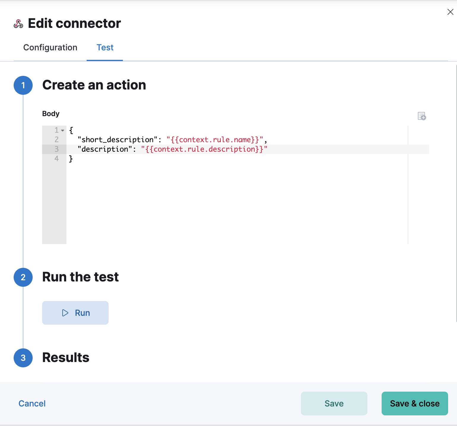

Test Webhook action parameters.
Action configuration
editWebhook actions have the following properties.
- Body
A JSON payload sent to the request URL. For example:
{ "short_description": "{{context.rule.name}}", "description": "{{context.rule.description}}", ... }
Mustache template variables (the text enclosed in double braces, for example, context.rule.name
) have
their values escaped, so that the final JSON will be valid (escaping double quote characters).
For more information on Mustache template variables, refer to Action type and details.
