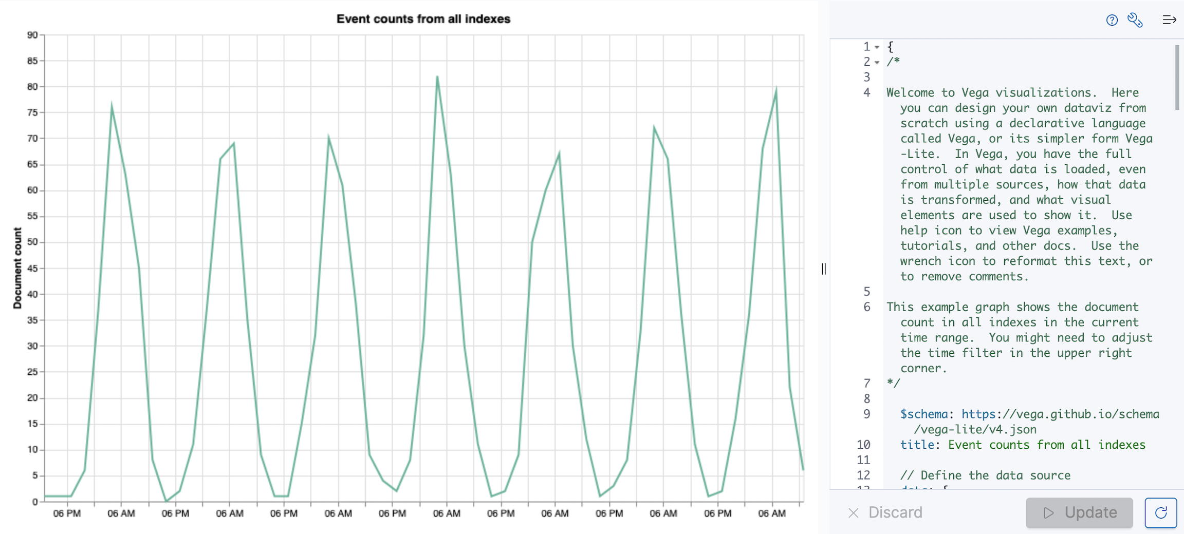

Open and set up Vega-Lite
Open Vega-Lite and change the time range.
  1. On the dashboard, click All types, then select Custom visualization.
    A pre-populated line chart displays the total number of documents.
  2. Make sure the time filter is Last 7 days.

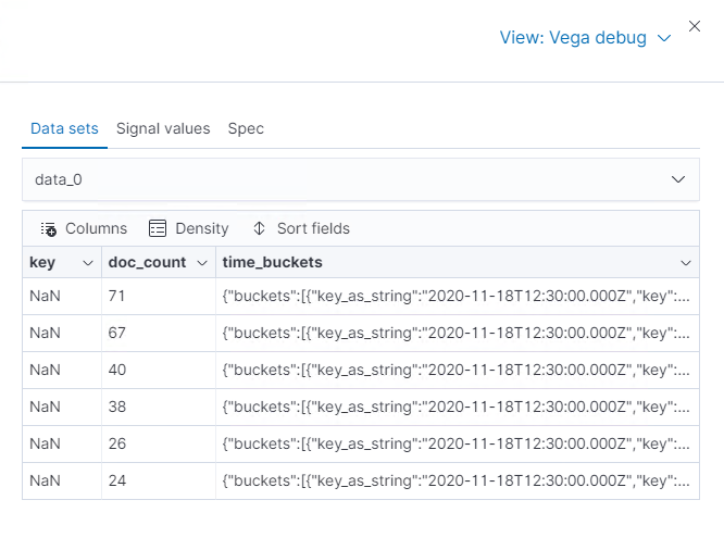

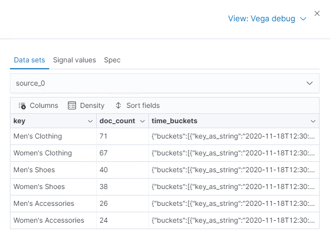

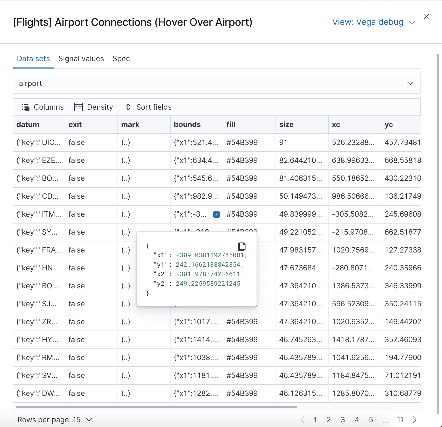

To generate the data, Vega-Lite uses the source_0 and data_0. source_0 contains the results from the Elasticsearch query, and data_0 contains the visually encoded results that are shown on the chart. To debug the warning, compare source_0 and data_0.
  1. In the toolbar, click Inspect.
  2. From the View dropdown, select Vega debug.
  3. From the dropdown, select source_0.
    Table for data_0 with columns key
  4. To compare to the visually encoded data, select data_0 from the dropdown.
    Table for data_0 where the key is NaN instead of a string
    key is unable to convert because the property is category (Men's Clothing, Women's Clothing, etc.) instead of a timestamp.

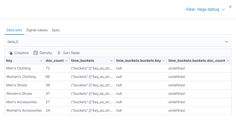

  1. Click Inspect, then select Vega Debug from the View dropdown.
  2. From the dropdown, select data_0.
    Table for data_0 showing that the column time_buckets.buckets.key is undefined
Vega-Lite is unable to extract the time_buckets.buckets inner array.

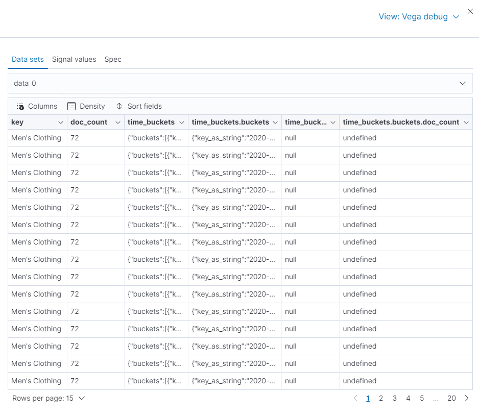

    Table showing data_0 with multiple pages of results
    Vega-Lite displays undefined values because there are duplicate names.
  3. To resolve the duplicate names, add the transform and encoding blocks, then click Update:

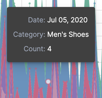

When you hover over the area series on the stacked area chart, a multi-line tooltip appears, but is unable to indicate the nearest point. To indicate the nearest point, add a second layer.

Additional tooltip styling
Kibana has installed the Vega tooltip plugin, so tooltips can be defined in the ways documented there. Beyond that, Kibana also supports a configuration option for changing the tooltip position and padding:
  config: {
    kibana: {
      tooltips: {
        position: 'top',
        padding: 15,
        textTruncate: true,

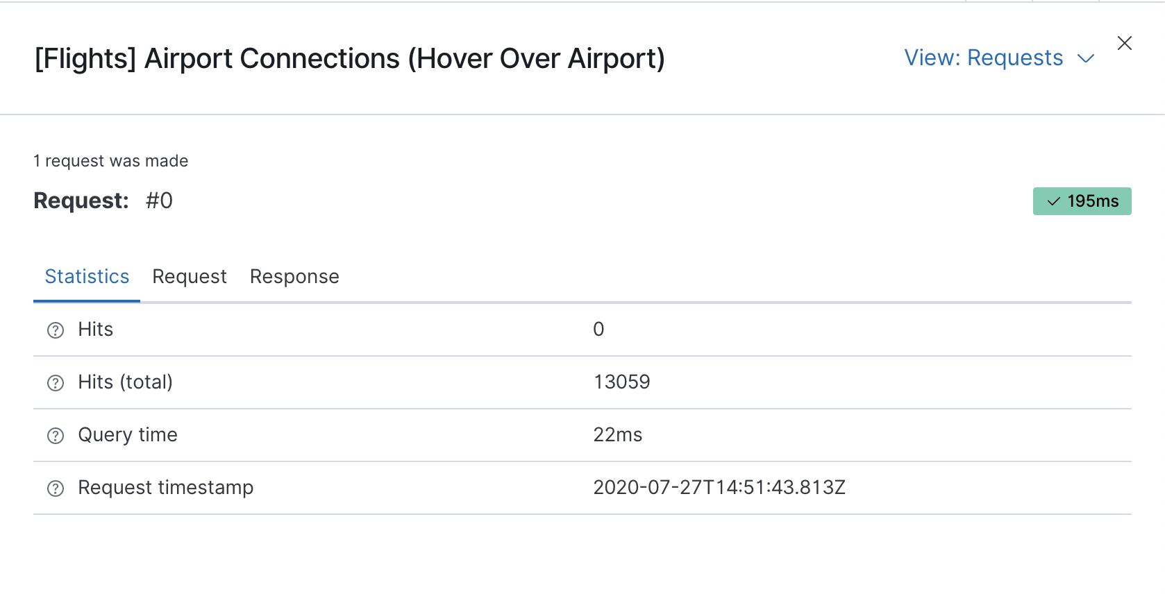

Use the contextual Inspect tool to gain insights into different elements.
Inspect Elasticsearch requests
Vega uses the Elasticsearch search API to get documents and aggregation results from Elasticsearch. To troubleshoot these requests, click Inspect, which shows the most recent requests. In case your specification has more than one request, you can switch between the views using the View dropdown.
vega tutorial inspect requests

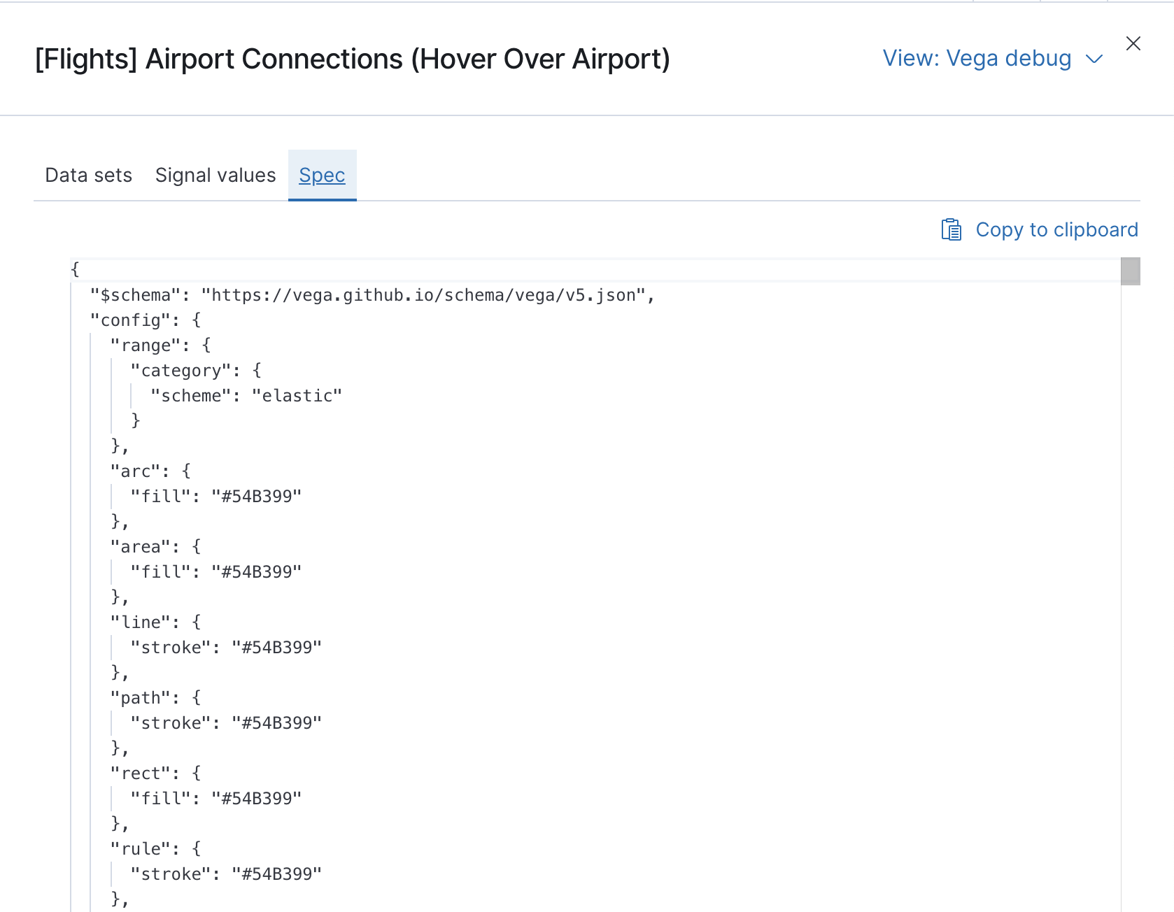

Vega debugging
With the Vega debug view, you can inspect the Data sets and Signal Values runtime data.
The runtime data is read from the runtime scope.
vega tutorial inspect data sets
To debug more complex specs, access to the view variable. For more information, refer to the Vega browser debugging process.
