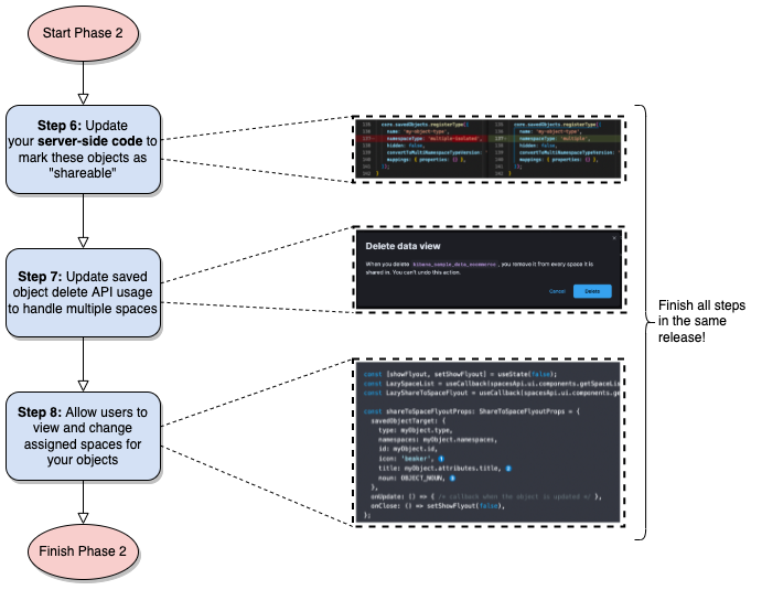

Phase 2 developer flowchart
This section covers switching a share-capable object type into a shareable one or creating a new shareable saved object type. Refer to this flowchart:
Sharing Saved Objects phase 2 - developer flowchart
Step 6
Update your server-side code to mark these objects as "shareable"
When you register your object, you need to set the proper namespaceType. If you have an existing object type that is "share-capable", you can simply change it:
Sharing Saved Objects registration (shareable)
Step 7
Update saved object delete API usage to handle multiple spaces
If an object is shared to multiple spaces, it cannot be deleted without using the force delete option. You should always be aware when a saved object exists in multiple spaces, and you should warn users in that case.
If your UI allows users to delete your objects, you can define a warning message like this:
const { namespaces, id } = savedObject;
const warningMessage =
  namespaces.length > 1 || namespaces.includes('*') ? (
    <FormattedMessage
      id="myPlugin.deleteObjectWarning"
      defaultMessage="When you delete this object, you remove it from every space it is shared in. You can't undo this action."
  ) : null;
The Data Views page in Stack Management uses a similar approach to show a warning in its delete confirmation modal:
Sharing Saved Objects deletion warning
Step 8
Allow users to view and change assigned spaces for your objects
Users will need a way to view what spaces your objects are currently assigned to and share them to additional spaces. You can accomplish this in two ways, and many consumers will want to implement both:
  1. (Highly recommended) Add reusable components to your application, making it "space-aware". The space-related components are exported by the spaces plugin, and you can use them in your own application.
    First, make sure your page contents are wrapped in a spaces context provider:
    const ContextWrapper = useMemo(
        spacesApi ? spacesApi.ui.components.getSpacesContextProvider : getEmptyFunctionComponent,
      [spacesApi]
    return (

    Second, display a list of spaces for an object, and third, show a flyout for the user to edit the object’s assigned spaces. You may want to follow the example of the Data Views page and combine these into a single component so that the space list can be clicked to show the flyout:
    const [showFlyout, setShowFlyout] = useState(false);
    const LazySpaceList = useCallback(spacesApi.ui.components.getSpaceList, [spacesApi]);
    const LazyShareToSpaceFlyout = useCallback(spacesApi.ui.components.getShareToSpaceFlyout, [spacesApi]);
    const shareToSpaceFlyoutProps: ShareToSpaceFlyoutProps = {
      savedObjectTarget: {
        type: myObject.type,
        namespaces: myObject.namespaces,
        icon: 'beaker',
        title: myObject.attributes.title,
        noun: OBJECT_NOUN,
      onUpdate: () => { /* callback when the object is updated */ },
      onClose: () => setShowFlyout(false),
    const canAssignSpaces = !capabilities || !!capabilities.savedObjectsManagement.shareIntoSpace;
    const clickProperties = canAssignSpaces
      ? { cursorStyle: 'pointer', listOnClick: () => setShowFlyout(true) }
      : { cursorStyle: 'not-allowed' };
    return (
        <LazySpaceList
          namespaces={spaceIds}
          displayLimit={8}
          behaviorContext="outside-space"
          {...clickProperties}
        {showFlyout && <LazyShareToSpaceFlyout {...shareToSpaceFlyoutProps} />}
    The icon field is optional. It specifies an EUI icon type that will be displayed in the flyout header.
    The title field is optional. It specifies a human-readable identifier for your object that will be displayed in the flyout header.
    The noun field is optional. It just changes "object" in the flyout to whatever you specify — you may want the flyout to say "dashboard" or "data view" instead.
    The behaviorContext field is optional. It controls how the space list is displayed. When using an "outside-space" behavior context, the space list is rendered outside of any particular space, so the active space is included in the list. On the other hand, when using a "within-space" behavior context, the space list is rendered within the active space, so the active space is excluded from the list.
