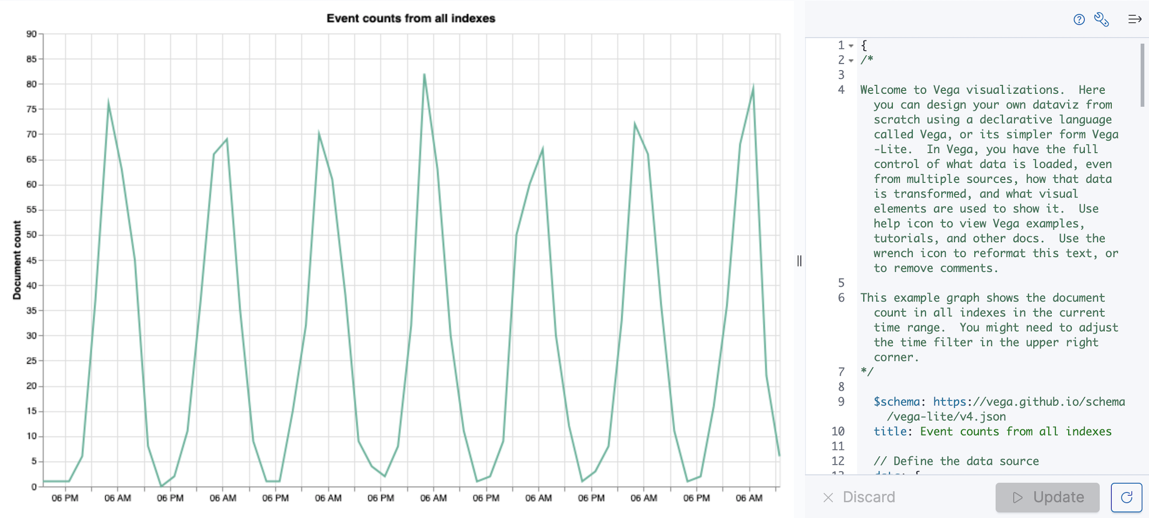

Open and set up Vega-Lite
editOpen Vega-Lite and change the time range.
On the dashboard, click Select type, then select Custom visualization.
A pre-populated line chart displays the total number of documents.
- Make sure the time filter is Last 7 days.

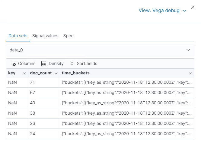

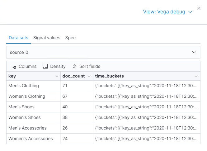

Debug the warning
editTo generate the data, Vega-Lite uses the source_0
and data_0
. source_0
contains
the results from the Elasticsearch query, and data_0
contains the visually encoded results that are shown on the chart.
To debug the warning, compare source_0
and data_0
- In the toolbar, click Inspect.
- From the View dropdown, select Vega debug.
From the dropdown, select source_0.
To compare to the visually encoded data, select data_0 from the dropdown.
key is unable to convert because the property is category (
Men's Clothing
,Women's Clothing
, etc.) instead of a timestamp.

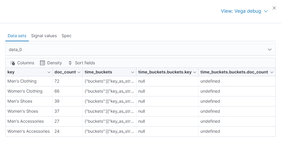

- Click Inspect, then select Vega Debug from the View dropdown.
From the dropdown, select data_0.
Vega-Lite is unable to extract the time_buckets.buckets
inner array.
Extract the time_buckets.buckets
inner array
editIn Kibana 7.9 and later, use the Vega-Lite flatten transformation to extract the time_buckets.buckets
inner array.
If you are using Kibana 7.8 and earlier, the flatten transformation is available only in Vega.

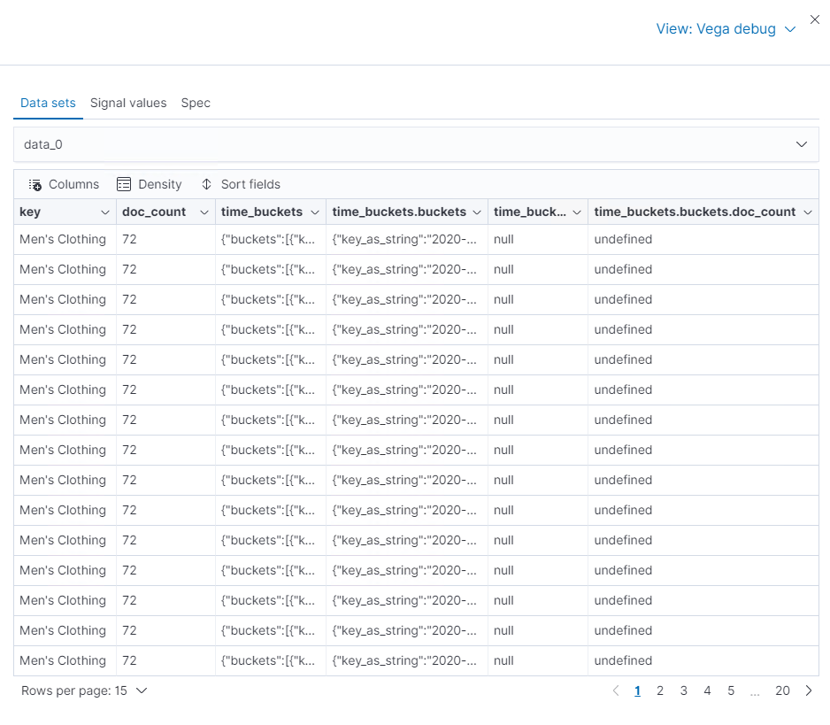

Vega-Lite displays undefined values because there are duplicate names.
To resolve the duplicate names, add the
transform
andencoding
blocks, then click Update:
transform: [{ flatten: ["time_buckets.buckets"], as: ["buckets"] }] mark: area encoding: { x: { field: buckets.key type: temporal axis: { title: null } } y: { field: buckets.doc_count type: quantitative axis: { title: "Document count" } } color: { field: key type: nominal } }

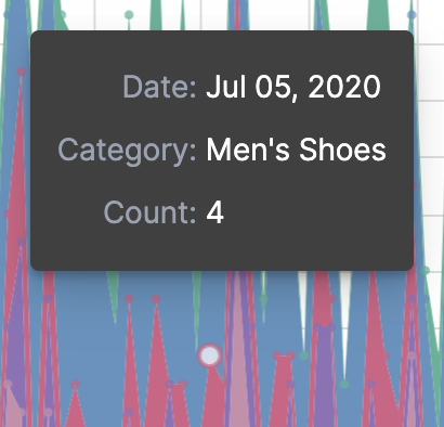

Add hover states and tooltips
editWith the Vega-Lite spec, you can add hover states and tooltips to the stacked area chart with the selection
block.
In the Vega-Lite spec, add the encoding
block, then click Update:
encoding: { tooltip: [{ field: buckets.key type: temporal title: "Date" }, { field: key type: nominal title: "Category" }, { field: buckets.doc_count type: quantitative title: "Count" }] }
When you hover over the area series on the stacked area chart, a multi-line tooltip appears, but is unable to indicate the nearest point. To indicate the nearest point, add a second layer.

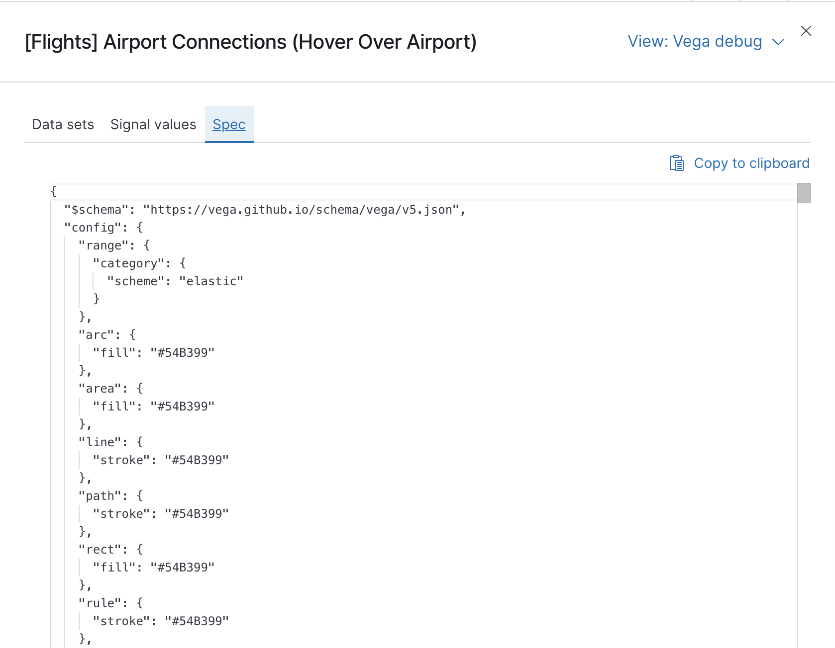

If you need full control, convert your spec to Vega using the browser console
VEGA_DEBUG.vega_spec
output.

Additional tooltip styling
editKibana has installed the Vega tooltip plugin, so tooltips can be defined in the ways documented there. Beyond that, Kibana also supports a configuration option for changing the tooltip position and padding:
{ config: { kibana: { tooltips: { position: 'top', padding: 15, textTruncate: true, } } } }

editUse the contextual Inspect tool to gain insights into different elements.

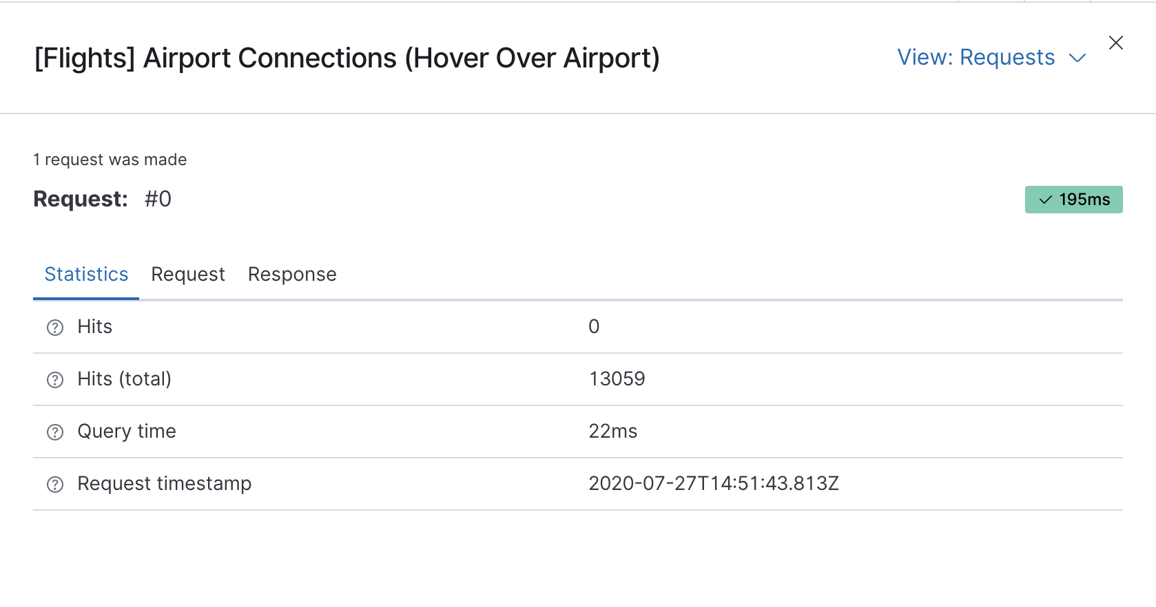

Inspect Elasticsearch requests
editVega uses the Elasticsearch search API to get documents and aggregation results from Elasticsearch. To troubleshoot these requests, click Inspect, which shows the most recent requests. In case your specification has more than one request, you can switch between the views using the View dropdown.

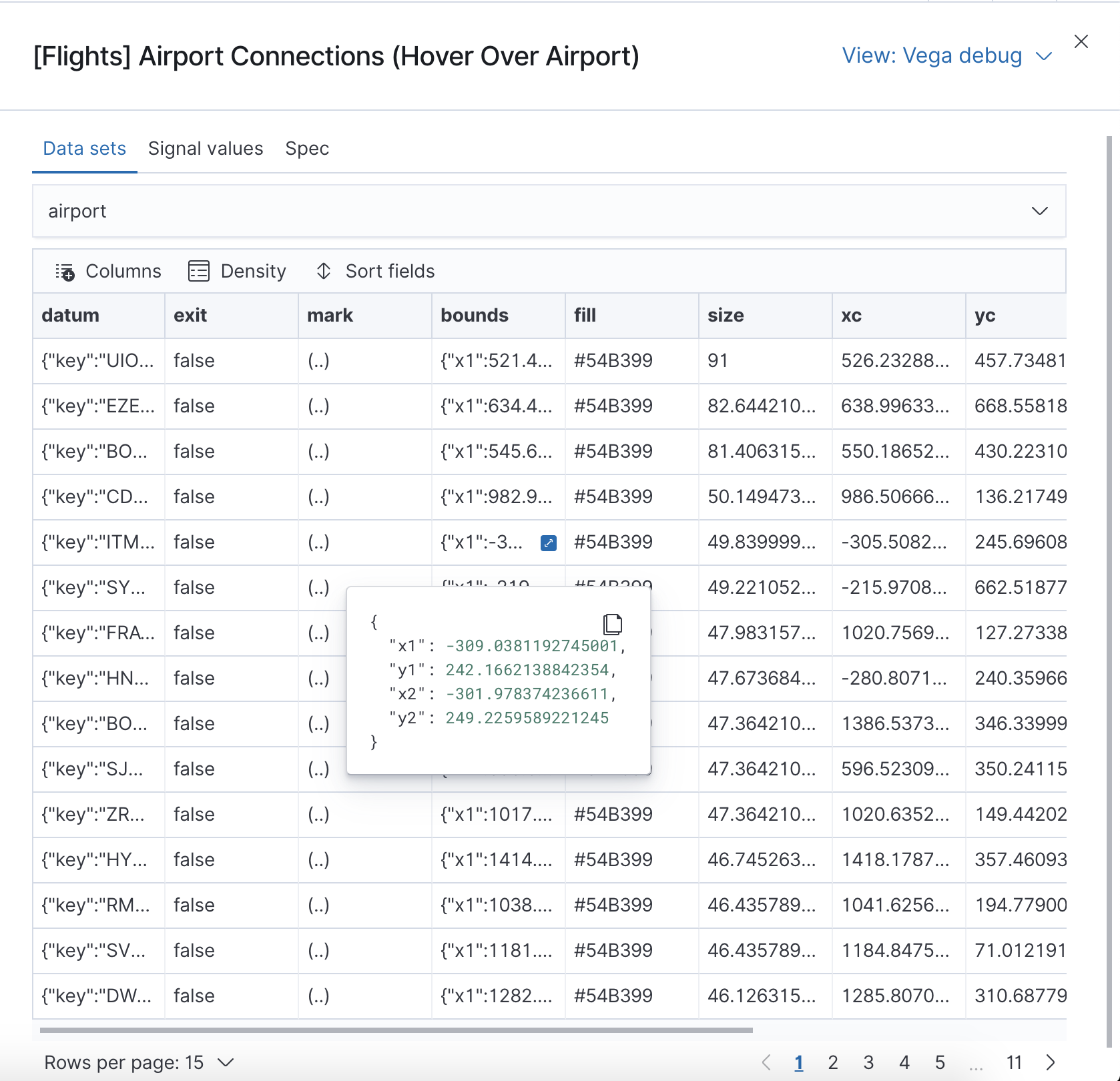

Vega debugging
editWith the Vega debug view, you can inspect the Data sets and Signal Values runtime data.
The runtime data is read from the runtime scope.
To debug more complex specs, access to the view
variable. For more information, refer to
the Vega browser debugging process.

Browser debugging console
[preview]
Use browser debugging tools (for example, F12 or Ctrl+Shift+J in Chrome) to
inspect the VEGA_DEBUG
variable:
view
— Access to the Vega View object. See Vega Debugging Guide on how to inspect data and signals at runtime. For Vega-Lite,VEGA_DEBUG.view.data('source_0')
gets the pre-transformed data, andVEGA_DEBUG.view.data('data_0')
gets the encoded data. For Vega, it uses the data name as defined in your Vega spec. -
vega_spec
— Vega JSON graph specification after some modifications by Kibana. In case of Vega-Lite, this is the output of the Vega-Lite compiler. -
vegalite_spec
— If this is a Vega-Lite graph, JSON specification of the graph before Vega-Lite compilation.
