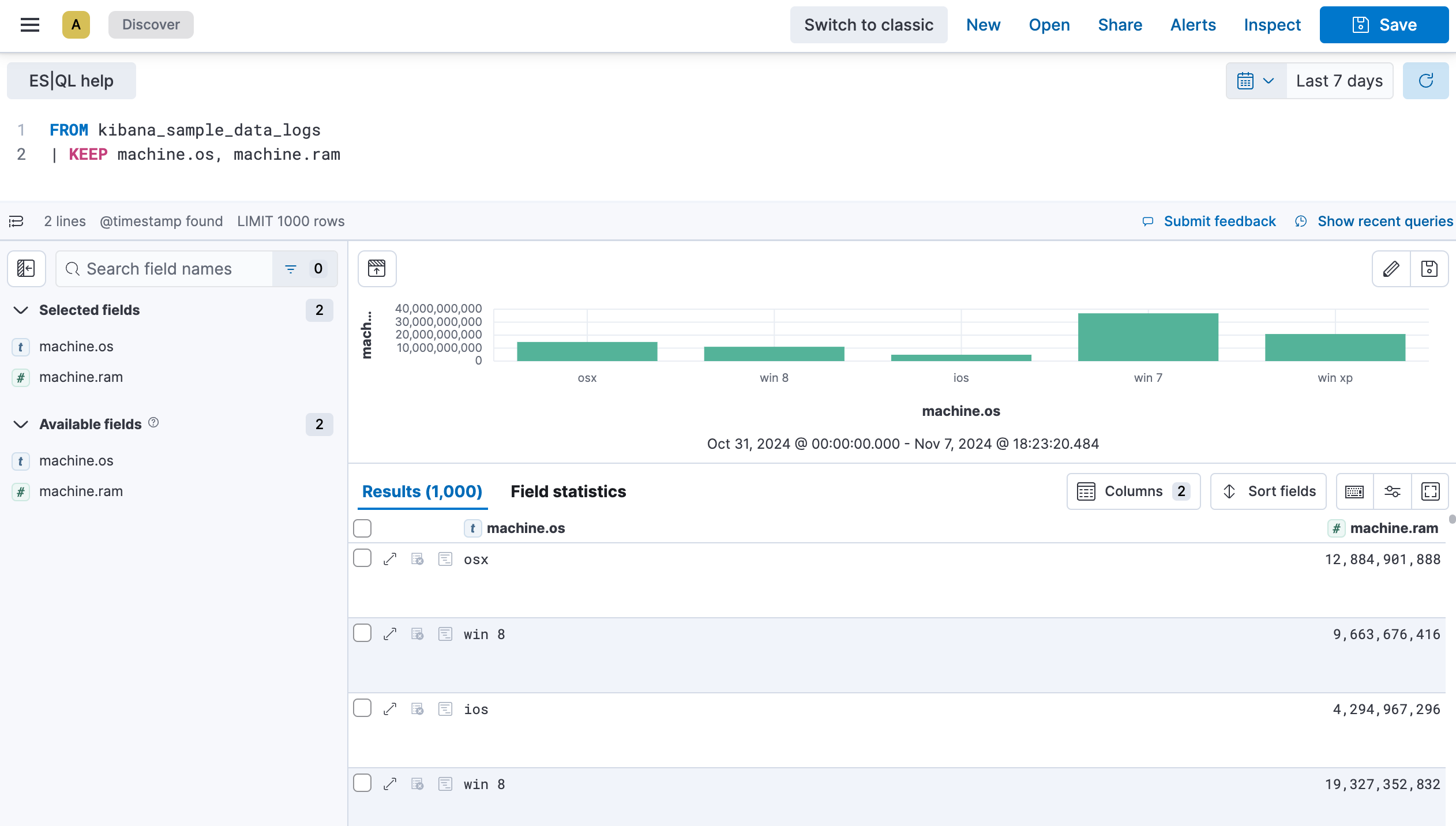

  4. Copy the following query. To make queries more readable, you can put each processing command on a new line.
    FROM kibana_sample_data_logs
    | KEEP machine.os, machine.ram
    1. We're specifically looking for data from the sample web logs we installed.
    2. We’re only keeping the machine.os and machine.ram fields in the results table.
    Note
    ES|QL keywords are not case sensitive.
  5. Click ▶Run. An image of the query result

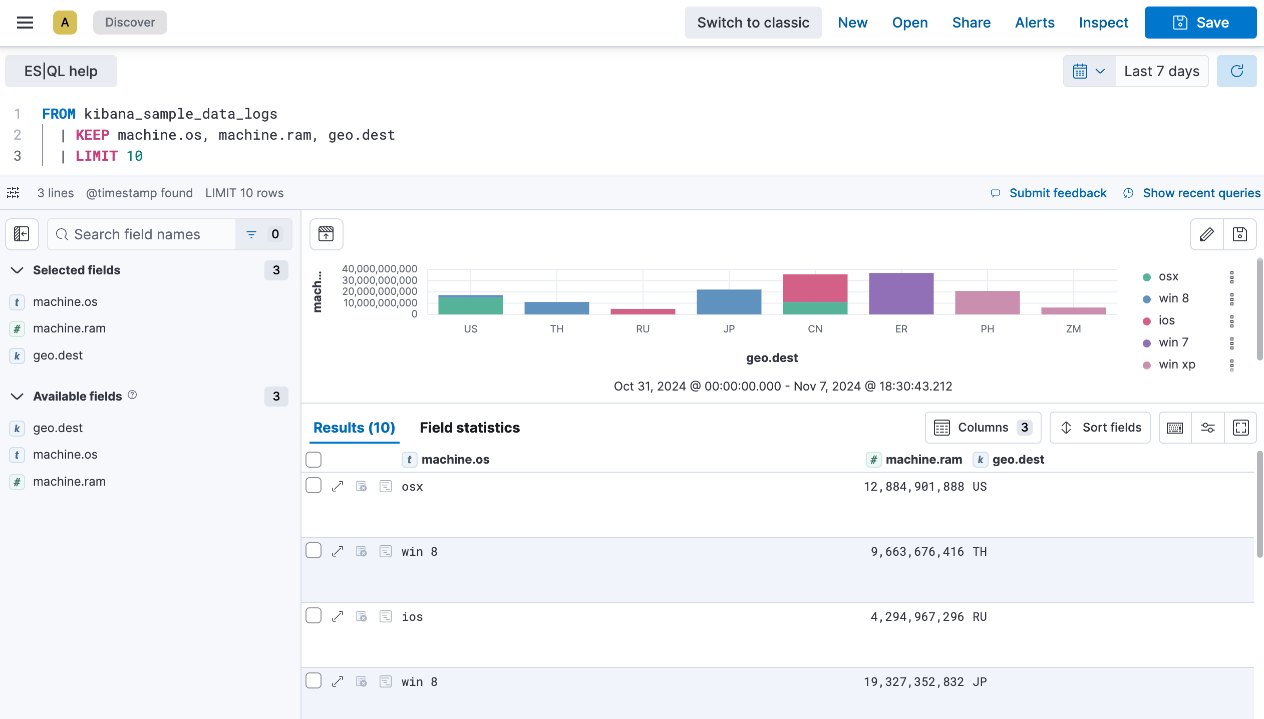

Let’s add geo.dest to our query to find out the geographical destination of the visits and limit the results.
  1. Copy the query below:
    | KEEP machine.os, machine.ram, geo.dest
    | LIMIT 10
  2. Click ▶Run again. You can notice that the table is now limited to 10 results. The visualization also updated automatically based on the query, and broke down the data for you.
    Note
    When you don’t specify any specific fields to retain using KEEP, the visualization isn’t broken down automatically. Instead, an additional option appears above the visualization and lets you select a field manually.
    An image of the extended query result

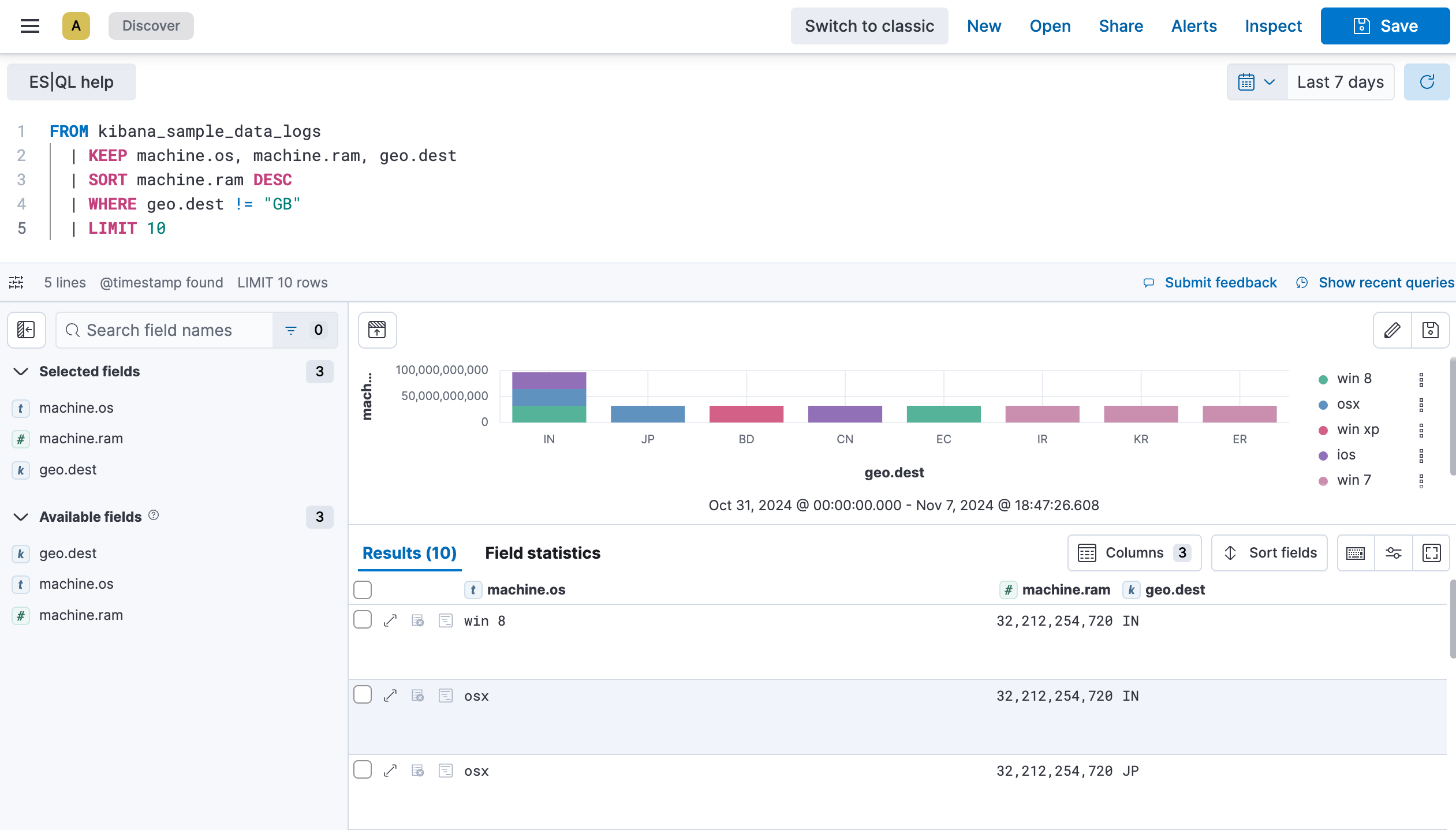

We will now take it a step further to sort the data by machine RAM and filter out the GB destination.
    | SORT machine.ram desc
    | WHERE geo.dest != "GB"
    | LIMIT 10
  2. Click ▶Run again. The table and visualization no longer show results for which the geo.dest field value is "GB", and the results are now sorted in descending order in the table based on the machine.ram field.
    An image of the full query result

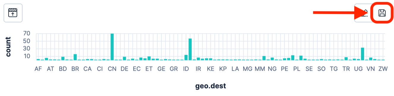

  3. Click Save to save the query and visualization to a dashboard.
You can make changes to the visualization by clicking the pencil icon. This opens additional settings that let you adjust the chart type, axes, breakdown, colors, and information displayed to your liking. If you’re not sure which route to go, check one of the suggestions available in the visualization editor.
If you’d like to keep the visualization and add it to a dashboard, you can save it using the floppy disk icon.

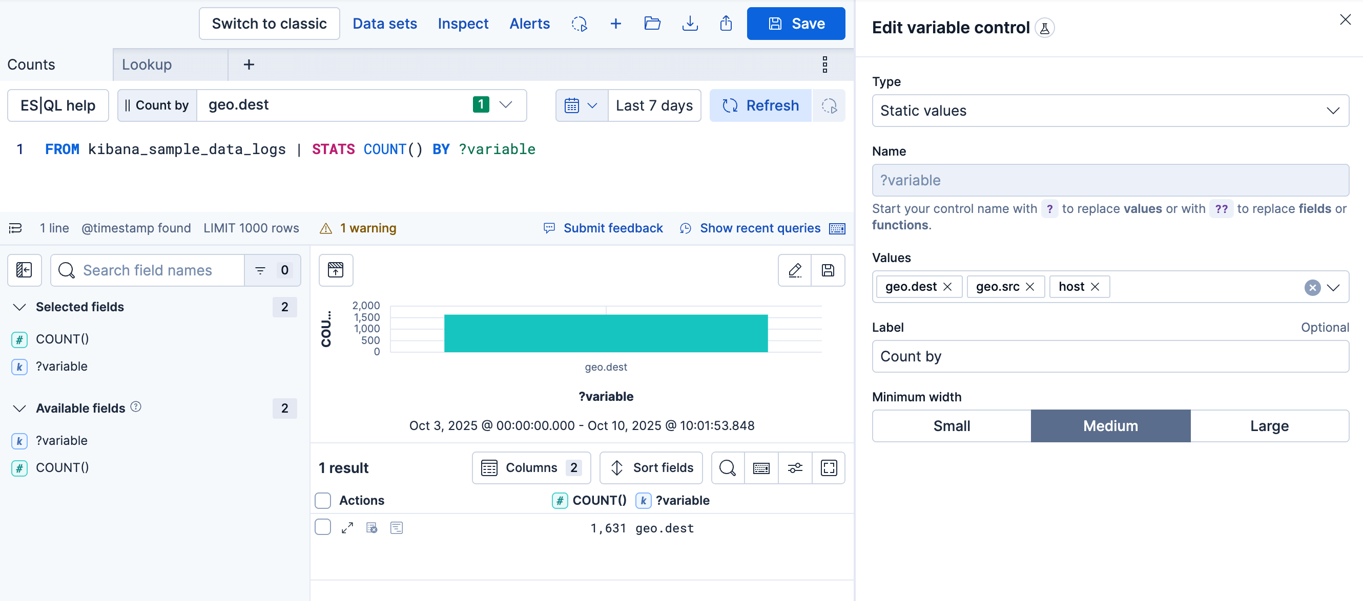

Variable controls help you make your queries more dynamic instead of having to maintain several versions of almost identical queries.
Variable control in Discover
You can add them from your Discover ES|QL query.
  1. While you edit your ES|QL query, the autocomplete menu suggests adding a control when relevant or when you type ? in the query. Select Create control.
    ES|QL query prompting to add a control
  2. A menu opens to let you configure the control. This is where you can specify:
    • The type of the control.
      • For controls with Static values, enter available controls manually or select them from the dropdown list.
      • For controls with Values from a query, write an ES|QL query to populate the list of options. This option is useful for dynamically retrieving control values or perform advanced actions such as defining chaining controls.
        Tip - Only display values available for the selected time range
        By linking the control to the global time range, the control only shows values that exist within the time range selected in the dashboard or Discover session. You can do that by specifying WHERE @timestamp <= ?_tend AND @timestamp > ?_tstart in the control's query, or custom time parameters if your indices don't have a @timestamp field.
    • The name of the control. You use this name to reference the control in ES|QL queries.
      • Start the name with ? if you want the options to be simple static values.
      • Start the name with ?? if you want the options to be fields or functions.
    • The values users can select for this control. You can add multiple values from suggested fields, or type in custom values. If you selected Values from a query, you must instead write an ES|QL query at this step.
    • The label of the control. This is the label displayed in Discover or in the dashboard.
    • The width of the control.
    • Whether the control should allow selecting a single value or multiple values. This requires using the MV_CONTAINS function in your query.
    ES|QL control settings
  3. Save the control.
The variable is inserted into your query, and the control appears.

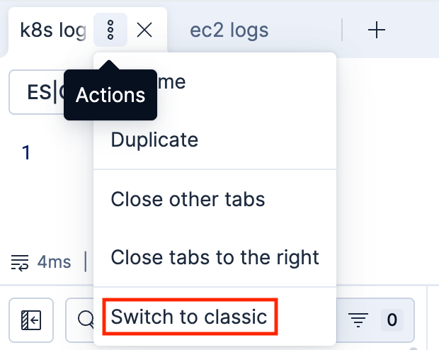

  1. Open the Discover tab that you want to switch to classic mode.
  2. From your tab's contextual menu, select Switch to classic. This affects only the selected Discover tab.
Tab contextual menu with an option to switch from ES|QL to classic mode
Tip
The Switch to classic option only appears for the currently active tab. To see it for another tab, you must load that tab first.
