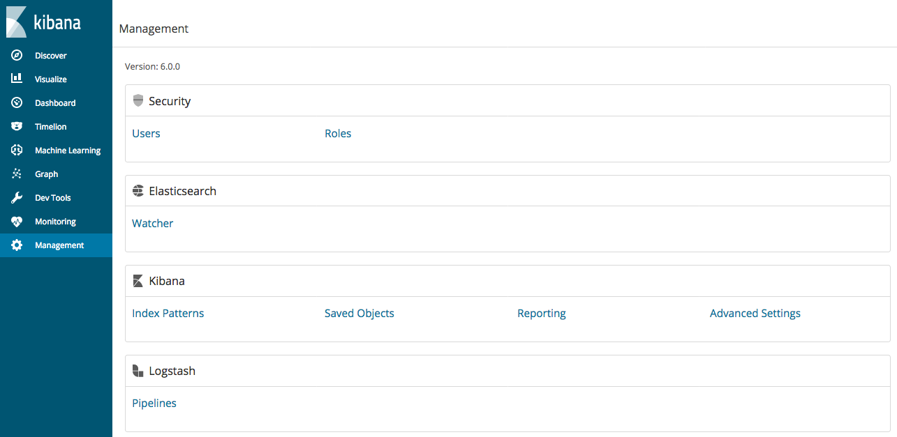

  1. Open Kibana in your browser and go to the Management tab. If you’ve set up configuration management correctly, you’ll see an area for managing Logstash. Click the Pipelines link.
    centralized config

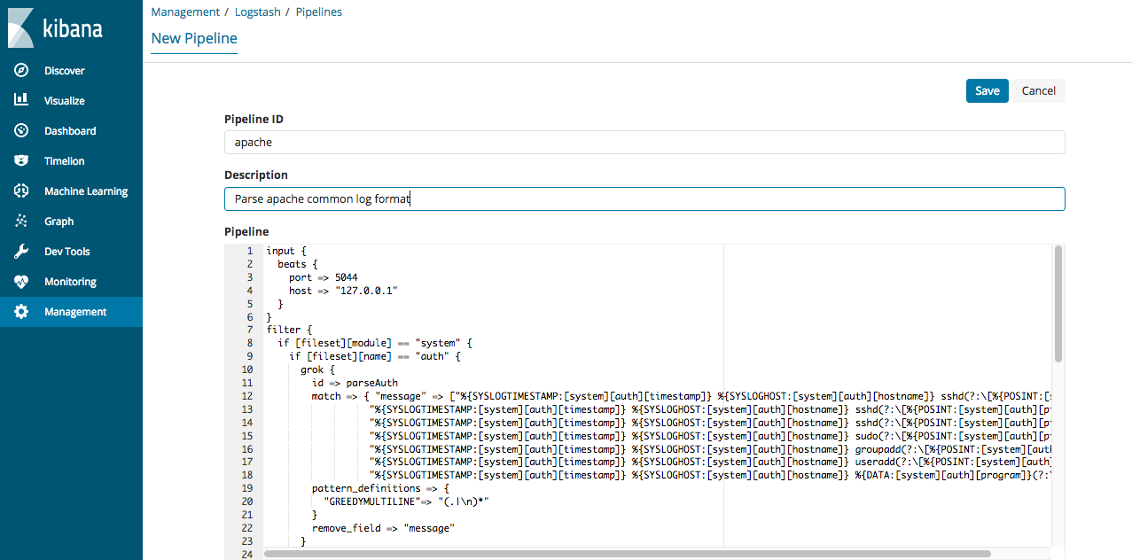

  2. To add a new pipeline, click the Add button and specify values for the following fields:
    Pipeline ID
    A name that uniquely identifies the pipeline. This is the ID that you used when you configured centralized pipeline management and specified a list of pipeline IDs in the xpack.management.pipeline.id setting.
    Description
    A description of the pipeline configuration. This information is for your use.
    Pipeline
    The pipeline configuration. You can treat the editor in the pipeline management UI like any other editor. You don’t have to worry about whitespace or indentation.
    new pipeline
  3. Click Save.
The pipeline runs on all Logstash instances that are registered to use the pipeline. There is no validation done at the UI level. The UI will save the new configuration, and Logstash will attempt to load it. You need to check the local Logstash logs for configuration errors. If you’re using the Logstash monitoring feature in X-Pack, you can also navigate to the Monitoring tab to check the status of your Logstash nodes.
