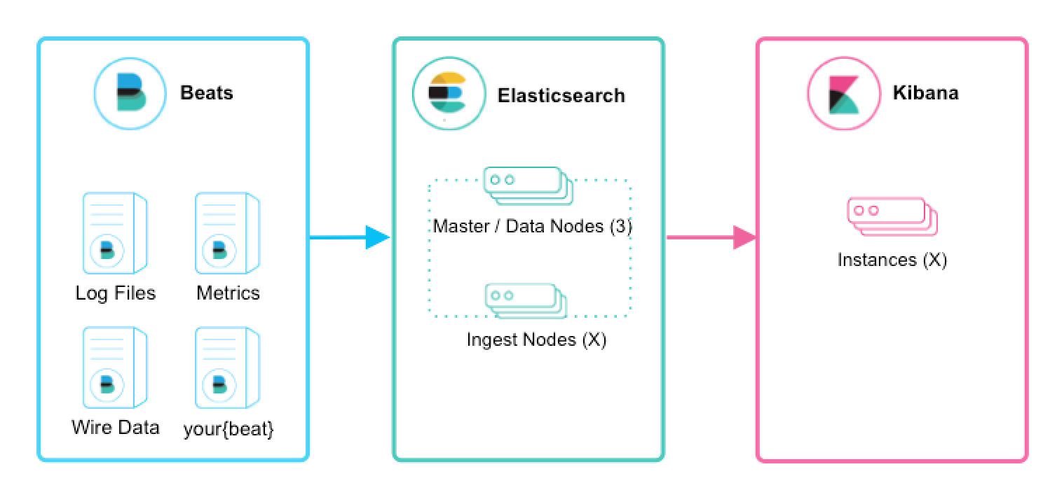

Getting Started
For first time users, if you simply want to tail a log file to grasp the power of the Elastic Stack, we recommend trying Filebeat Modules. Filebeat Modules enable you to quickly collect, parse, and index popular log types and view pre-built Kibana dashboards within minutes. Metricbeat Modules provide a similar experience, but with metrics data. In this context, Beats will ship data directly to Elasticsearch where Ingest Nodes will process and index your data.

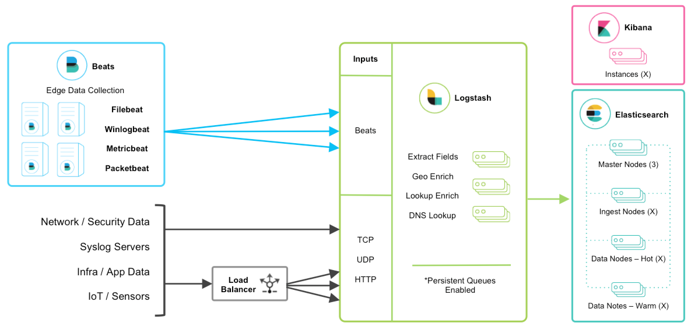

Beats and Logstash
Beats run across thousands of edge host servers, collecting, tailing, and shipping logs to Logstash. Logstash serves as the centralized streaming engine for data unification and enrichment. The Beats input plugin exposes a secure, acknowledgement-based endpoint for Beats to send data to Logstash.

TCP, UDP, and HTTP Protocols
The TCP, UDP, and HTTP protocols are common ways to feed data into Logstash. Logstash can expose endpoint listeners with the respective TCP, UDP, and HTTP input plugins. The data sources enumerated below are typically ingested through one of these three protocols.
The TCP and UDP protocols do not support application-level acknowledgements, so connectivity issues may result in data loss.
For high availability scenarios, a third-party hardware or software load balancer, like HAProxy, should be added to fan out traffic to a group of Logstash nodes.

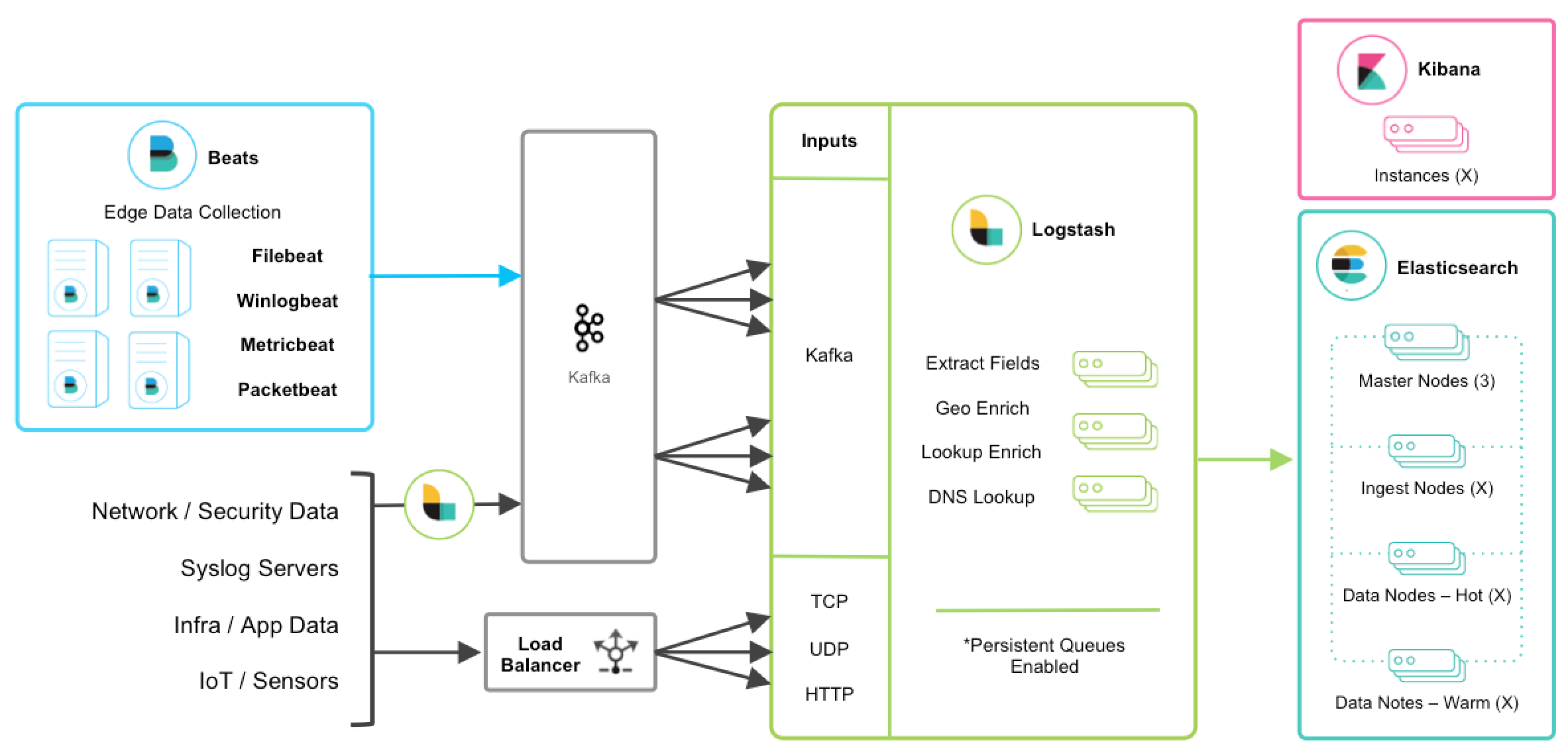

Integrating with Messaging Queues
If you are leveraging message queuing technologies as part of your existing infrastructure, getting that data into the Elastic Stack is easy. For existing users who are utilizing an external queuing layer like Redis or RabbitMQ just for data buffering with Logstash, it’s recommended to use Logstash persistent queues instead of an external queuing layer. This will help with overall ease of management by removing an unnecessary layer of complexity in your ingest architecture.
For users who want to integrate data from existing Kafka deployments or require the underlying usage of ephemeral storage, Kafka can serve as a data hub where Beats can persist to and Logstash nodes can consume from.
deploy4
The other TCP, UDP, and HTTP sources can persist to Kafka with Logstash as a conduit to achieve high availability in lieu of a load balancer. A group of Logstash nodes can then consume from topics with the Kafka input to further transform and enrich the data in transit.
