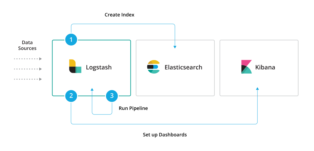

Each module comes pre-packaged with Logstash configurations, Kibana dashboards, and other meta files that make it easier for you to set up the Elastic Stack for specific use cases or data sources.
You can think of modules as providing three essential functions that make it easier for you to get started. When you run a module, it will:
  1. Create the Elasticsearch index.
  2. Set up the Kibana dashboards, including the index pattern, searches, and visualizations required to visualize your data in Kibana.
  3. Run the Logstash pipeline with the configurations required to read and parse the data.
