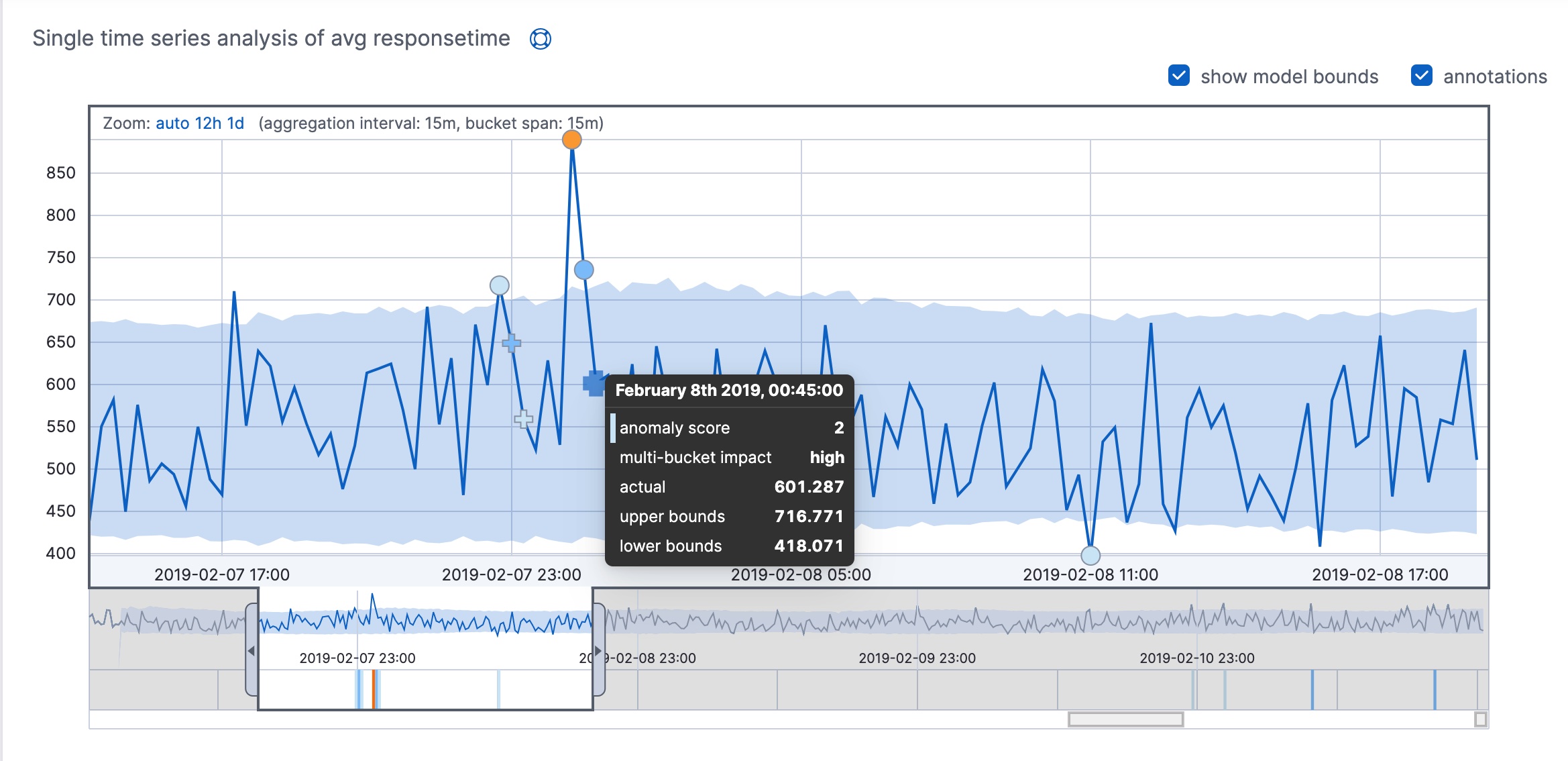

score is influenced by multi-bucket analysis. In Kibana, anomalies with medium or
high multi-bucket impact are depicted in the Anomaly Explorer and the
Single Metric Viewer with a cross symbol instead of a dot. For example:
![Examples of anomalies with multi-bucket impact in Kibana](images/multibucketanalysis.jpg)
In this example, you can see that some of the anomalies fall within the shaded blue area, which represents the bounds for the expected values. The bounds are calculated per bucket, but multi-bucket analysis is not limited by that scope.

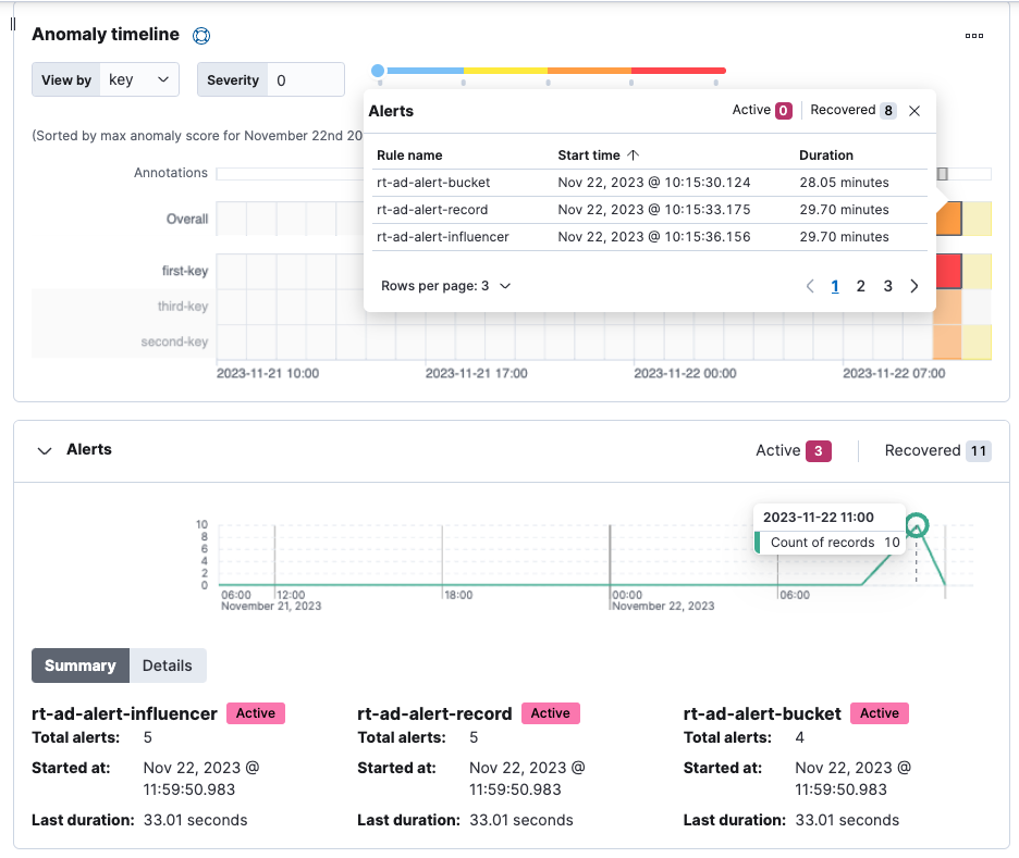

If you have Anomaly detection alert rules applied to an anomaly detection job and an alert has occured for the rule, you can view how the alert correlates with the anomaly detection results in the Anomaly Explorer by using the Anomaly timeline swimlane and the Alerts panel. The Alerts panel contains a line chart with the alerts count over time. The cursor on the line chart is in sync with the anomaly swimlane making it easier to review anomalous buckets with the spike produced by the alerts. The panel also contains aggregated information for each alert rule associated with the job selection such as the total number of active, recovered, and untracked alerts for the selected job and time range. An alert context menu is displayed when an anomaly swimlane cell is selected with alerts in the chosen time range. The context menu contains the alert counters for the selected time buckets.
![Alerts table in the Anomaly Explorer](images/anomaly-explorer-alerts.png)

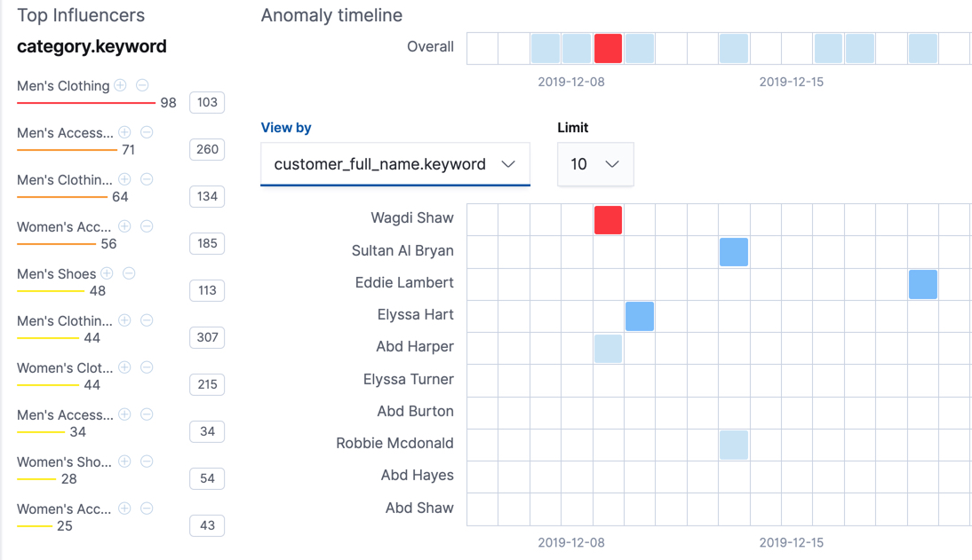

![Influencers in the Kibana Anomaly Explorer](images/influencers.jpg)
On the left is a list of the top influencers for all of the detected anomalies in that same time period. The list includes maximum anomaly scores, which in this case are aggregated for each influencer, for each bucket, across all detectors. There is also a total sum of the anomaly scores for each influencer. You can use this list to help you narrow down the contributing factors and focus on the most anomalous entities.
You can also explore swim lanes that correspond to the values of an influencer.
In this example, the swim lanes correspond to the values for the
customer_full_name.keyword
. By default, the swim lanes are sorted according to
which entity has the maximum anomaly score values. You can click on the sections
in the swim lane to see details about the anomalies that occurred in that time
interval.
The anomaly scores that you see in each section of the Anomaly Explorer might differ slightly. This disparity occurs because for each anomaly detection job, there are bucket results, influencer results, and record results. Anomaly scores are generated for each type of result. The anomaly timeline in Kibana uses the bucket-level anomaly scores. If you view swim lanes by influencer, it uses the influencer-level anomaly scores, as does the list of top influencers. The list of anomalies uses the record-level anomaly scores.
