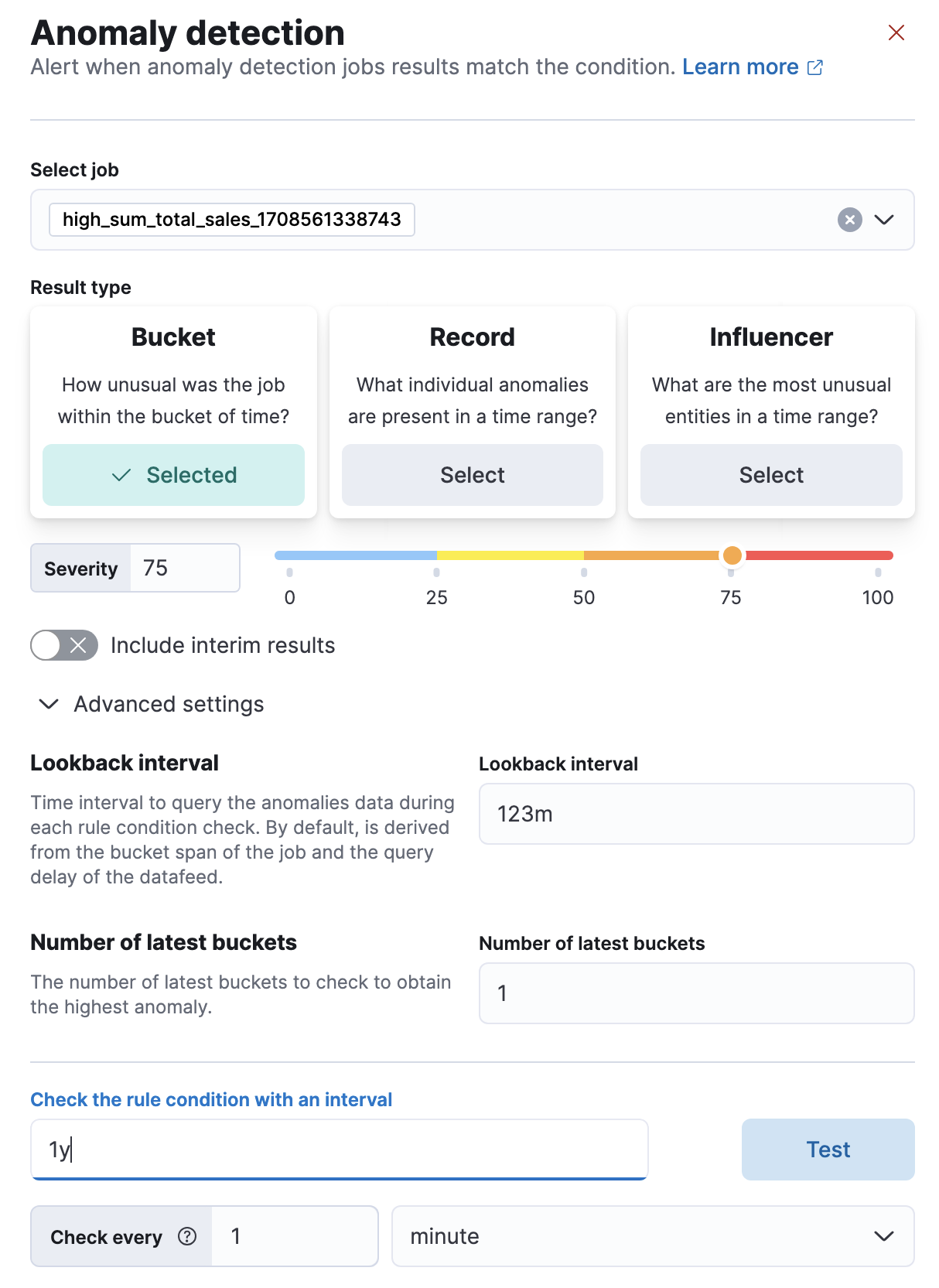

When you create an anomaly detection alert rule, you must select the job that the rule applies to.
You must also select a type of machine learning result. In particular, you can create rules based on bucket, record, or influencer results.
![Selecting result type, severity, and test interval](images/ml-anomaly-alert-severity.png)
For each rule, you can configure the anomaly_score
that triggers the action.
The anomaly_score
indicates the significance of a given anomaly compared to
previous anomalies. The default severity threshold is 75 which means every
anomaly with an anomaly_score
of 75 or higher triggers the associated action.
You can select whether you want to include interim results. Interim results are created by the anomaly detection job before a bucket is finalized. These results might disappear after the bucket is fully processed. Include interim results if you want to be notified earlier about a potential anomaly even if it might be a false positive. If you want to get notified only about anomalies of fully processed buckets, do not include interim results.
You can also configure advanced settings. Lookback interval sets an interval that is used to query previous anomalies during each condition check. Its value is derived from the bucket span of the job and the query delay of the datafeed by default. It is not recommended to set the lookback interval lower than the default value as it might result in missed anomalies. Number of latest buckets sets how many buckets to check to obtain the highest anomaly from all the anomalies that are found during the Lookback interval. An alert is created based on the anomaly with the highest anomaly score from the most anomalous bucket.
You can also test the configured conditions against your existing data and check the sample results by providing a valid interval for your data. The generated preview contains the number of potentially created alerts during the relative time range you defined.
You must also provide a check interval that defines how often to evaluate the rule conditions. It is recommended to select an interval that is close to the bucket span of the job.

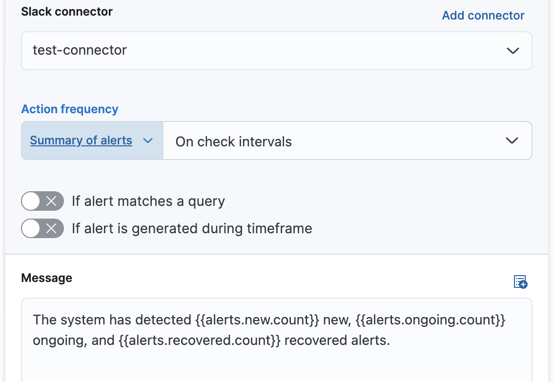

After you select a connector, you must set the action frequency. You can choose to create a summary of alerts on each check interval or on a custom interval. For example, send slack notifications that summarize the new, ongoing, and recovered alerts:
![Adding an alert summary action to the rule](images/ml-anomaly-alert-action-summary.png)
If you choose a custom action interval, it cannot be shorter than the rule’s check interval.

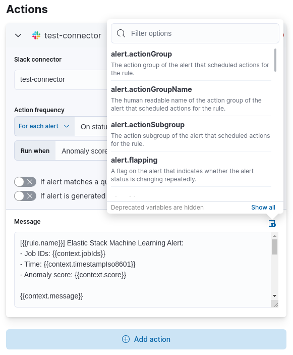

Alternatively, you can set the action frequency such that actions run for each alert. Choose how often the action runs (at each check interval, only when the alert status changes, or at a custom action interval). For anomaly detection alert rules, you must also choose whether the action runs when the anomaly score matches the condition or when the alert recovers:
![Adding an action for each alert in the rule](images/ml-anomaly-alert-action-score-matched.png)

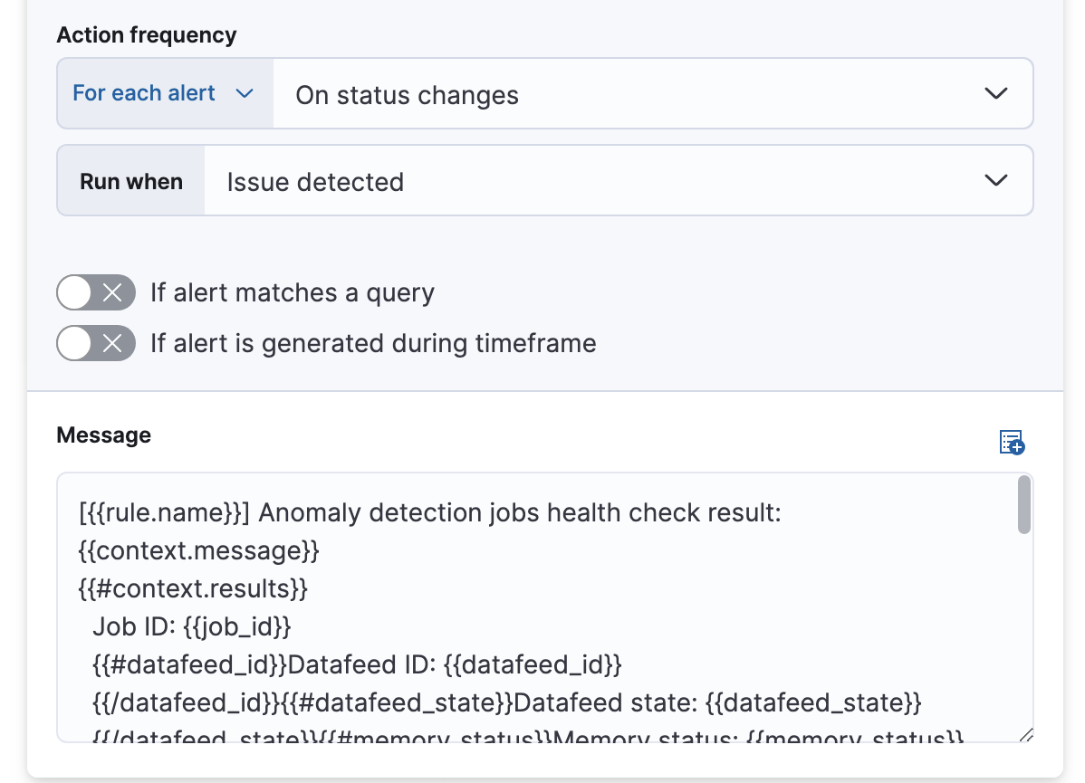

In anomaly detection jobs health rules, choose whether the action runs when the issue is detected or when it is recovered:
![Adding an action for each alert in the rule](images/ml-health-check-action.png)

There is a set of variables that you can use to customize the notification messages for each action. Click the icon above the message text box to get the list of variables or refer to Action variables. For example:
![Customizing your message](images/ml-anomaly-alert-messages.png)
