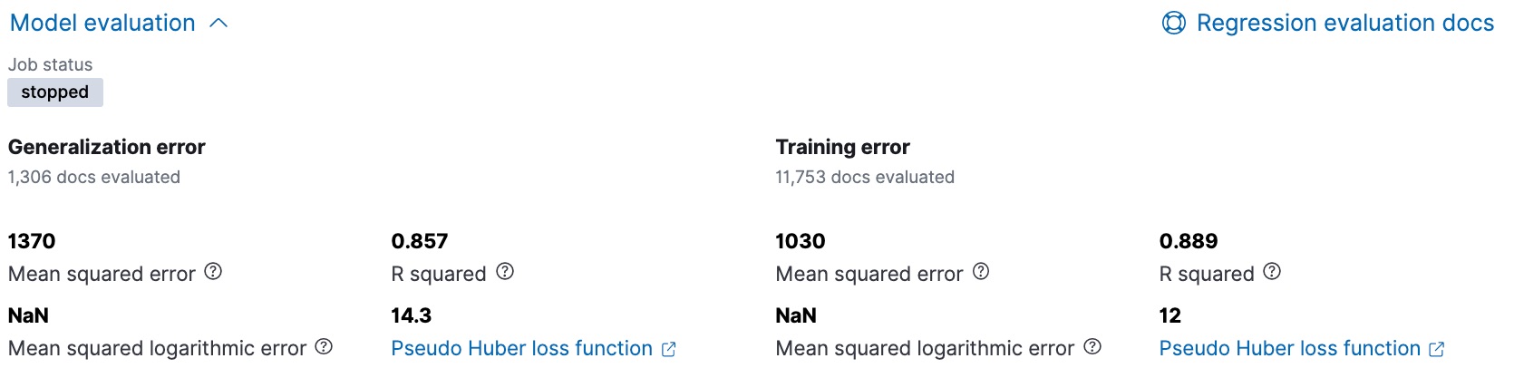

You can measure how well the model has performed on your training data by using the regression evaluation type of the evaluate data frame analytics API. The mean squared error (MSE) value that the evaluation provides you on the training data set is the training error. Training and evaluating the model iteratively means finding the combination of model parameters that produces the lowest possible training error.
Another crucial measurement is how well your model performs on unseen data. To assess how well the trained model will perform on data it has never seen before, you must set aside a proportion of the training set for testing (testing data). Once the model is trained, you can let it predict the value of the data points it has never seen before and compare the prediction to the actual value. This test provides an estimate of a quantity known as the model generalization error.
The regression evaluation type offers the following metrics to evaluate the model performance:
  • Mean squared error (MSE)
  • Mean squared logarithmic error (MSLE)
  • Pseudo-Huber loss
  • R-squared (R2)
Mean squared error
MSE is the average squared sum of the difference between the true value and the predicted value. (Avg (predicted value-actual value)2).
MSLE is a variation of mean squared error. It can be used for cases when the target values are positive and distributed with a long tail such as data on prices or population. Consult the Loss functions for regression analyses page to learn more about loss functions.
Pseudo-Huber loss
Pseudo-Huber loss metric behaves as mean absolute error (MAE) for errors larger than a predefined value (defaults to 1) and as mean squared error (MSE) for errors smaller than the predefined value. This loss function uses the delta parameter to define the transition point between MAE and MSE. Consult the Loss functions for regression analyses page to learn more about loss functions.
R-squared
R-squared (R2) represents the goodness of fit and measures how much of the variation in the data the predictions are able to explain. The value of R2 are less than or equal to 1, where 1 indicates that the predictions and true values are equal. A value of 0 is obtained when all the predictions are set to the mean of the true values. A value of 0.5 for R2 would indicate that the predictions are 1 - 0.5(1/2) (about 30%) closer to true values than their mean.

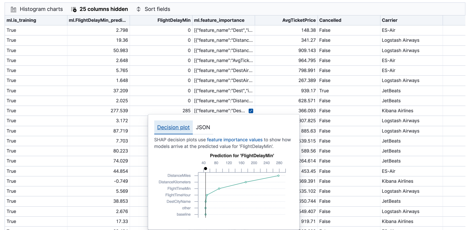

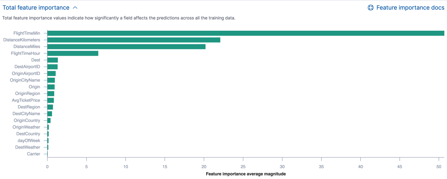

Feature importance
Feature importance provides further information about the results of an analysis and helps to interpret the results in a more subtle way. If you want to learn more about feature importance, click here.

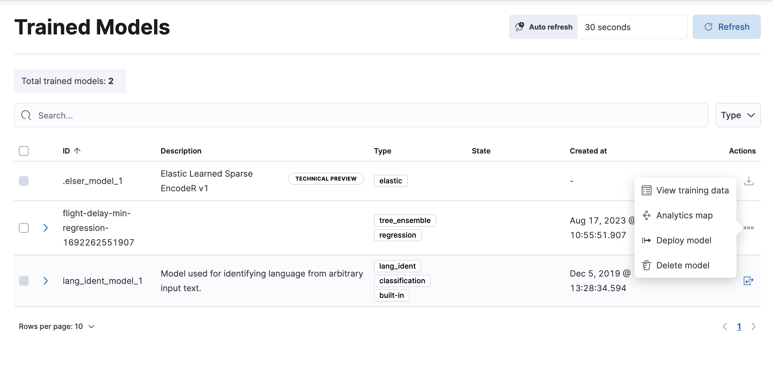

The model that you created is stored as Elasticsearch documents in internal indices. In other words, the characteristics of your trained model are saved and ready to be deployed and used as functions. The inference feature enables you to use your model in a preprocessor of an ingest pipeline or in a pipeline aggregation of a search query to make predictions about your data.

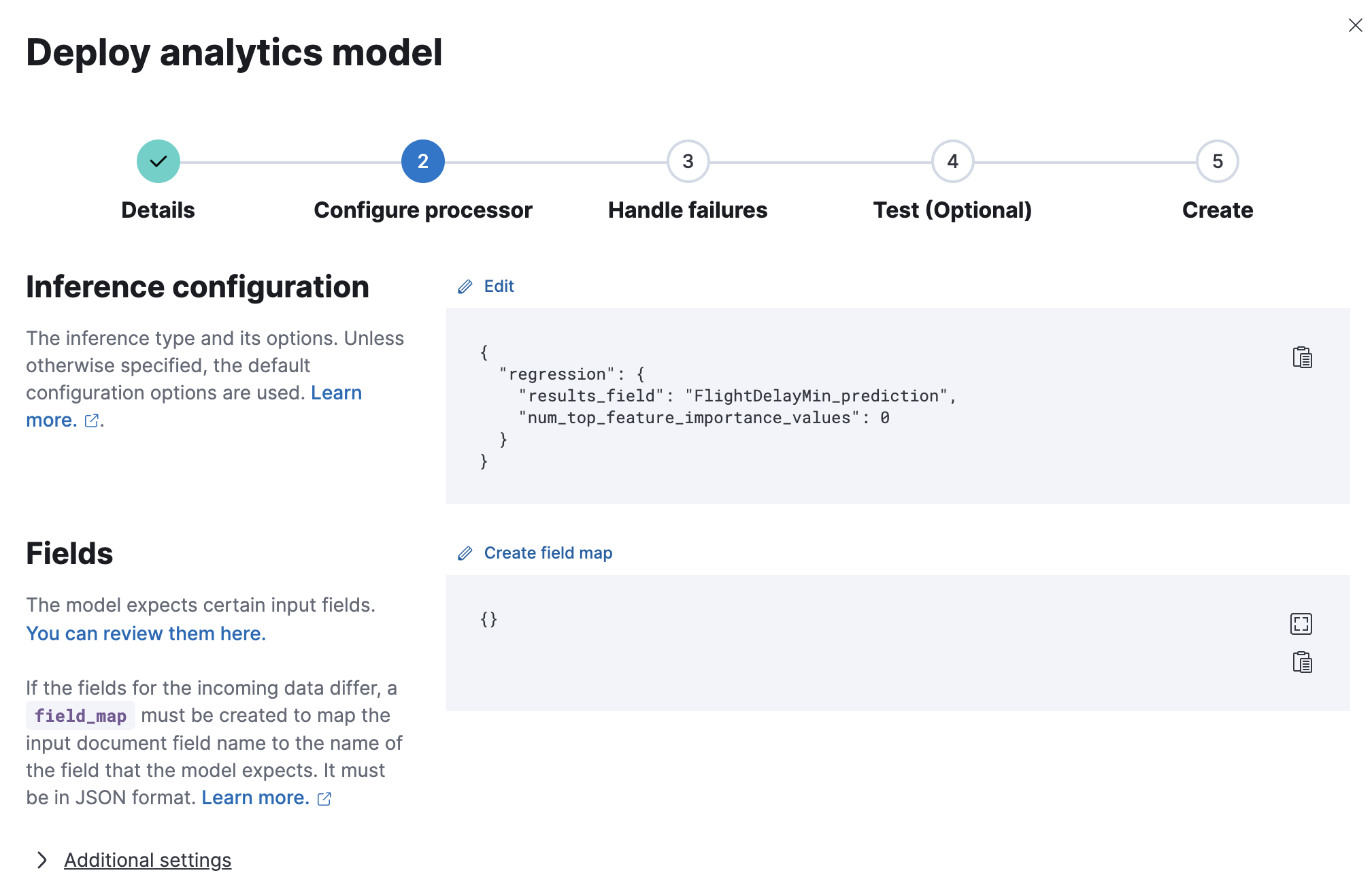

  1. To deploy data frame analytics model in a pipeline, navigate to Machine Learning > Model Management > Trained models in the main menu, or use the global search field in Kibana.
  2. Find the model you want to deploy in the list and click Deploy model in the Actions menu.
    The trained models UI in Kibana

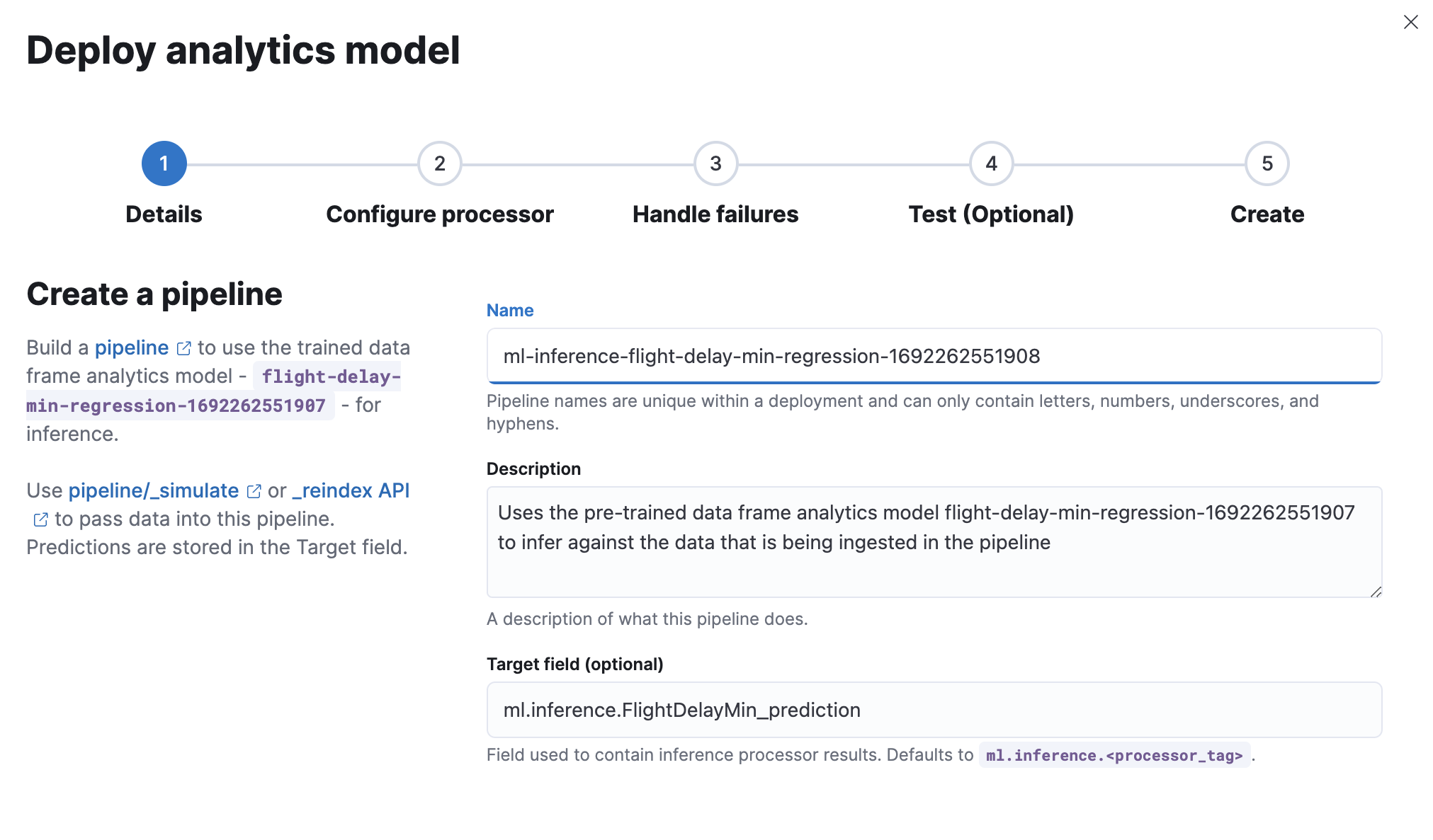

  3. Create an inference pipeline to be able to use the model against new data through the pipeline. Add a name and a description or use the default values.
    Creating an inference pipeline
  4. Configure the pipeline processors or use the default settings.
    Configuring an inference processor
  5. Configure to handle ingest failures or use the default settings.
  6. (Optional) Test your pipeline by running a simulation of the pipeline to confirm it produces the anticipated results.
  7. Review the settings and click Create pipeline.
The model is deployed and ready to use through the inference pipeline.

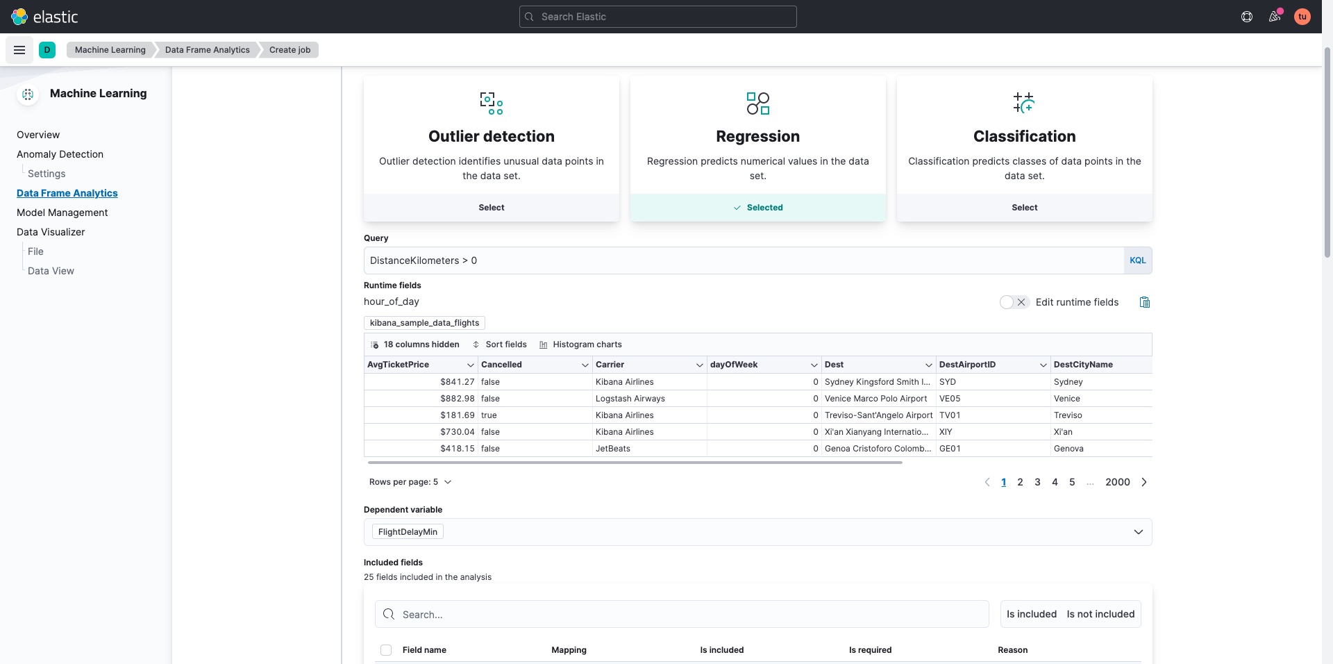

  2. Create a data frame analytics job.
    You can use the wizard on the Machine Learning > Data Frame Analytics tab in Kibana or the create data frame analytics jobs API.

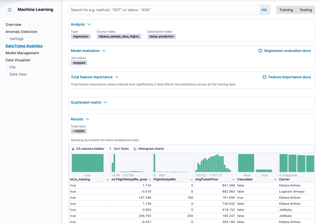

    Creating a data frame analytics job in Kibana
    1. Choose kibana_sample_data_flights as the source index.
    2. Choose regression as the job type.
    3. Optionally improve the quality of the analysis by adding a query that removes erroneous data. In this case, we omit flights with a distance of 0 kilometers or less.
    4. Choose FlightDelayMin as the dependent variable, which is the field that we want to predict.
    5. Add Cancelled, FlightDelay, and FlightDelayType to the list of excluded fields. These fields will be excluded from the analysis. It is recommended to exclude fields that either contain erroneous data or describe the dependent_variable.

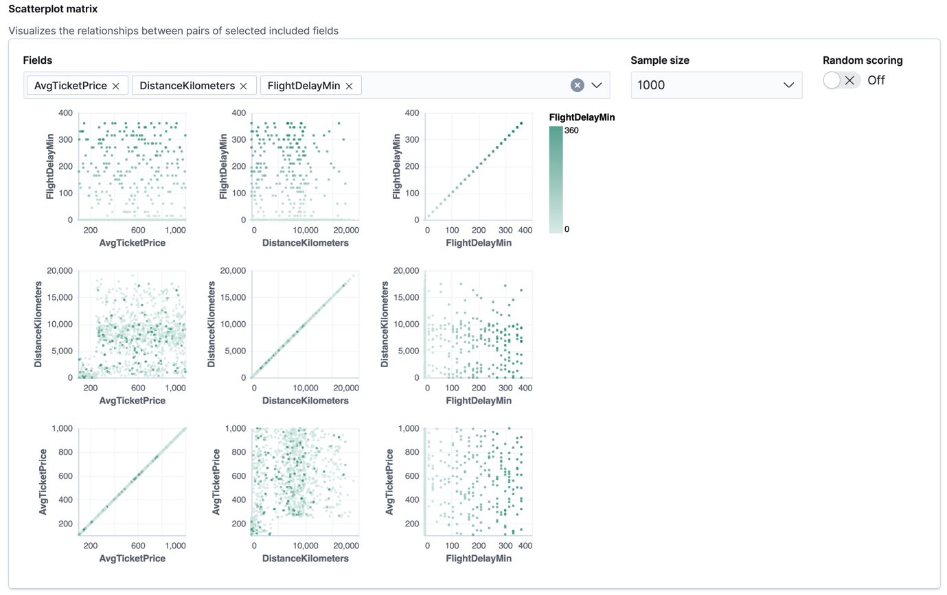

      The wizard includes a scatterplot matrix, which enables you to explore the relationships between the numeric fields. The color of each point is affected by the value of the dependent variable for that document, as shown in the legend. You can highlight an area in one of the charts and the corresponding area is also highlighted in the rest of the chart. You can use this matrix to help you decide which fields to include or exclude from the analysis.
      A scatterplot matrix for three fields in Kibana
      If you want these charts to represent data from a larger sample size or from a randomized selection of documents, you can change the default behavior. However, a larger sample size might slow down the performance of the matrix and a randomized selection might put more load on the cluster due to the more intensive query.
    6. Choose a training percent of 90 which means it randomly selects 90% of the source data for training.
    7. If you want to experiment with feature importance, specify a value in the advanced configuration options. In this example, we choose to return a maximum of 5 feature importance values per document. This option affects the speed of the analysis, so by default it is disabled.
    8. Use a model memory limit of at least 50 MB. If the job requires more than this amount of memory, it fails to start. If the available memory on the node is limited, this setting makes it possible to prevent job execution.
    9. Add a job ID (such as model-flight-delay-regression) and optionally a job description.
    10. Add the name of the destination index that will contain the results of the analysis. In Kibana, the index name matches the job ID by default. It will contain a copy of the source index data where each document is annotated with the results. If the index does not exist, it will be created automatically.

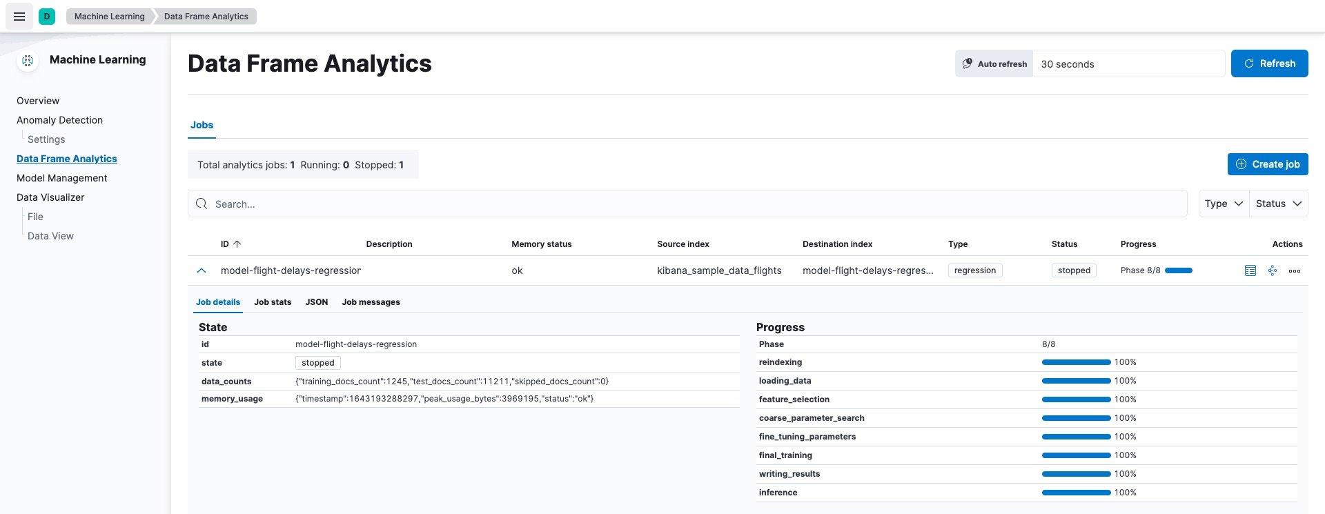

  4. Check the job stats to follow the progress in Kibana or use the get data frame analytics jobs statistics API.
    Statistics for a data frame analytics job in Kibana
    When the job stops, the results are ready to view and evaluate. To learn more about the job phases, see How data frame analytics jobs work.

Now you have a new index that contains a copy of your source data with predictions for your dependent variable.
When you view the results in Kibana, it shows the contents of the destination index in a tabular format. It also provides information about the analysis details, model evaluation metrics, total feature importance values, and a scatterplot matrix. Let’s start by looking at the results table:
Results for a data frame analytics job in Kibana
In this example, the table shows a column for the dependent variable (FlightDelayMin), which contains the ground truth values that we are trying to predict. It also shows a column for the prediction values (ml.FlightDelayMin_prediction) and a column that indicates whether the document was used in the training set (ml.is_training). You can filter the table to show only testing or training data and you can select which fields are shown in the table. You can also enable histogram charts to get a better understanding of the distribution of values in your data.
If you chose to calculate feature importance, the destination index also contains ml.feature_importance objects. Every field that is included in the regression analysis (known as a feature of the data point) is assigned a feature importance value. This value has both a magnitude and a direction (positive or negative), which indicates how each field affects a particular prediction. Only the most significant values (in this case, the top 5) are stored in the index. However, the trained model metadata also contains the average magnitude of the feature importance values for each field across all the training data. You can view this summarized information in Kibana:
Total feature importance values in Kibana
You can also see the feature importance values for each individual prediction in the form of a decision plot:
A decision plot for feature importance values in Kibana
The decision path starts at a baseline, which is the average of the predictions for all the data points in the training data set. From there, the feature importance values are added to the decision path until it arrives at its final prediction. The features with the most significant positive or negative impact appear at the top. Thus in this example, the features related to the flight distance had the most significant influence on this particular predicted flight delay. This type of information can help you to understand how models arrive at their predictions. It can also indicate which aspects of your data set are most influential or least useful when you are training and tuning your model.
If you do not use Kibana, you can see summarized feature importance values by using the get trained model API and the individual values by searching the destination index.

To see the top feature importance values for each prediction, search the destination index. For example:
GET model-flight-delays-regression/_search
The snippet below shows a part of a document with the annotated results:
          "DestCountry" : "CH",
          "DestRegion" : "CH-ZH",
          "OriginAirportID" : "VIE",
          "DestCityName" : "Zurich",
          "ml": {
            "FlightDelayMin_prediction": 277.5392150878906,
            "feature_importance": [
              "feature_name": "DestCityName",
              "importance": 0.6285966753441136
              "feature_name": "DistanceKilometers",
              "importance": 84.4982943868267
              "feature_name": "DistanceMiles",
              "importance": 103.90011847132116
              "feature_name": "FlightTimeHour",
              "importance": 3.7119156097309345
              "feature_name": "FlightTimeMin",
              "importance": 38.700587425831365
            "is_training": true
Lastly, Kibana provides a scatterplot matrix in the results. It has the same functionality as the matrix that you saw in the job wizard. Its purpose is to likewise help you visualize and explore the relationships between the numeric fields and the dependent variable in your data.
Evaluating regression results
Though you can look at individual results and compare the predicted value (ml.FlightDelayMin_prediction) to the actual value (FlightDelayMins), you typically need to evaluate the success of the regression model as a whole.
Kibana provides training error metrics, which represent how well the model performed on the training data set. It also provides generalization error metrics, which represent how well the model performed on testing data.
Evaluating regression analysis results in Kibana
A mean squared error (MSE) of zero means that the models predicts the dependent variable with perfect accuracy. This is the ideal, but is typically not possible. Likewise, an R-squared value of 1 indicates that all of the variance in the dependent variable can be explained by the feature variables. Typically, you compare the MSE and R-squared values from multiple regression models to find the best balance or fit for your data.
For more information about the interpreting the evaluation metrics, see 6. Evaluate the result.
You can alternatively generate these metrics with the data frame analytics evaluate API.

The API returns a response like this:
  "regression" : {
    "huber" : {
      "value" : 30.216037330465102
    "mse" : {
      "value" : 2847.2211476422967
    "msle" : {
      "value" : "NaN"
    "r_squared" : {
      "value" : 0.6956530017255125
Next, we calculate the generalization error:
POST _ml/data_frame/_evaluate
 "index": "model-flight-delays-regression",
  "query": {
      "bool": {
        "filter": [{ "term":  { "ml.is_training": false } }]
 "evaluation": {
   "regression": {
     "actual_field": "FlightDelayMin",
     "predicted_field": "ml.FlightDelayMin_prediction",
     "metrics": {
       "r_squared": {},
       "mse": {},
       "msle": {},
       "huber": {}
Evaluates only the documents that are not part of the training data.
When you have trained a satisfactory model, you can deploy it to make predictions about new data.
