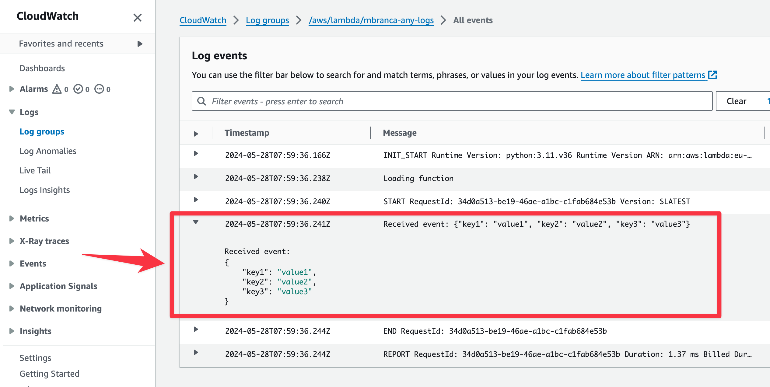

Generate some sample logs
With the function ready to go, you can invoke it a few times to generate sample logs. On the function page, follow these steps:
- Select Test.
- Select the option to create a new test event.
- Name the test event and Save the changes.
- Click the Test button to execute the function.
Visit the function’s log group. Usually, the AWS console offers a handy link to jump straight to the log group it created for this function’s logs. You should get something similar to the following:
Take note of the log group name for this Lambda function, as you will need it in the next steps.

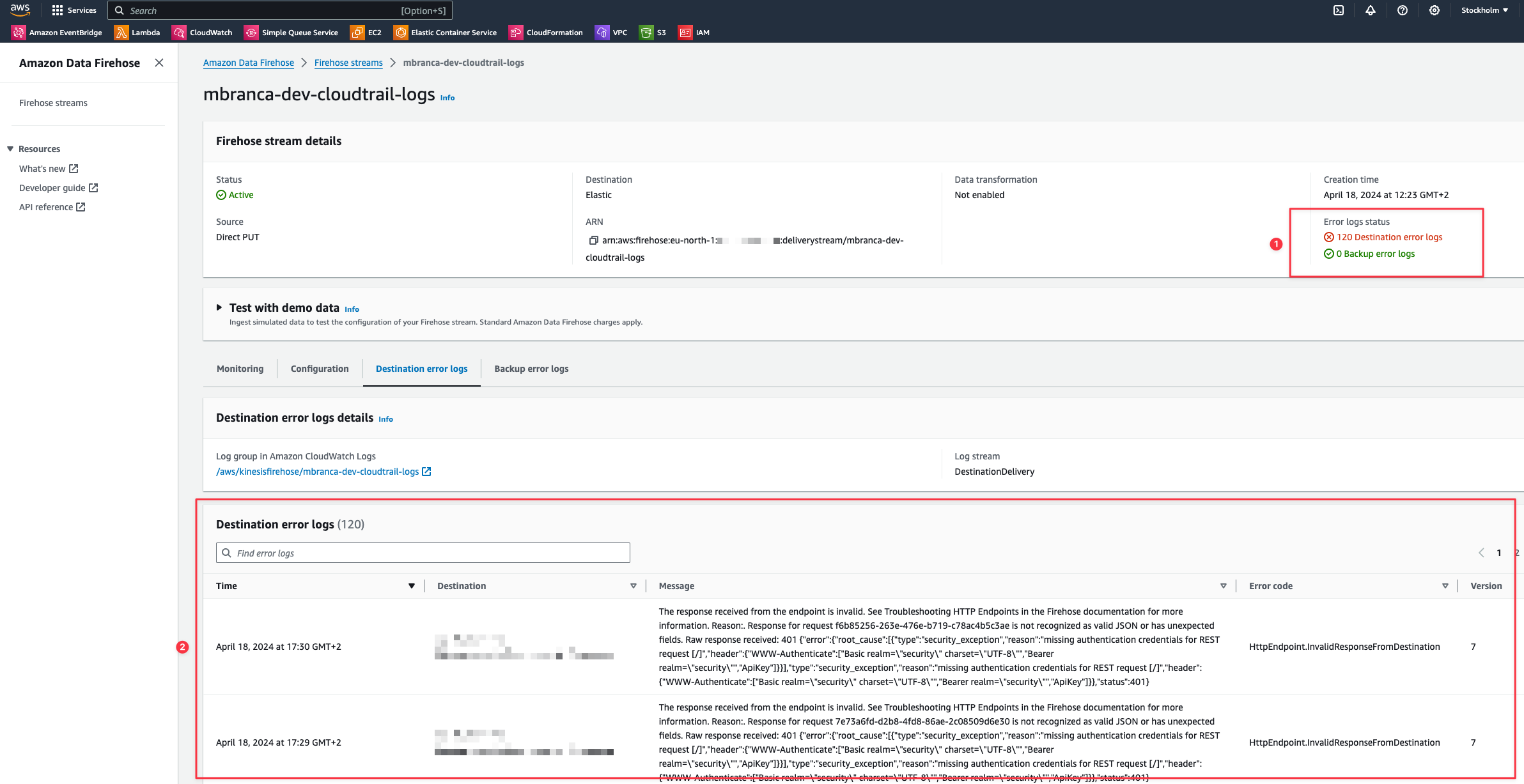

Check if there are destination error logs
On the AWS console, navigate to your Firehose stream and check for entries in the Destination error logs section.
If everything is running smoothly, this list is empty. If there’s an error, you can check the details. The following example shows a delivery stream that fails to send records to the Elastic stack due to bad authentication settings:
The Firehose delivery stream reports:
- The number of failed deliveries.
- The failure detail.

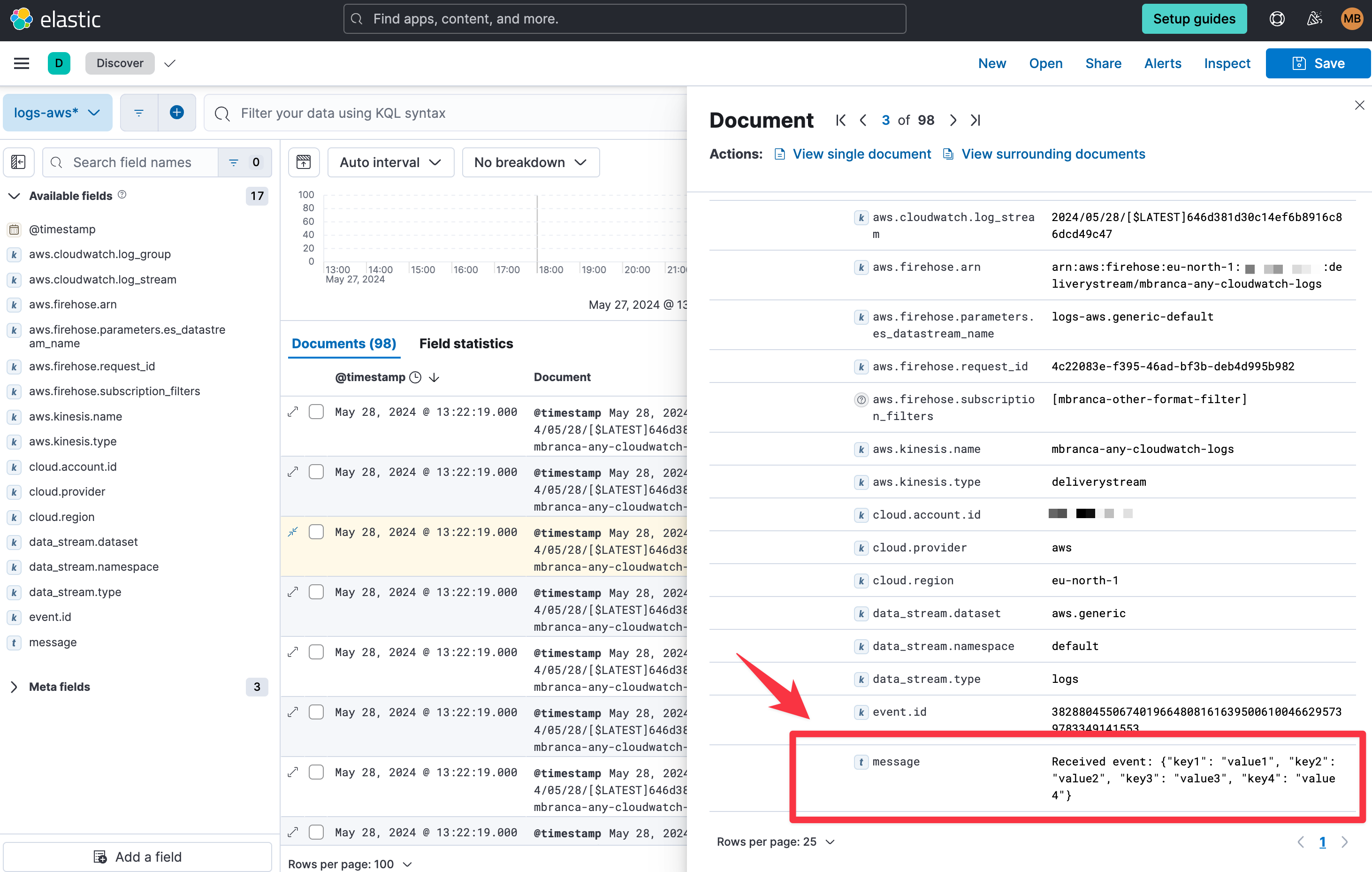

Step 5: Visualize your logs in Kibana
With the logs streaming to the Elastic stack, you can now visualize them in Kibana.
In Kibana, navigate to the Discover page and select the index pattern that matches the Firehose stream name. Here is a sample of logs from the Lambda function you forwarded to the logs-aws.generic-default
data stream:
