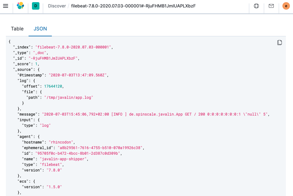

Send data to Elasticsearch
To send data to Elasticsearch, start Filebeat.
sudo service filebeat start
If you use an init.d script to start Filebeat, you can’t specify command line flags (see Command reference). To specify flags, start Filebeat in the foreground.

    There is a summary of the documents at the top, but let’s take a look at a single document.
    Kibana single document view
    You can see that a lot more data is indexed than just the event. There is information about the offset in the file, information about the component shipping the logs, the name of the shipper’s name in the output, and there is a message field containing log line contents.
    You can see there is a flaw in the request logging. If the user agent is null, something other than null is returned. Reading our logs is crucial; however, just indexing them gains us nothing. To fix this, here is a new request logger.

    Looking at one of the documents being indexed, you can see that the log message is contained in a single field. Verify this by looking at one of those documents.
    GET filebeat-*/_search
      "size": 1
    Things to note:
    • When you compare the @timestamp field with the timestamp of the log message, you will notice that it differs. This means that you don’t get the results you expect when filtering based on the @timestamp field. The current @timestamp field reflects the timestamp when the event was created within Filebeat, not the timestamp of when the log event occurred in the application.
    • One cannot filter on specific fields like the HTTP verb, the HTTP status code, the log level or the class that generated the log message

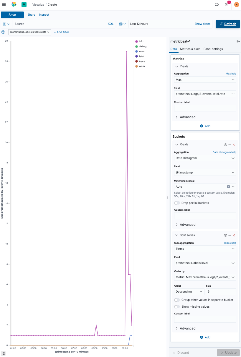

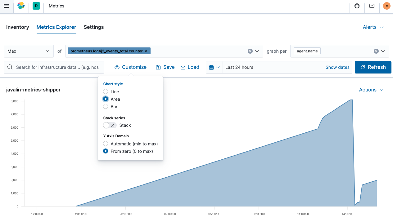

Step 5: Ingest metrics
A metric is considered a point in time value that can change anytime. The number of current requests can change any millisecond. You could have a spike of 1000 requests, and then everything goes back to one request. This also means that these kinds of metrics may not be accurate, and you also want to pull min/max values to get some more indication. Furthermore, this implies that you need to think about the duration of those metrics as well. Do you need those once per minute or every 10 seconds?
To get a different angled view of your application, let’s ingest some metrics. In this example, we will use the Metricbeat Prometheus Module to send data to Elasticsearch.
The underlying library used in our app is micrometer.io, a vendor-neutral application metrics facade in combination with its Prometheus support to implement a pull-based model. You could use the elastic support to achieve a push-based model. This would require users to store credential data of the Elasticsearch cluster in our app. This example keeps this data in the surrounding tools.

Visualize the number of log messages over time, split by the log level. Since the Elastic Stack 7.7, there is a new way of creating a visualization called Lens.
  1. Log into Kibana and select VisualizeCreate Visualization.
  2. Create a line chart and select metricbeat-* as the source.
    The basic idea is to have a max aggregation on the y-axis on the prometheus.log4j2_events_total.rate field, whereas the x-axis, is split by date using a date_histogram aggregation on the @timestamp field.
    There is one more split within each date histogram bucket, split by log level, using a terms aggregation on the prometheus.labels.level, which contains the log level. Also, increase the size of the log level to six to display every log level.
    The final result looks like this.

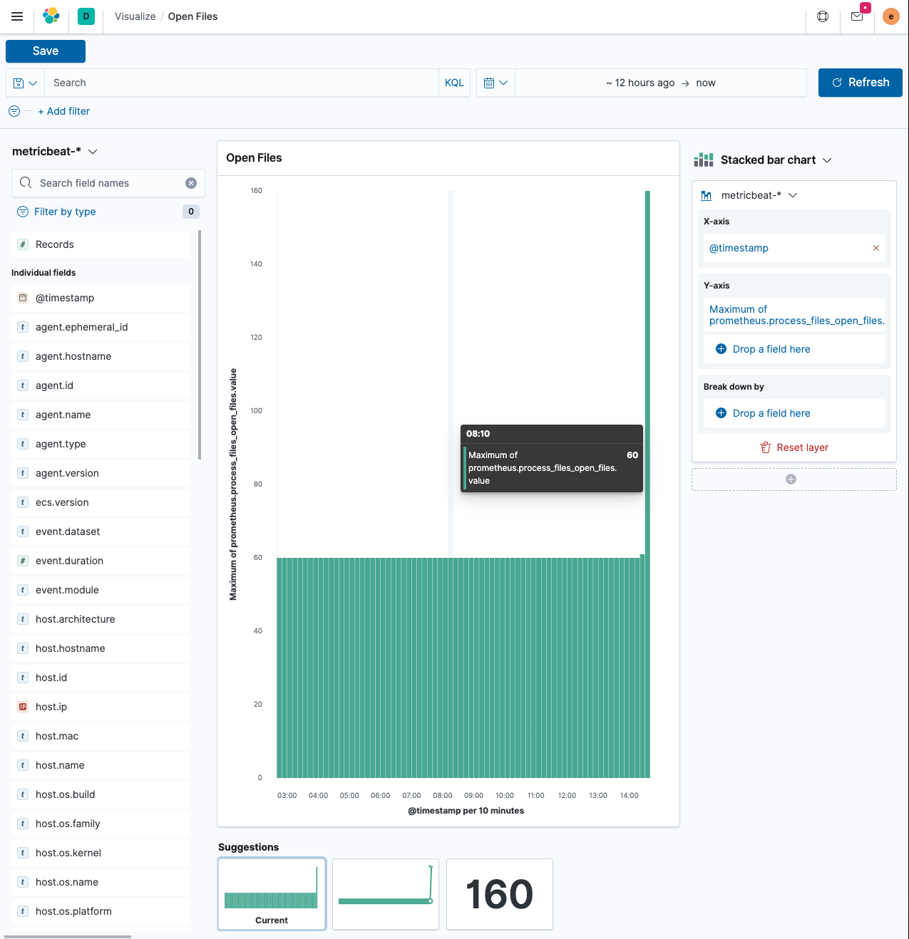

The second visualization is to be a check for the number of open files in our application.
As no one can remember all the field names, let’s again look at the metrics output again first.
curl -s localhost:7000/metrics -u metrics:secret | grep ^process
process_files_max_files 10240.0
process_cpu_usage 1.8120711232436825E-4
process_uptime_seconds 72903.726
process_start_time_seconds 1.594048883317E9
process_files_open_files 61.0
Let’s look at the process_files_open_files metric. This should be a rather static value that rarely changes. If you run an application which stores data within the JVM or opens and closes network sockets, this metric increases and decreases depending on the load. With a web application, this is rather static. Let’s figure out why there are 60 files open on our small web application.
  1. Run jps that will contain your App in the process list.
    $ jps
    14224 Jps
    82437 Launcher
    82438 App
    40895
  2. Use lsof on that process.
    $ lsof -p 82438
    You will see more output than just all the files being opened, as a file is also a TCP connection happening right now.
  3. Add an endpoint to increase the number of open files by having long-running HTTP connections (each connection is also considered an open file as it requires a file descriptor), and then run wrk against it.
    import java.util.concurrent.CompletableFuture;
    import java.util.concurrent.Executor;
    import java.util.concurrent.TimeUnit;
    public static void main(String[] args) {
        final Executor executor = CompletableFuture.delayedExecutor(20, TimeUnit.SECONDS);
        app.get("/wait", ctx -> {
            CompletableFuture<String> future = CompletableFuture.supplyAsync(() -> "done", executor);
            ctx.result(future);
    Every future gets delayed by 20 seconds, which means that a single HTTP request stays open for 20 seconds.
  4. Let’s run a wrk workload.
    wrk -c 100 -t 20 -d 5m http://localhost:7000/wait
    Results show that only twenty requests were sent, which makes sense given the processing time.

  7. Click Metrics Explorer, you can start exploring your data for specific hosts or the CPU usage across your nodes.
    Metrics UI Log Counter
    This is an area chart of the total events counter the Javalin app emits. It’s rising because there is a component polling an endpoint that, in turn, produces another log message. The steeper peek was due to sending more requests. But where is the sudden drop-off coming from? A JVM restart. As those metrics are not persisted, they reset on a JVM restart. With that in mind, it’s often better to log the rate instead of the counter field.

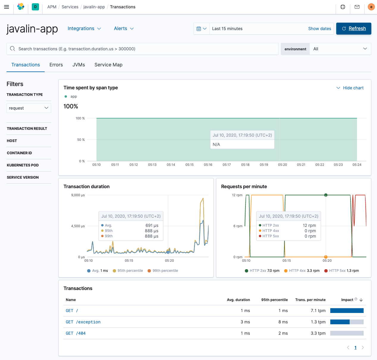

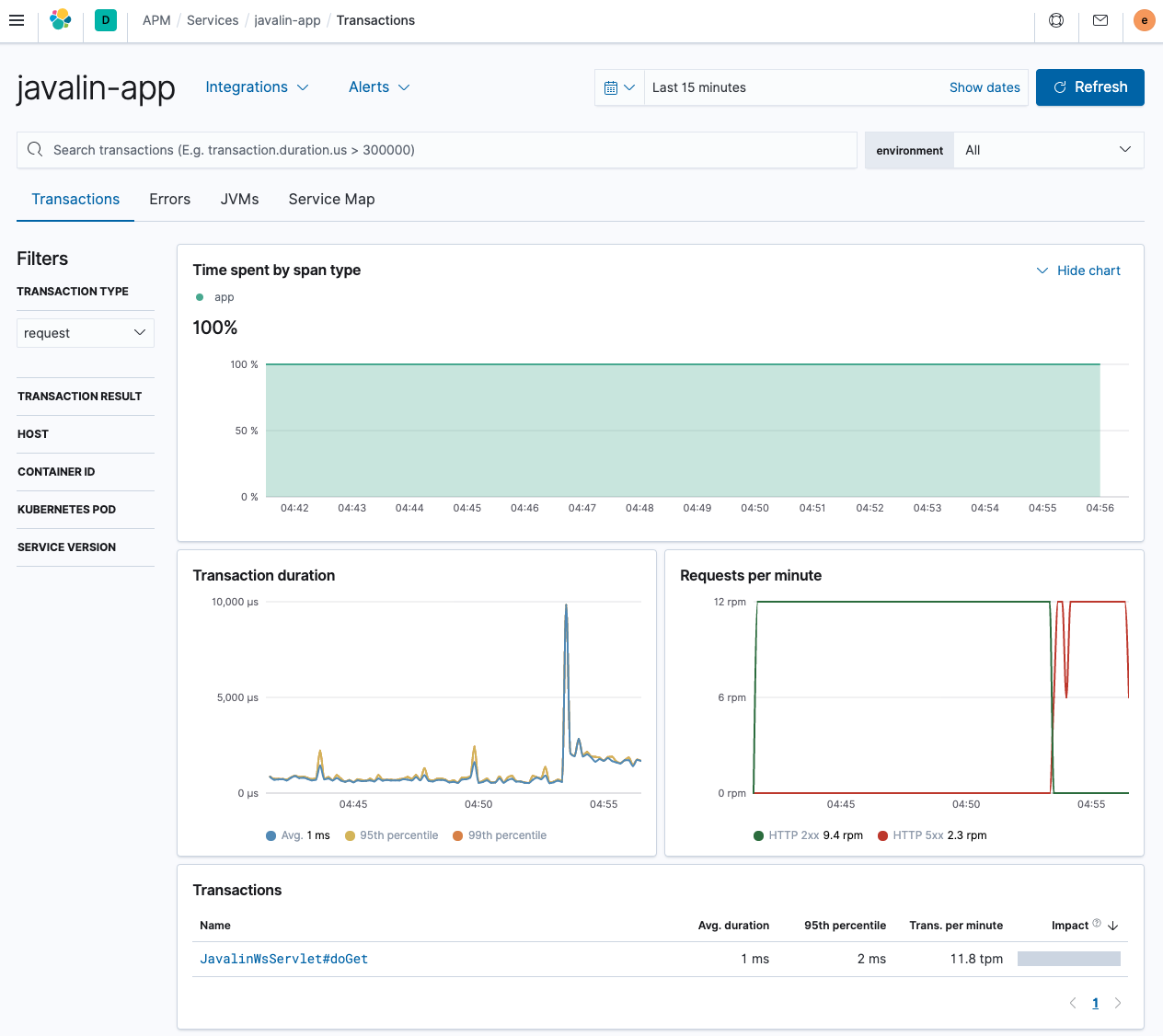

    Wait a few minutes and let’s finally take a look at the APM app.
    Javalin App APM UI
    As you can see, this is quite the difference to the Spring Boot application shown earlier. The different endpoints are not listed; we can see the requests per minute though including errors.
    The only transaction comes from a single servlet, which is not too helpful. Let’s try to fix this by introducing custom programmatic transactions.
Custom transactions
  1. Add another dependency.
    dependencies {
      implementation 'co.elastic.apm:apm-agent-attach:1.17.0'
      implementation 'co.elastic.apm:apm-agent-api:1.17.0'
  2. Fix the name of the transactions to include the HTTP method and the request path
    app.before(ctx -> ElasticApm.currentTransaction()
      .setName(ctx.method() + " " + ctx.path()));
  3. Restart your app and see data flowing in. Test a few different endpoints, especially the one that throws exceptions and the one that triggers a 404.
    APM UI with correct transaction names
    This looks much better, having differences between endpoints.

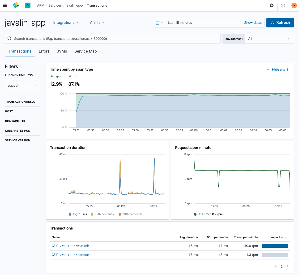

  4. Add another endpoint to see the power of transactions, which polls another HTTP service. You may have heard of wttr.in, a service to poll weather information from. Let’s implement a proxy HTTP method that forwards the request to that endpoint. Let’s use Apache HTTP client, one of the most typical HTTP clients out there.
    implementation 'org.apache.httpcomponents:fluent-hc:4.5.12'
    This is our new endpoint.
    import org.apache.http.client.fluent.Request;
        app.get("/weather/:city", ctx -> {
            String city = ctx.pathParam("city");
            ctx.result(Request.Get("https://wttr.in/" + city + "?format=3").execute()
                .returnContent().asBytes())
                .contentType("text/plain; charset=utf-8");

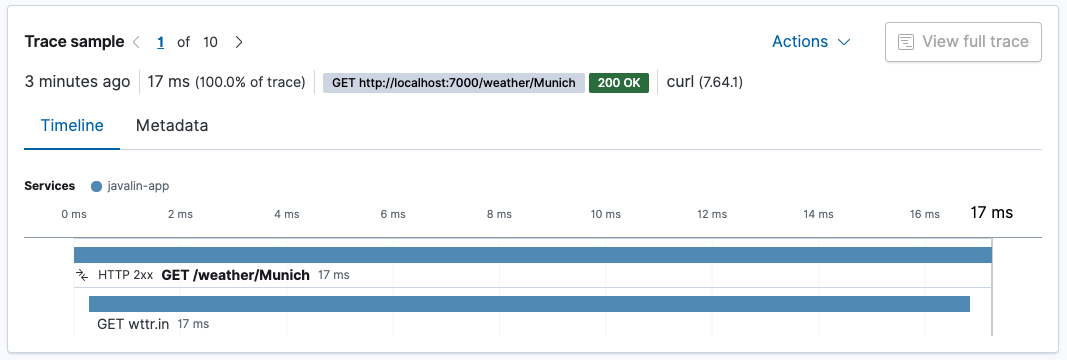

  5. Curl http://localhost:7000/weather/Munich and see a one-line response about the current weather. Let’s check the APM UI.
    In the overview, you can see that most time is spent in the HTTP client, which is not surprising.
    Overview
    Our transactions for the /weather/Munich now contain a span, showing how much time is spent on retrieving the weather data. Because the HTTP client is instrumented automatically, there is no need to do anything.
    Transaction with span

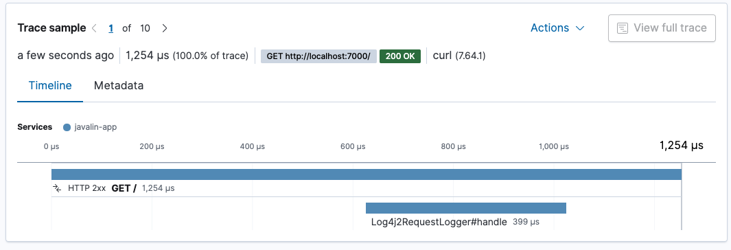

Method tracing via agent configuration
Instead of writing code to trace methods, you can also configure the agent to do this. Let’s try to figure out if logging is a bottleneck for our application and trace the request logger statements we added earlier.
The agent can trace methods based on their signature.
The interface to monitor would be the io.javalin.http.RequestLogger interface with the handle method. So let’s try io.javalin.http.RequestLogger#handle to identify the method to log and put this in your .env.
ELASTIC_APM_TRACE_METHODS="de.spinscale.javalin.Log4j2RequestLogger#handle"

  2. Fix the call in our App class.
    config.requestLogger(new Log4j2RequestLogger());
  3. Restart your app, and see how much time your logging takes.
    Logging caller trace
    The request logger takes roughly 400 microseconds. The whole request takes about 1.3 milliseconds. Approximately a third of the processing of our request goes into logging.
    If you are on the quest for a faster service, you may want to rethink logging. However, this logging happens after the result is written to the client, so while the total processing time increases with logging, responding to the client does not (closing the connection however might be). Also note that these tests were conducted without a proper warm-up. I assume that after appropriate JVM warm-up, you will have much faster processing of requests.
Automatic profiling of inferred spans
Once you have a bigger application with more code paths than our sample app, you can try to enable the automatic profiling of inferred spans by setting the following.
ELASTIC_APM_PROFILING_INFERRED_SPANS_ENABLED=true
This mechanism uses the async profiler to create spans without you having to instrument anything allowing you to find bottlenecks faster.
Log correlation
Transaction ids are automatically added to logs. You can check the generated log files that are sent to Elasticsearch via Filebeat. An entry looks like this.
  "@timestamp": "2020-07-13T12:03:22.491Z",
  "log.level": "INFO",
  "message": "GET / 200 0:0:0:0:0:0:0:1 \"curl/7.64.1\" 0",
  "service.name": "my-javalin-app",
  "event.dataset": "my-javalin-app.log",
  "process.thread.name": "qtp34871826-36",
  "log.logger": "de.spinscale.javalin.Log4j2RequestLogger",
  "trace.id": "ed735860ec0cd3ee3bdf80ed7ea47afb",
  "transaction.id": "8af7dff698937dc5"
Having the trace.id and transaction.id added, in the case of an error you will get an error.id field.

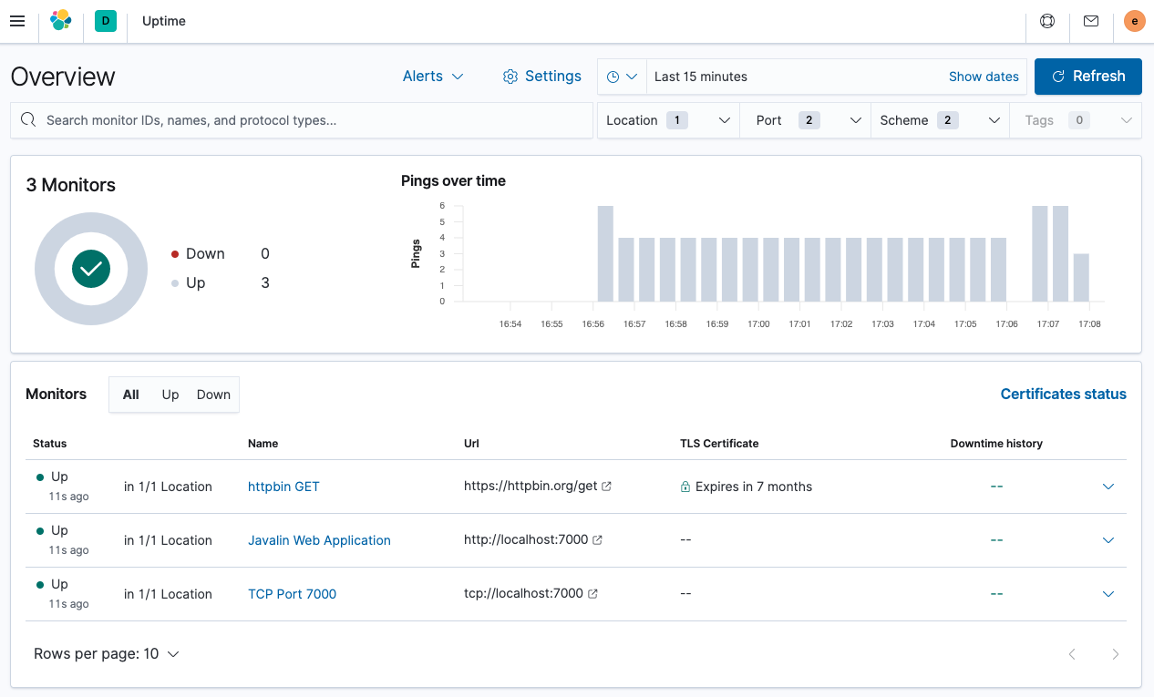

Step 8: Ingest Uptime data
There are some basic monitoring capabilities in our application so far. We index logs (with traces), we index metrics, and we even can look in our app to figure out single performance bottlenecks thanks to APM. However, there is still one weak spot. Everything done so far was within the application, but all the users are reaching the application from the internet.
How about checking if our users have the same experience that our APM data is suggesting to us. Imagine having a lagging load balancer fronting your app, that costs you an additional 50 milliseconds per request. That would be devastating. Or TLS negotiation being costly. Even though none of those external events is your fault, you will still be impacted by this and should try to mitigate those. This means you need to know about them first.
Uptime not only enables you to monitor the availability of a service, but also graph latencies over time, and get notified about expiring TLS certificates.
Setup
To send uptime data to Elasticsearch, Heartbeat (the polling component) is required. To download and install Heartbeat, use the commands that work with your system:
curl -L -O https://artifacts.elastic.co/downloads/beats/heartbeat/heartbeat-8.7.1-amd64.deb
sudo dpkg -i heartbeat-8.7.1-amd64.deb
After downloading and unpacking, we have to set up the cloud id and the password one more time.
  1. We need to create another API_KEY as an elastic admin user in Kibana.
    POST /_security/api_key
      "name": "heartbeat_javalin-app",
      "role_descriptors": {
        "heartbeat_writer": {
          "cluster": ["monitor", "read_ilm"],
          "index": [
              "names": ["heartbeat-*"],
              "privileges": ["view_index_metadata", "create_doc"]
  2. Let’s setup the Heartbeat keystore and run the setup.
    ./heartbeat keystore create
    echo -n "observability-javalin-app:ZXUtY2VudHJhbC0xLmF3cy5jbG91ZC5lcy5pbyQ4NDU5M2I1YmQzYTY0N2NhYjA2MWQ3NTJhZWFhNWEzYyQzYmQwMWE2OTQ2MmQ0N2ExYjdhYTkwMzI0YjJiOTMyYQ==" | ./heartbeat keystore add CLOUD_ID --stdin
    echo -n "SCdUSHMB1JmLUFPLgWAY:R3PQzBWW3faJT01wxXD6uw" | ./heartbeat keystore add ES_API_KEY --stdin
    ./heartbeat setup -e -E 'cloud.id=${CLOUD_ID}' -E 'cloud.auth=elastic:YOUR_SUPER_SECRET_PASS'
  3. Add some services to monitor.
    cloud.id: ${CLOUD_ID}
    output.elasticsearch:
      api_key: ${ES_API_KEY}
    heartbeat.monitors:
      - type: http
        name: "Javalin Web Application"
        urls: ["http://localhost:7000"]
        check.response.status: [200]
        schedule: '@every 15s'
      - type: http
        urls: ["https://httpbin.org/get"]
      - type: tcp
        name: "TCP Port 7000"
        hosts: ["localhost:7000"]
    processors:
      - add_observer_metadata:
          geo:
            location: "48.138791, 11.583030"
  4. Now start Heartbeat and wait a couple of minutes to get some data.
sudo service heartbeat start
If you use an init.d script to start Heartbeat, you can’t specify command line flags (see Command reference). To specify flags, start Heartbeat in the foreground.
Also see Heartbeat and systemd.
To view the Uptime app, select ObservabilityUptime. The overview looks like this.
Uptime Overview
You can see the list of monitors and a global overview. Let’s see the details for one of those alerts. Click Javalin Web Application.
You can see the execution for the last scheduled checks, but the duration for each check might be more interesting. You can see if the latency for one of your checks is going up.
The interesting part is the world map at the top. You can specify in the configuration where the check originated, which in this case was in Munich in Europe. By configuring several Heartbeats running across the world, you can compare latencies and figure out which data center you need to run your application to be next to your users.
The duration of the monitor is in the low milliseconds, as it is really fast. Check the monitor for the httpbin.org endpoint, and you will see a much higher duration. In this case, it is about 400 milliseconds for each request. This is not too surprising because the endpoint is not nearby, and you need to initiate a TLS connection for every request, which is costly.
Do not underestimate the importance of this kind of monitoring. Also, consider this just the beginning as the next step is to have synthetics that monitor the correct behavior of your application, for example, to ensure that your checkout process works all the time.
