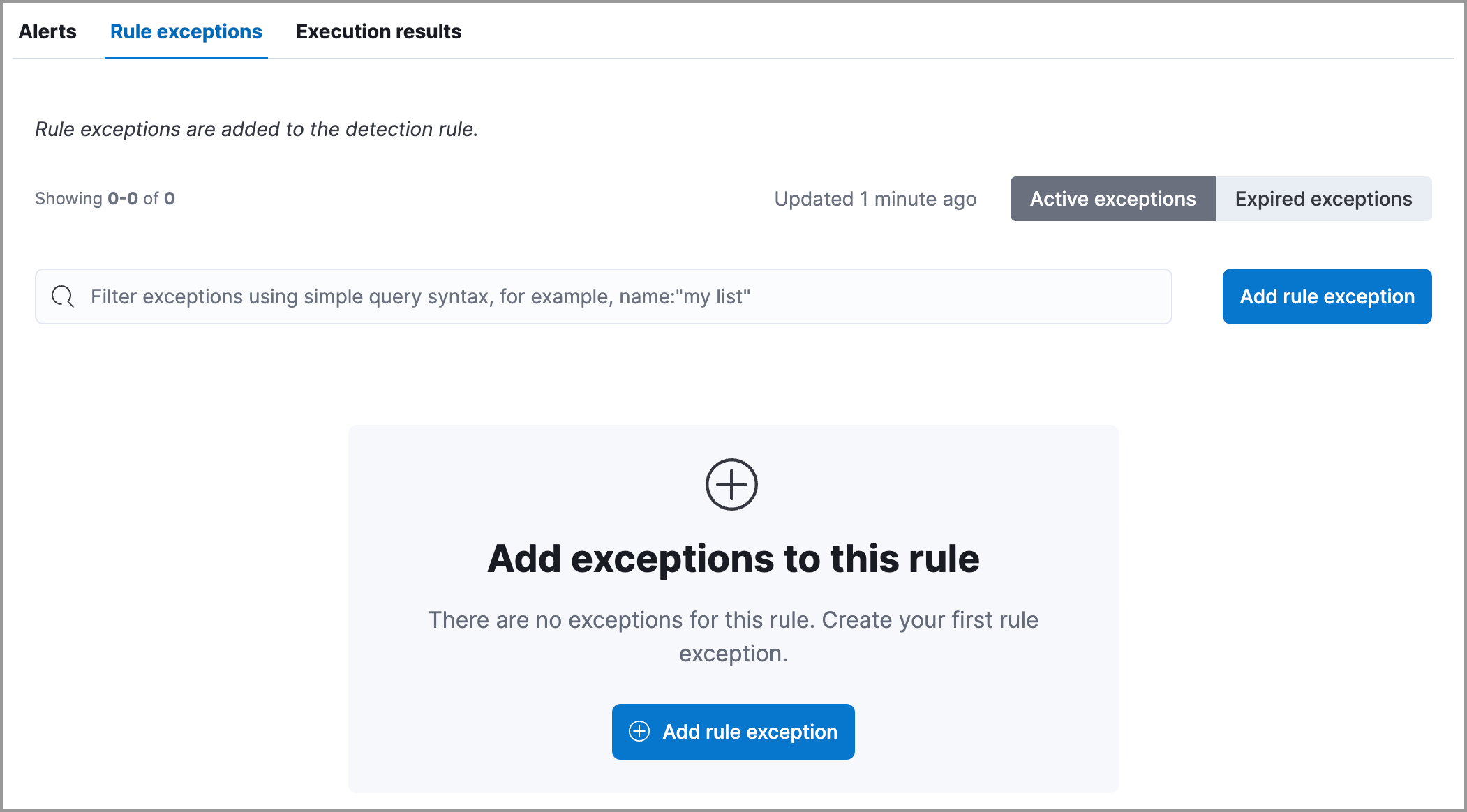

      2. Scroll down the rule details page, select the Rule exceptions tab, then click Add rule exception.
        Detail of rule exceptions tab

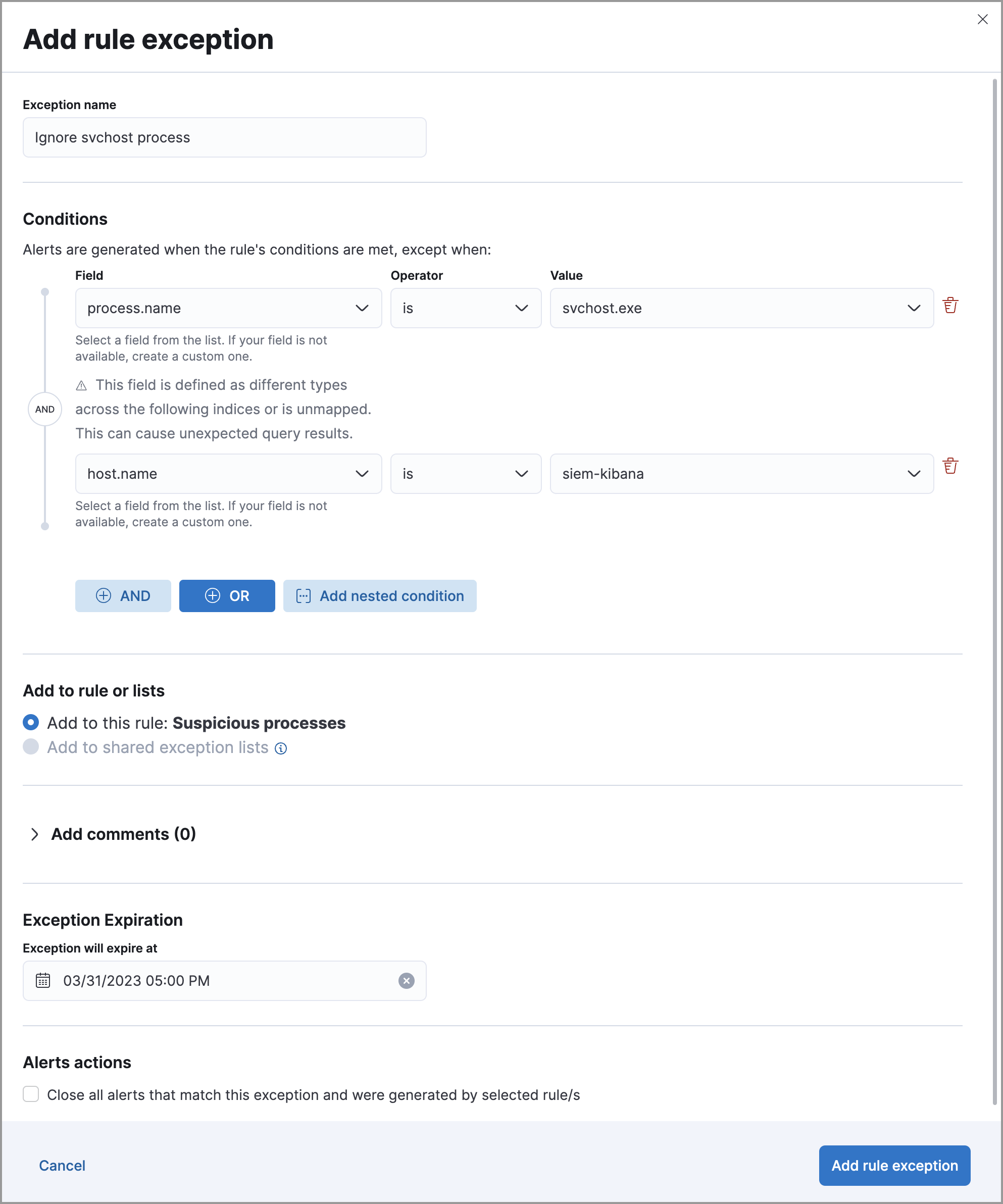

      In the following example, the exception was created from the Rules page and prevents the rule from generating alerts when the svchost.exe process runs on hostname siem-kibana.
      add exception ui

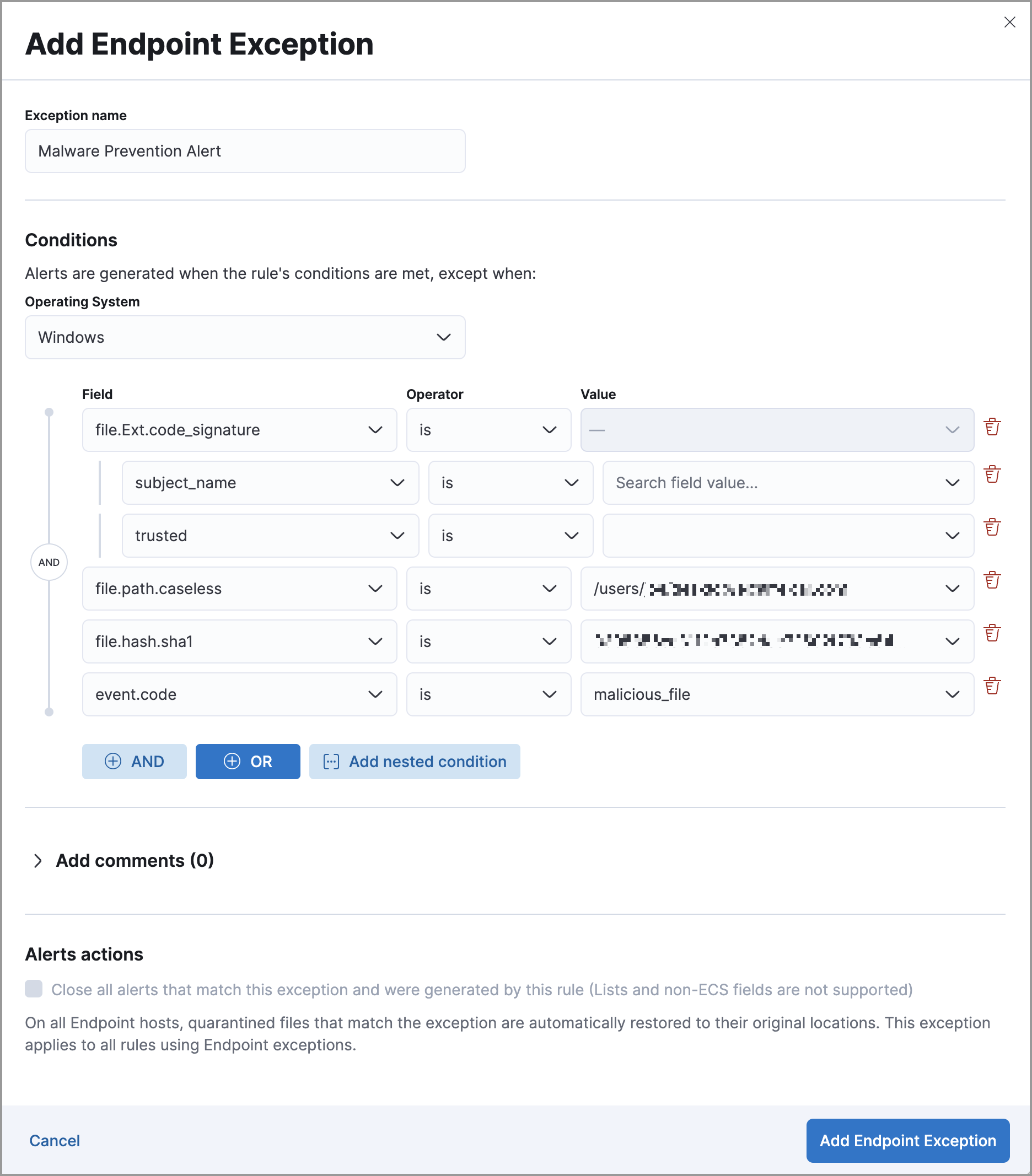

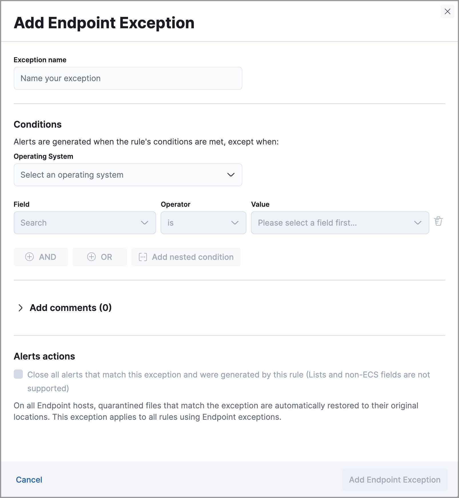

    The Add Endpoint Exception flyout opens.
    endpoint add exp
  2. If required, modify the conditions.
    Rule exceptions are case-sensitive, which means that any character that’s entered as an uppercase or lowercase letter will be treated as such. In the event you don’t want a field evaluated as case-sensitive, some ECS fields have a .caseless version that you can use.
    • Fields with conflicts are marked with a warning icon (Field conflict warning icon). Using these fields might cause unexpected exceptions behavior. For more information, refer to Troubleshooting type conflicts and unmapped fields.
    • The is one of and is not one of operators support identical, case-sensitive values. For example, if you want to match the values Windows and windows, add both values to the Value field.
  3. (Optional) Add a comment to the exception.
  4. You can select any of the following:
    • Close this alert: Closes the alert when the exception is added. This option is only available when adding exceptions from the Alerts table.
    • Close all alerts that match this exception and were generated by this rule: Closes all alerts that match the exception’s conditions.
  5. Click Add Endpoint Exception. An exception is created for both the detection rule and the Elastic Endpoint.

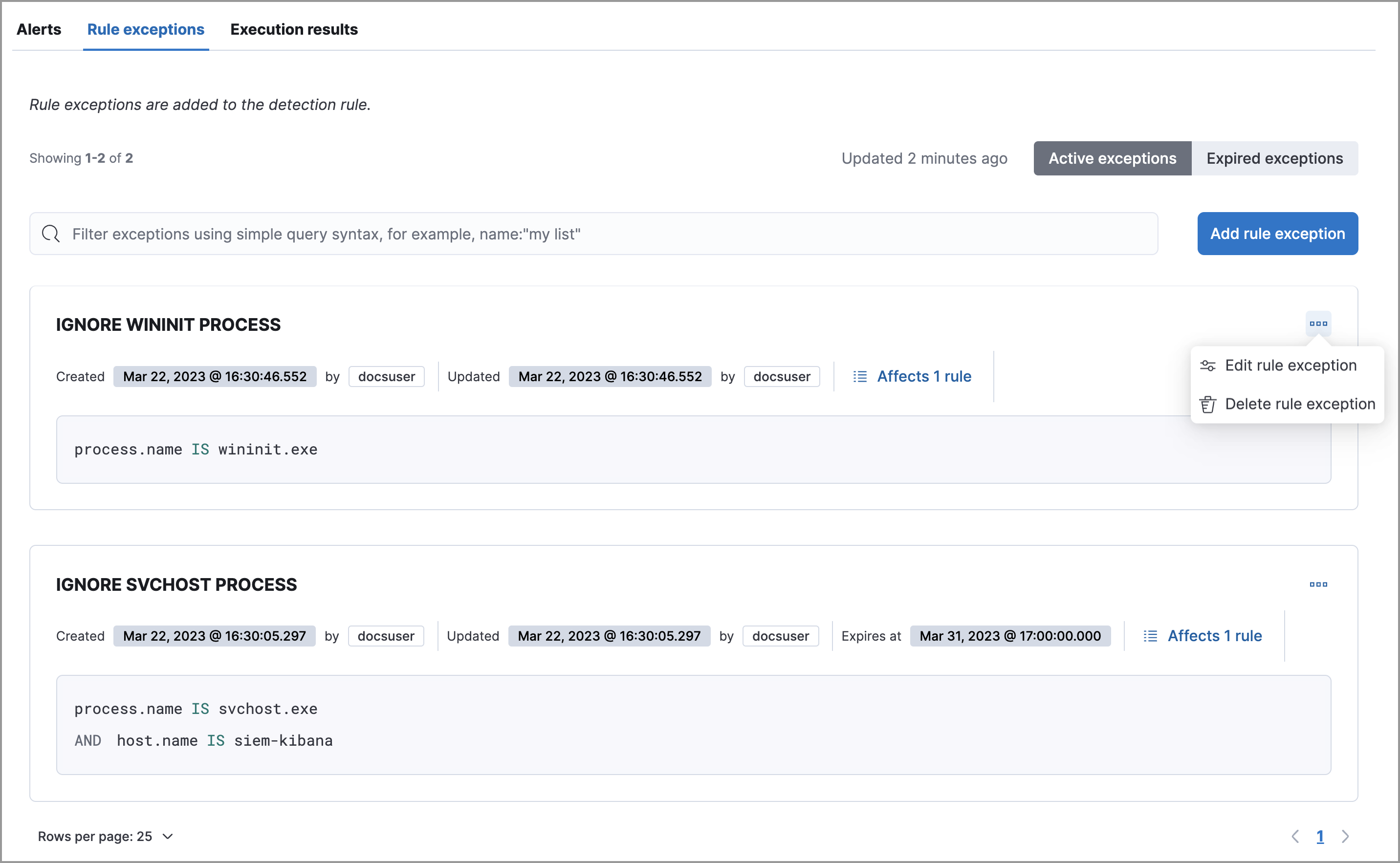

To view a rule’s exceptions, open the rule’s details page (RulesDetection rules (SIEM)Rule name), then scroll down and select the Rule exceptions or Endpoint exceptions tab. All exceptions that belong to the rule will display in a list. From the list, you can filter, edit, and delete exceptions. You can also toggle between Active exceptions and Expired exceptions.
A default rule list

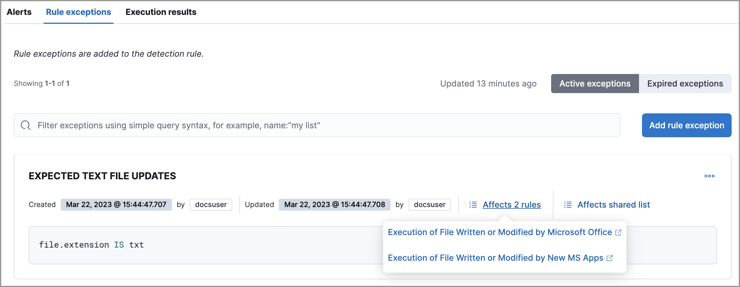

To find out if an exception is used by other rules, select the Rule exceptions or Endpoint exceptions tab, navigate to an exception list item, then click Affects X rules.
Changes that you make to the exception also apply to other rules that use the exception.
Exception that affects multiple rules
