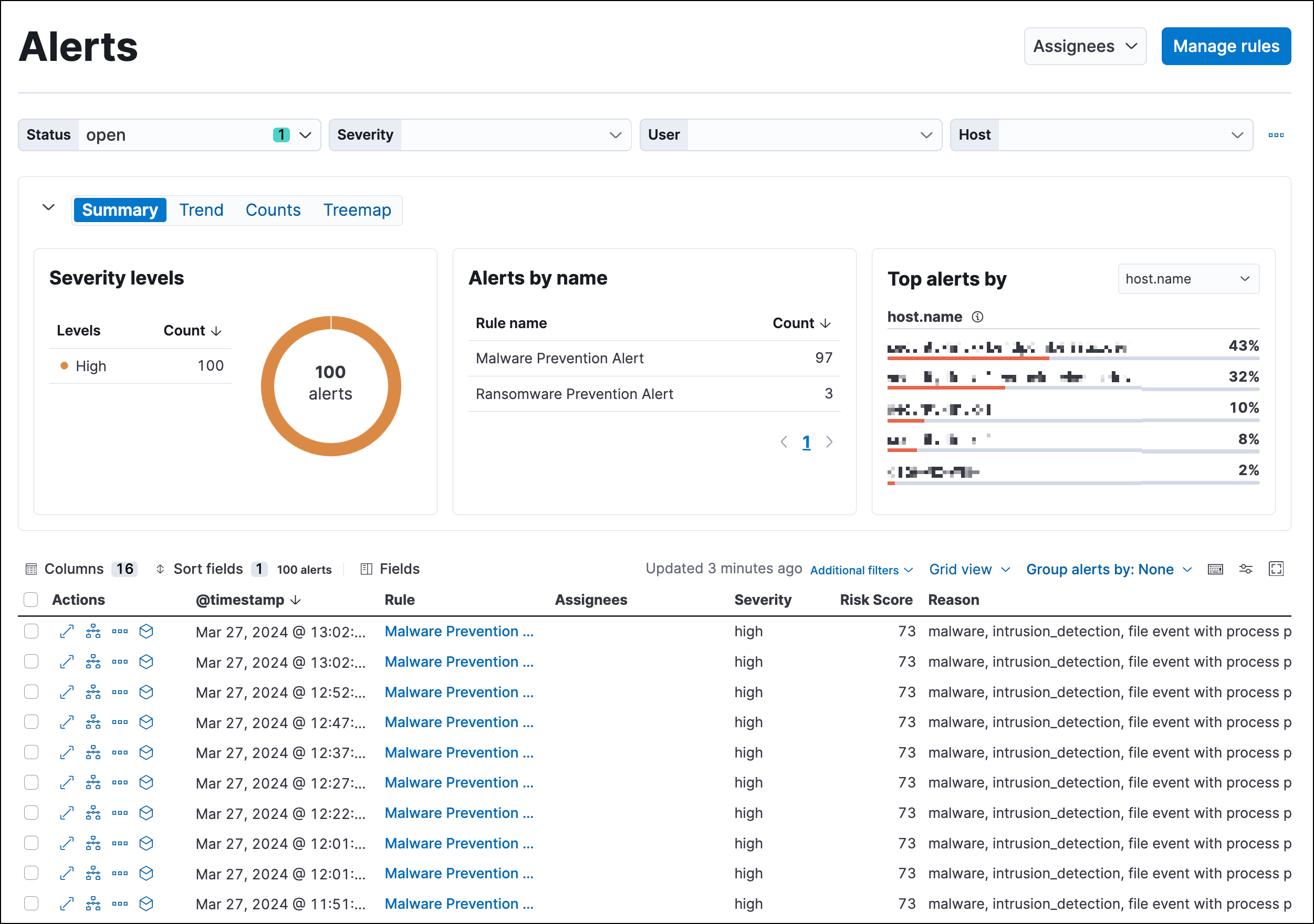

Detections and alerts
editDetections and alerts
editUse the detection engine to create and manage rules and view the alerts

conditions are met. When an alert is created, its status is Open
. To help
track investigations, an alert’s status can be set as
Open
, Acknowledged
, or Closed
In addition to creating your own rules, enable Elastic prebuilt rules to immediately start detecting suspicious activity. For detailed information on all the prebuilt rules, see the Prebuilt rule reference section. Once the prebuilt rules are loaded and running, Tune detection rules and Add and manage exceptions explain how to modify the rules to reduce false positives and get a better set of actionable alerts. You can also use exceptions and value lists when creating or modifying your own rules.

Endpoint Security: Automatically creates an alert from all incoming Elastic Endpoint alerts. To receive Elastic Endpoint alerts, you must install the Endpoint agent on your hosts (see Install Elastic Defend).
When this rule is enabled, the following Endpoint events are displayed as detection alerts:
- Malware Prevention Alert
Malware Detection Alert
When you load the prebuilt rules, this is the only rule that is enabled by default.
