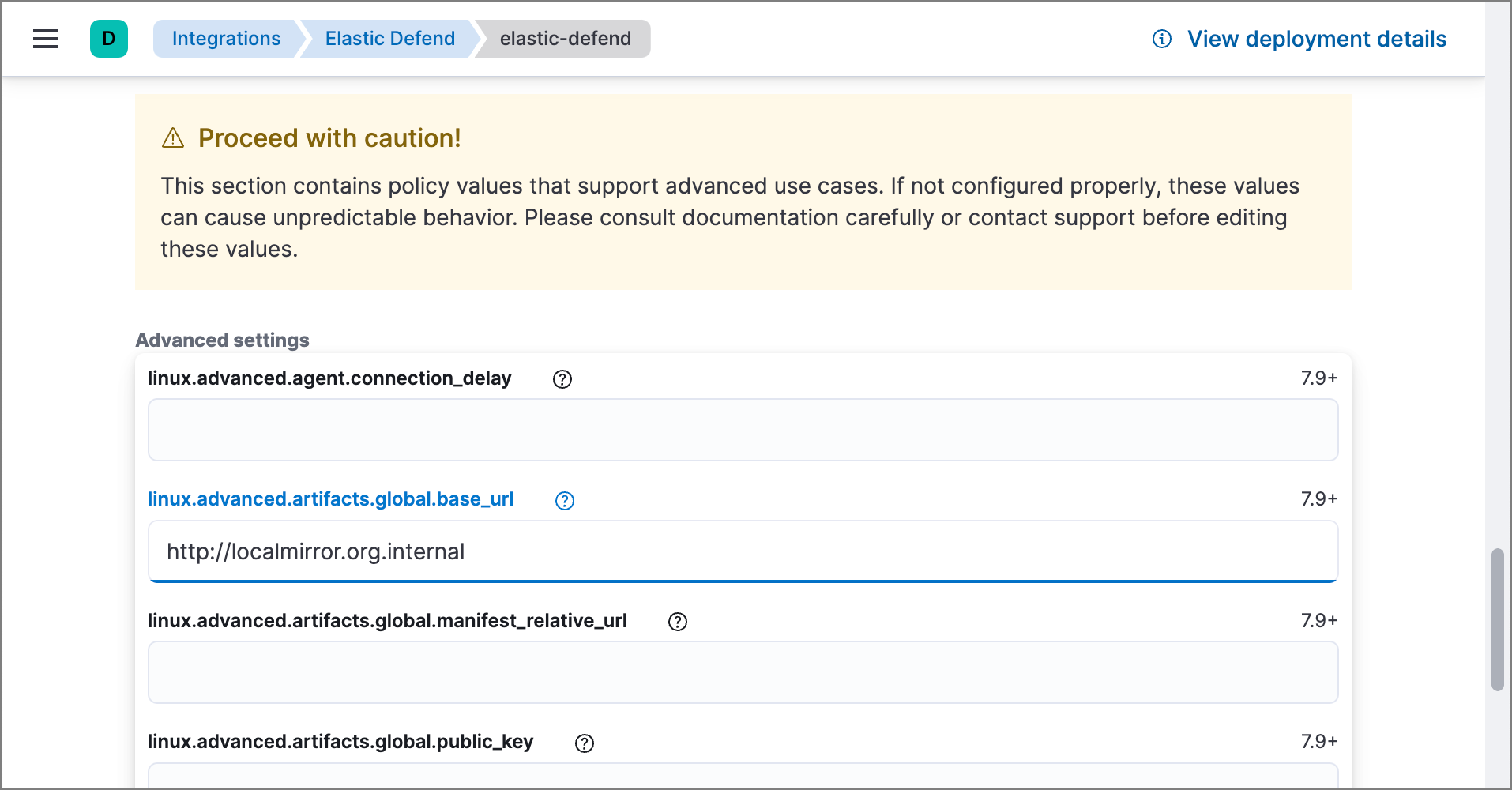

Set the advanced.artifacts.global.base_url advanced setting for each Elastic Defend integration policy that needs to use the mirror. Note that there’s a separate setting for each operating system:
  • linux.advanced.artifacts.global.base_url
  • mac.advanced.artifacts.global.base_url
  • windows.advanced.artifacts.global.base_url
Integration policy advanced settings

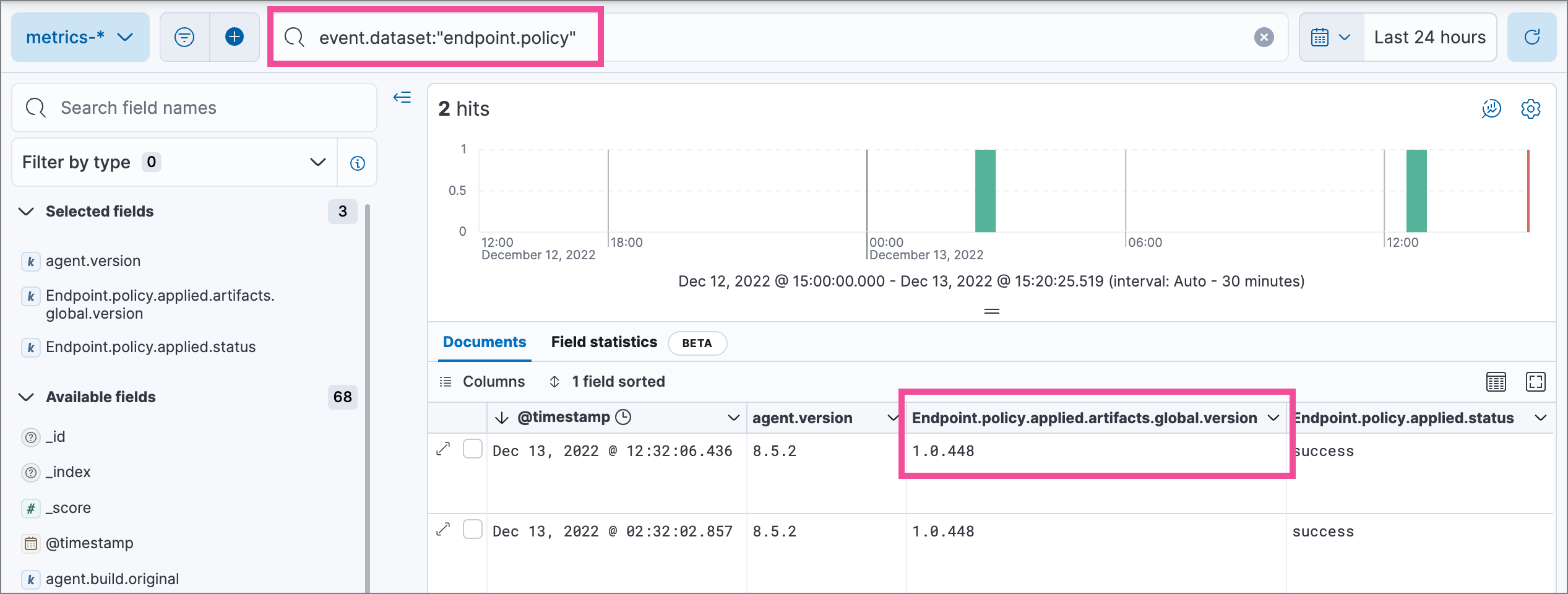

After updating the Elastic Endpoint configuration to read from the mirror server, use Kibana’s Discover view to search the metrics-* data view for endpoint.policy response documents, then check the installed version (Endpoint.policy.applied.artifacts.global.version) and compare with the output from the command above:
Searching for `endpoint.policy` in Discover
