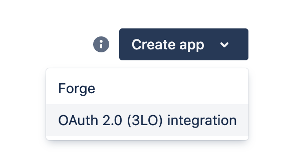

Step 1. Click Create app, then select OAuth 2.0 (3LO) integration:

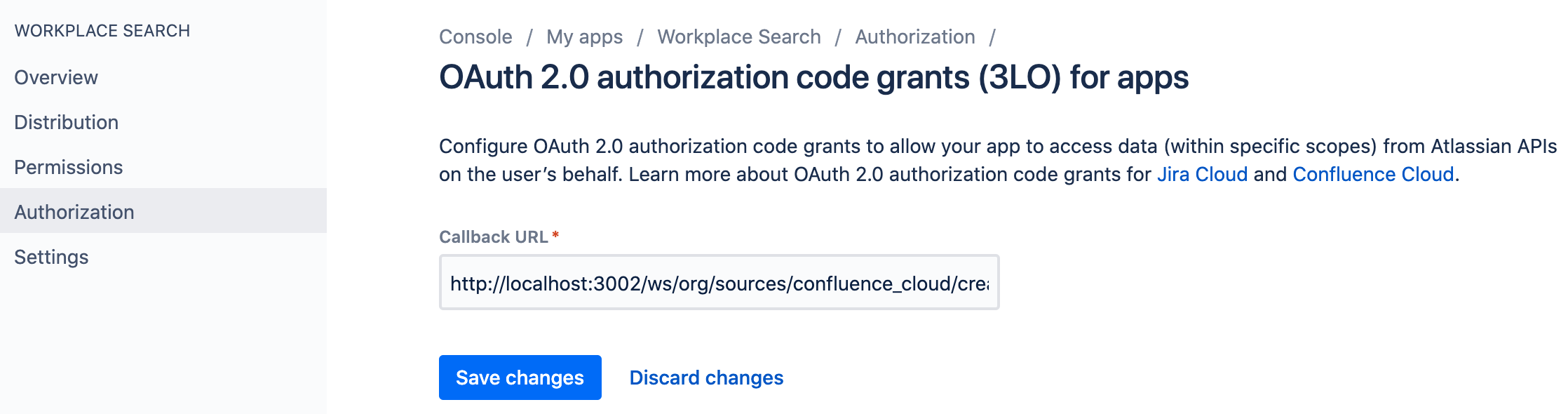

Step 5. We must now create API access and set the right permission level. In the sidebar, click Authorization, locate OAuth 2.0 (3LO), and click Configure:
Figure 14. Connecting Confluence
Step 6. Use the Callback URL form to add one of the following callback URLs.
Among other factors, the callback URL is affected by which user interface you are using to manage Enterprise Search. Enterprise Search in Kibana and standalone Enterprise Search use different callback URLs. See user interfaces for details on each UI.

Figure 15. Connecting Confluence

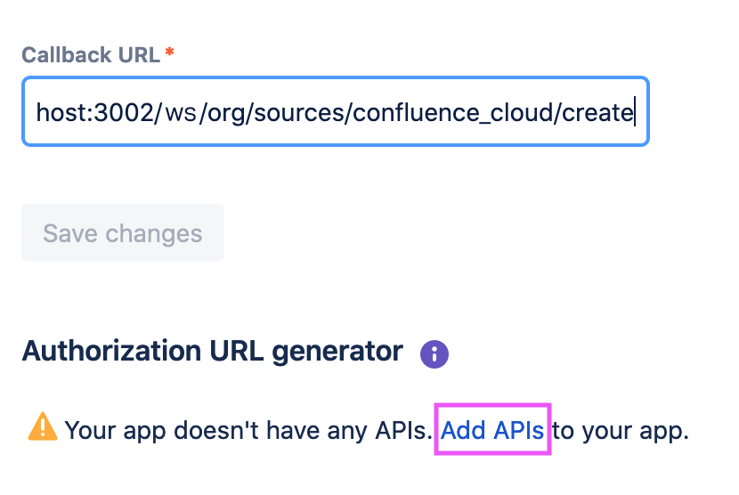

Step 7. A prompt appears. Click the Add APIs hyperlink:
Figure 16. Connecting Confluence

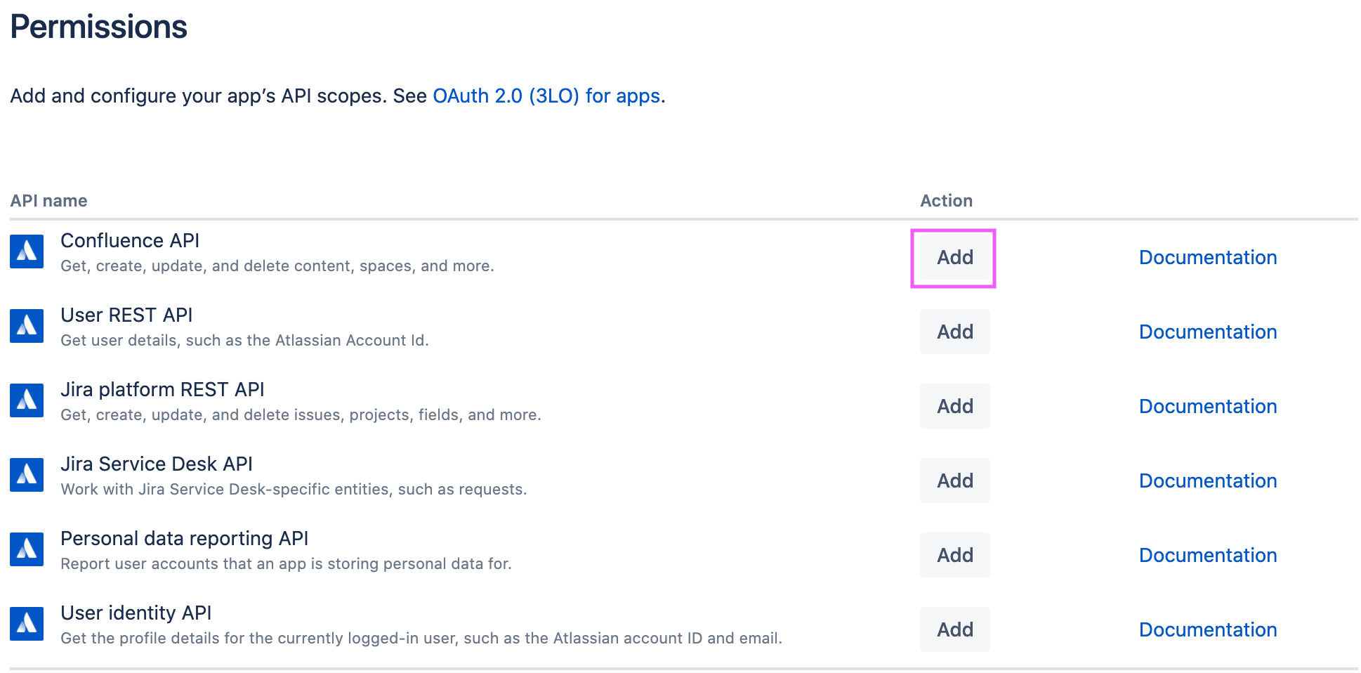

Step 8. Click Permissions, find Confluence API and click Add, then Configure:
Figure 17. Connecting Confluence
