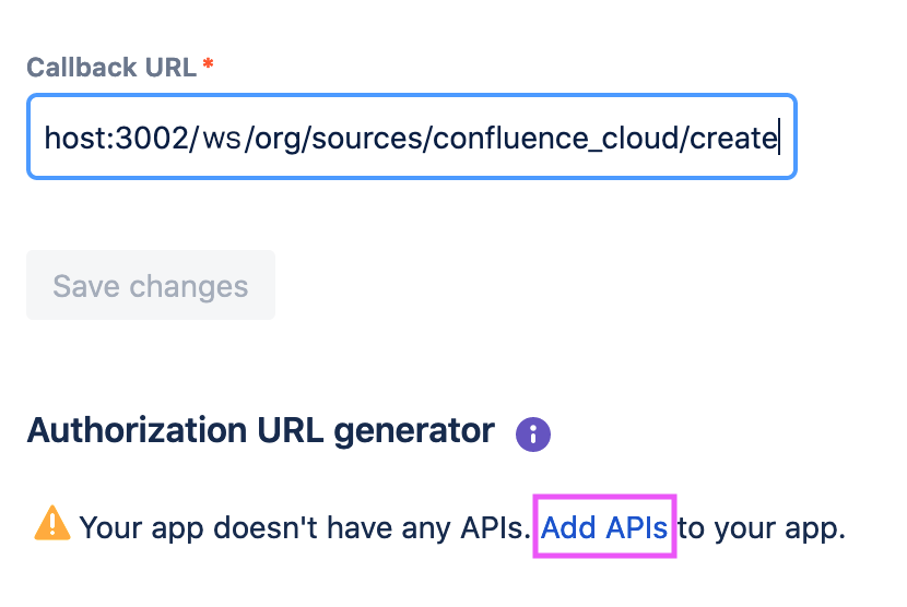

Step 6. Use the Callback URL form to add one of the following callback URLs.

Step 7. A prompt appears. Click the Add APIs hyperlink:

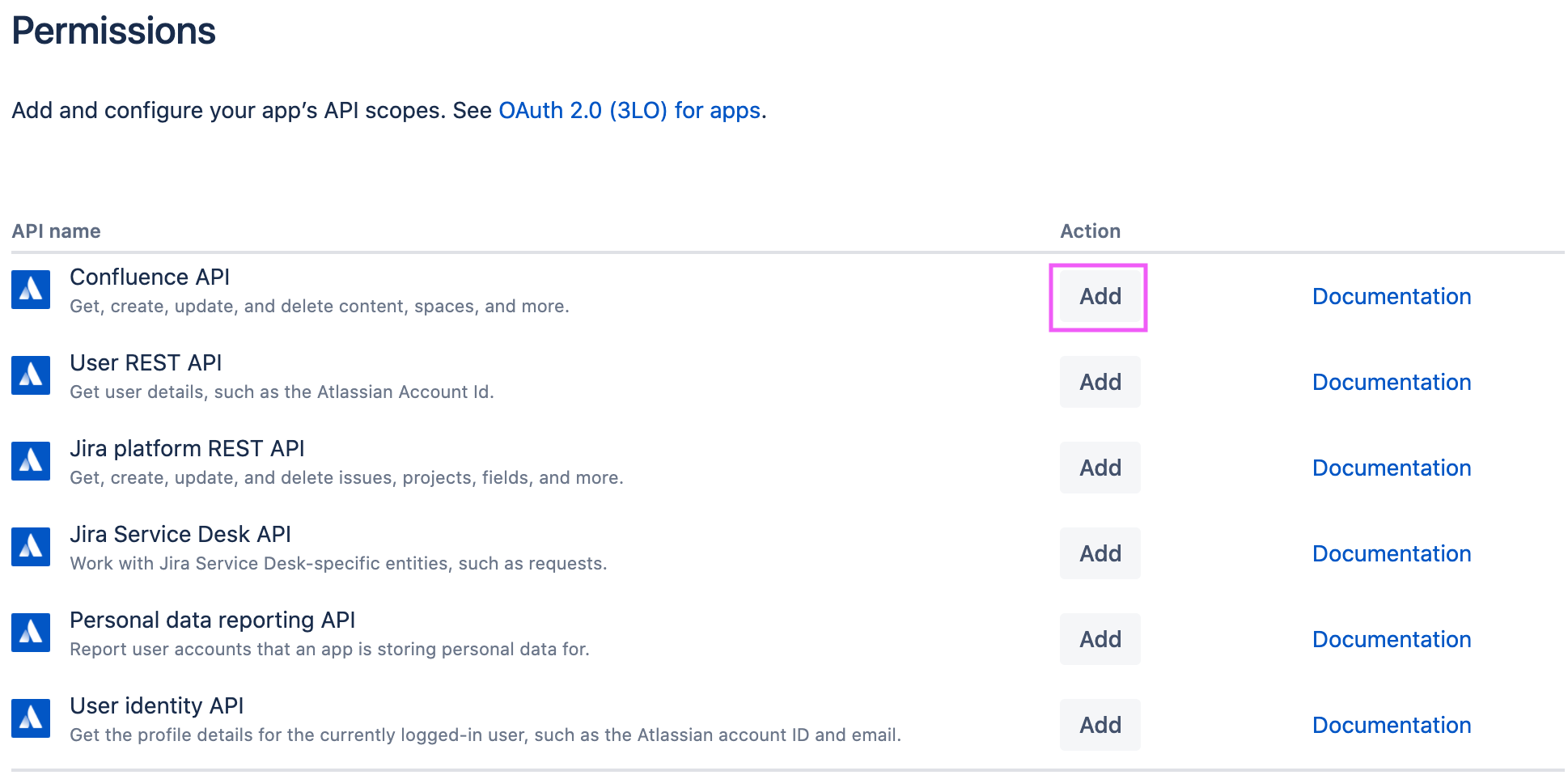

Step 8. Click Permissions, find Confluence API and click Add, then Configure:
Step 9. We must enable a series of permissions. Add the following and save:
