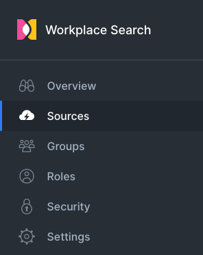

Step 1. First, we need to locate the content source in Kibana, and open the Assets and objects page. From the administrative dashboard, navigate to Sources:
From here, open the Dropbox content source by clicking on Details, then click on Synchronization in the sidebar and open the Assets and objects page.

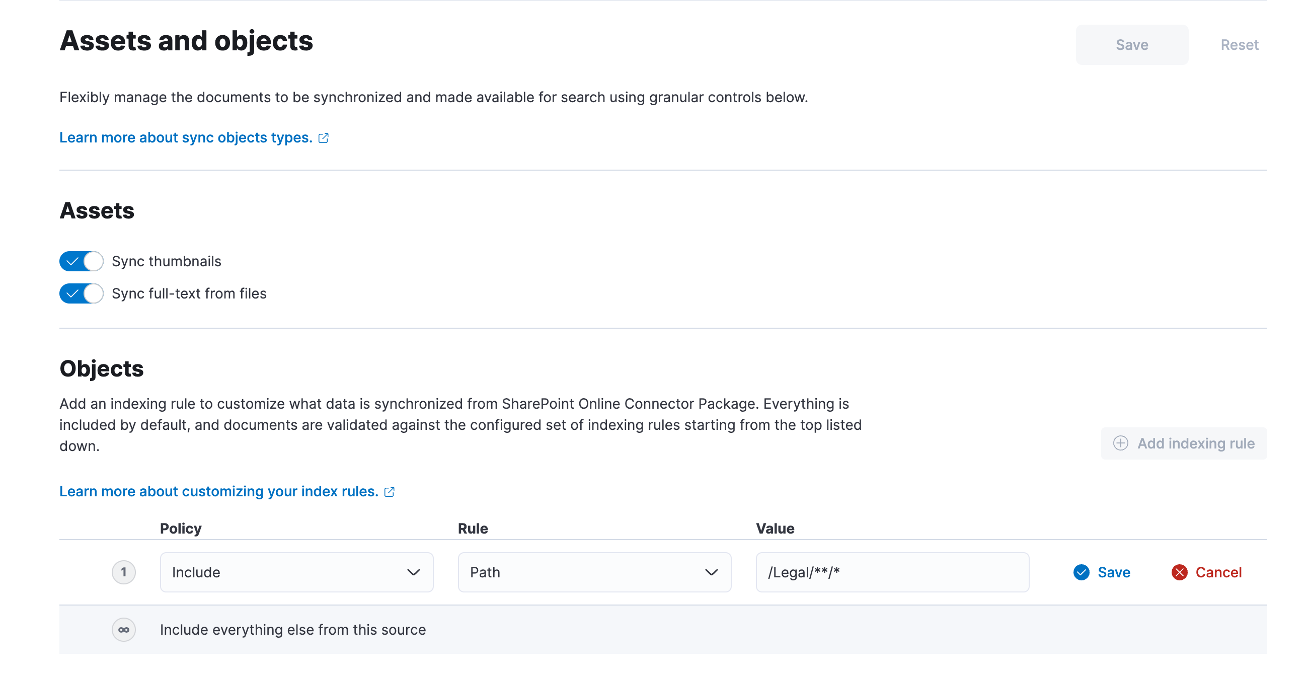

Step 3. We can then use the table at the bottom of the page to build an indexing configuration to filter out our Legal documents. Click Add indexing rule, set the Policy to Exclude, the Rule to Path and the Value to /Legal/**/*. Click Save in the table to add the rule to the indexing configuration.
Note that the new indexing rule configuration won’t be saved until you click the Save button at the top of the page. You can do so now.

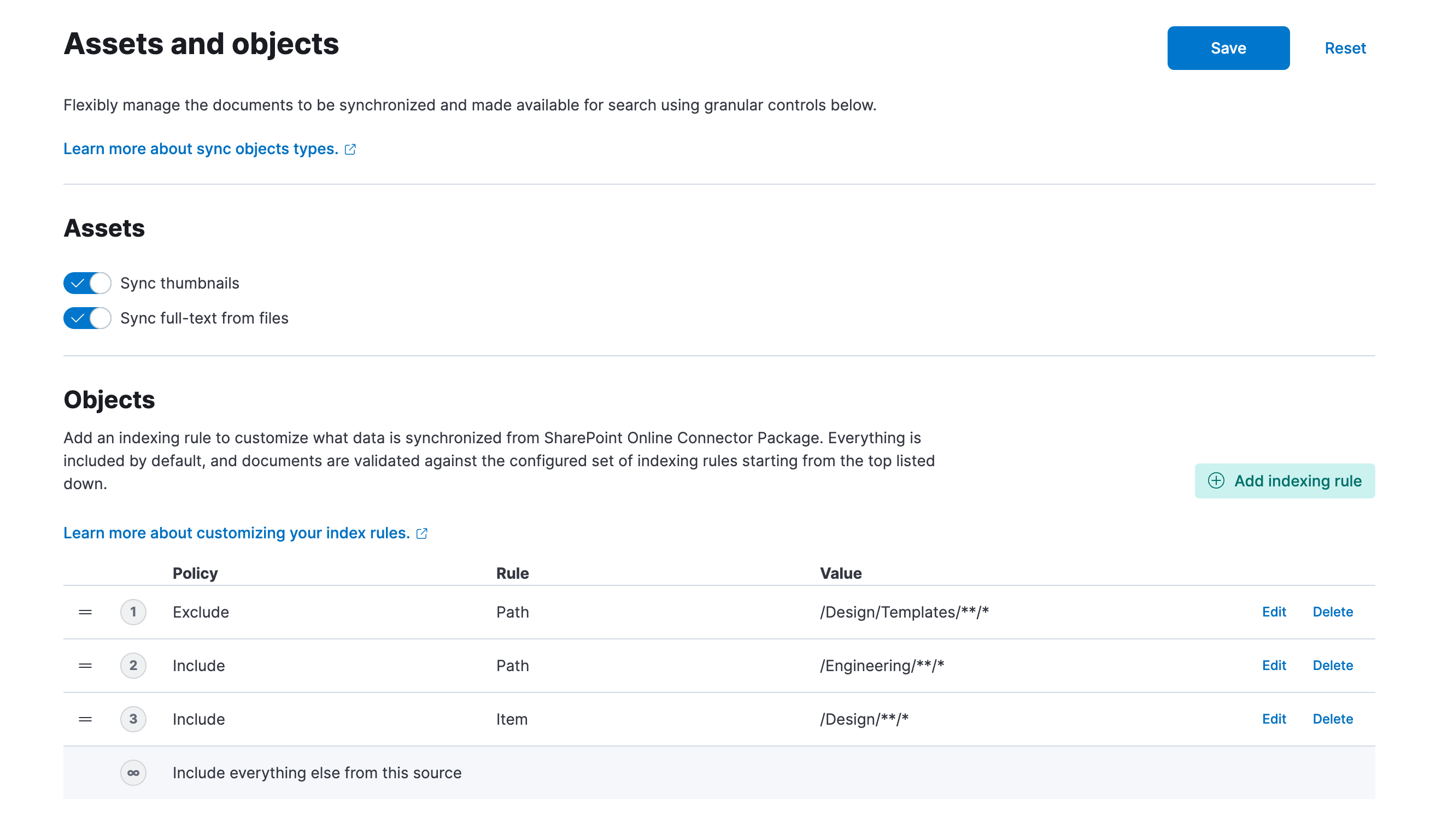

Include only specific sub-directories
For file system based sources, rather than excluding content, perhaps you only want to index content within a specific set of directories. Note that rules are evaluated in order, which allows a complex mixture of include
and exclude
rules. This example will index all content in the Engineering and Design top-level folders, however the Templates folder within Design will also be excluded:
Rules can easily be reordered by dragging them within the table. You will need to click Save at the top of the page to store your changes and trigger a full synchronization.

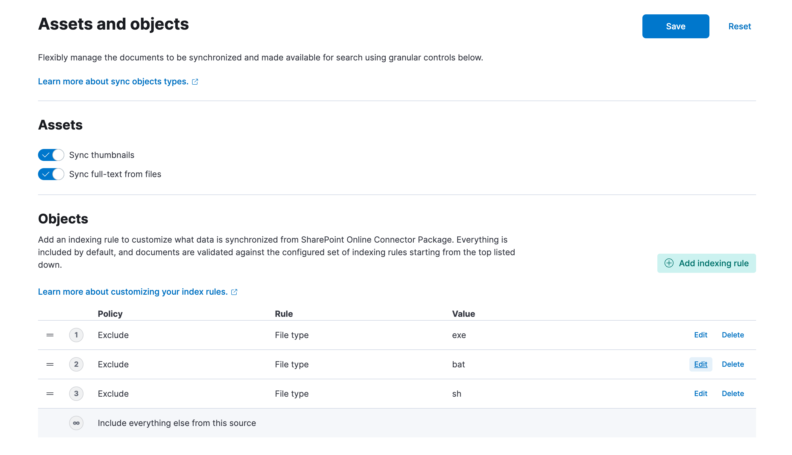

Exclude specific file extensions
This configuration will exclude some common executable file types:
