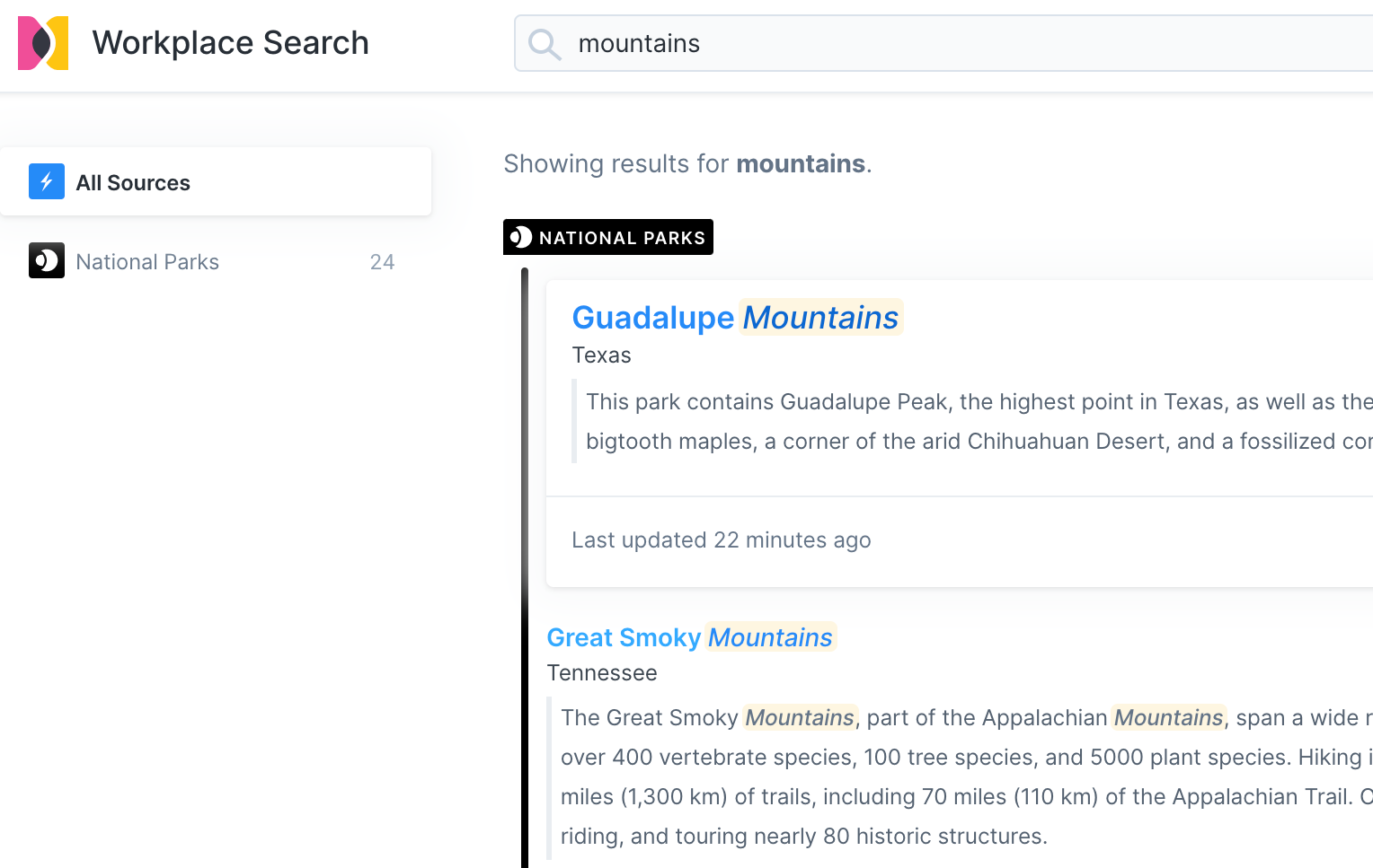

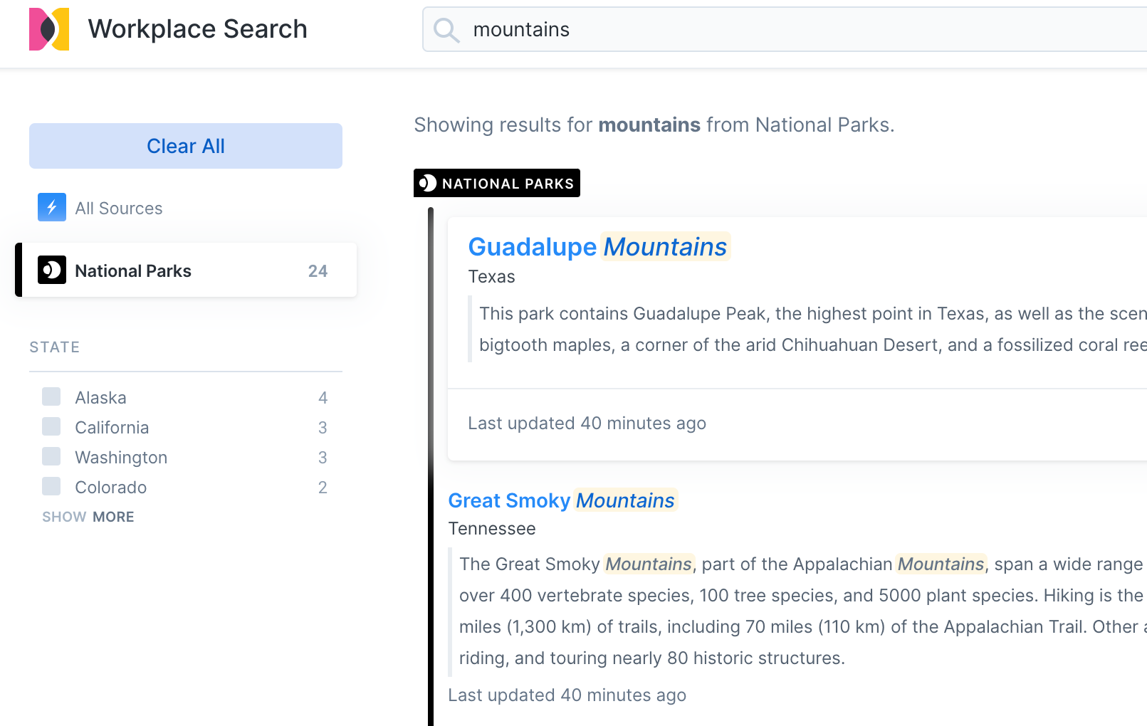

Step 5. Now we can see the search experience includes a filter for State. Note that you generally need to filter on a specific source to expose filters for that source (in this case the National Parks source).

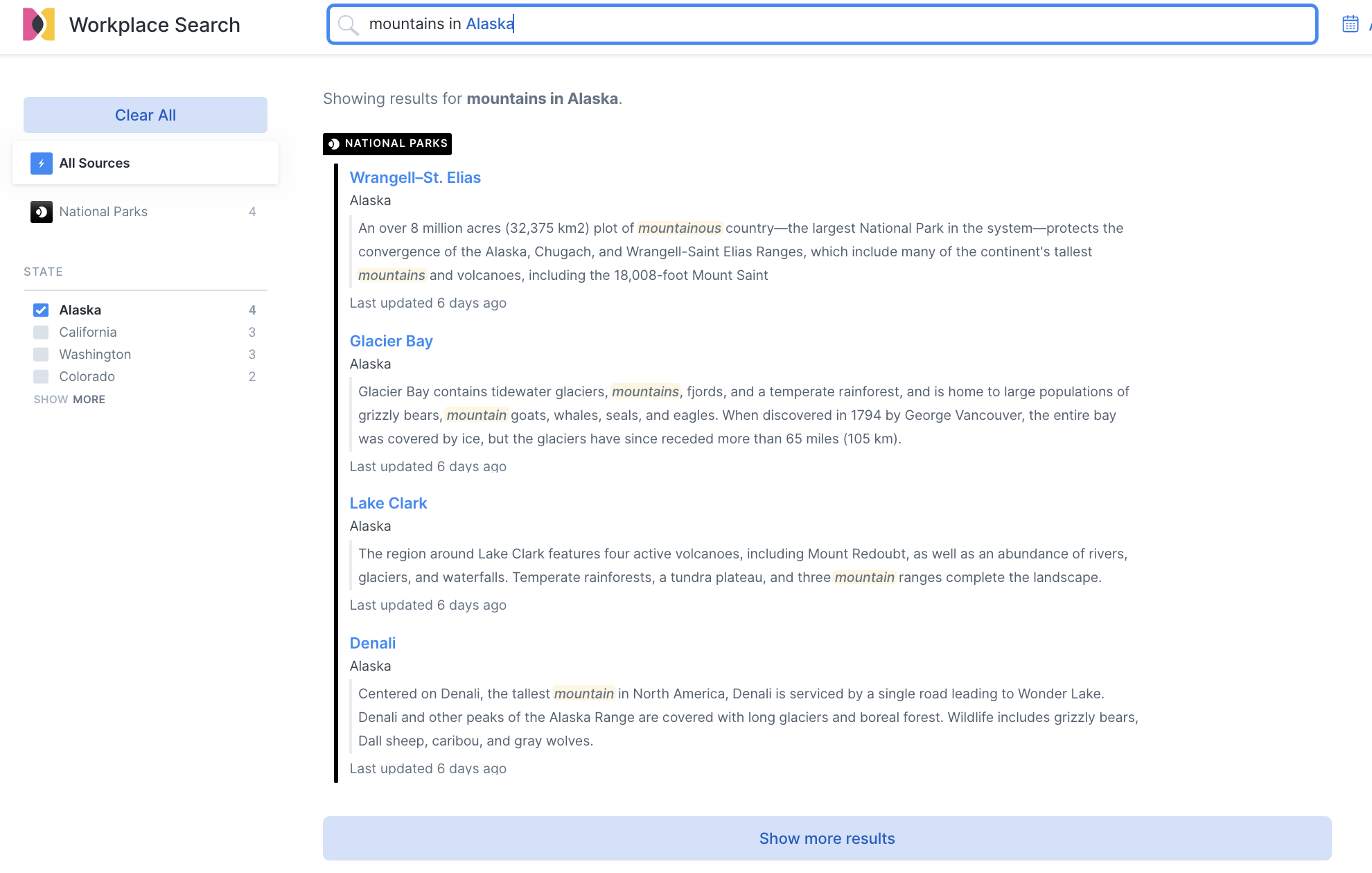

Now when your users issue queries like mountains in Alaska or mountains inside California, the state in their search box will highlight blue, and the corresponding facet will automatically be checked.

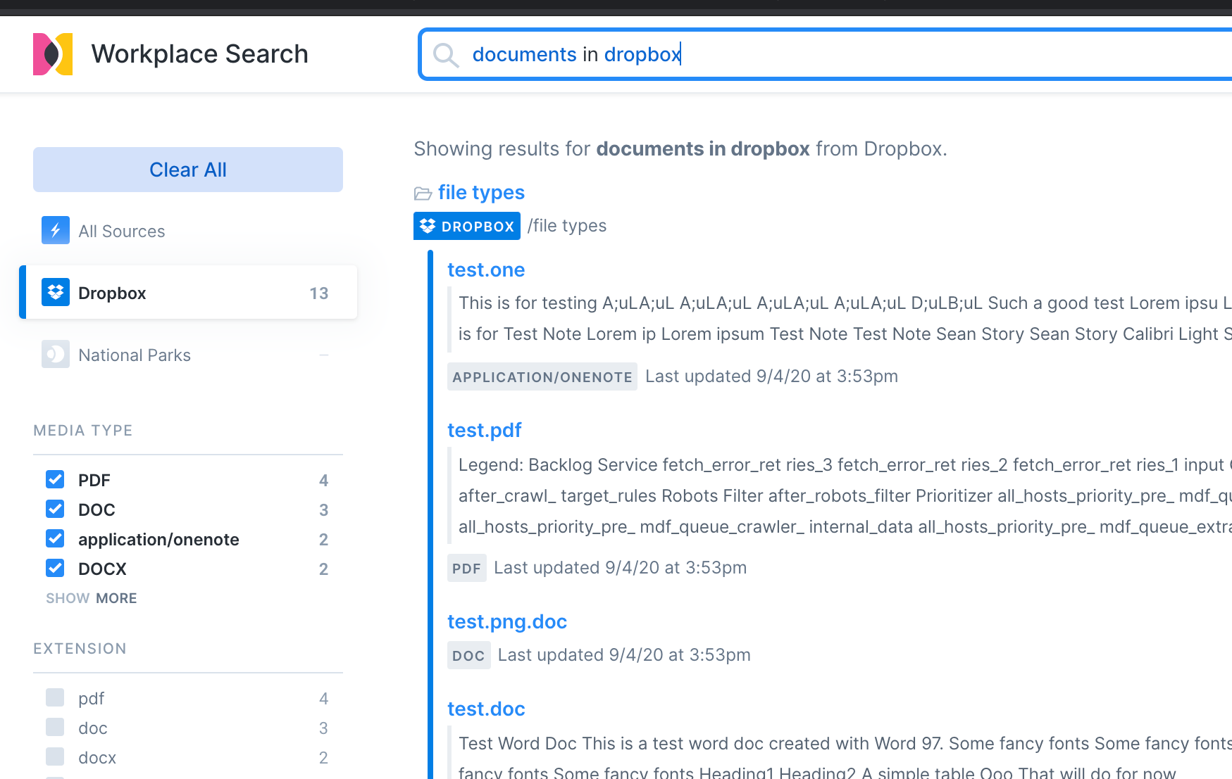

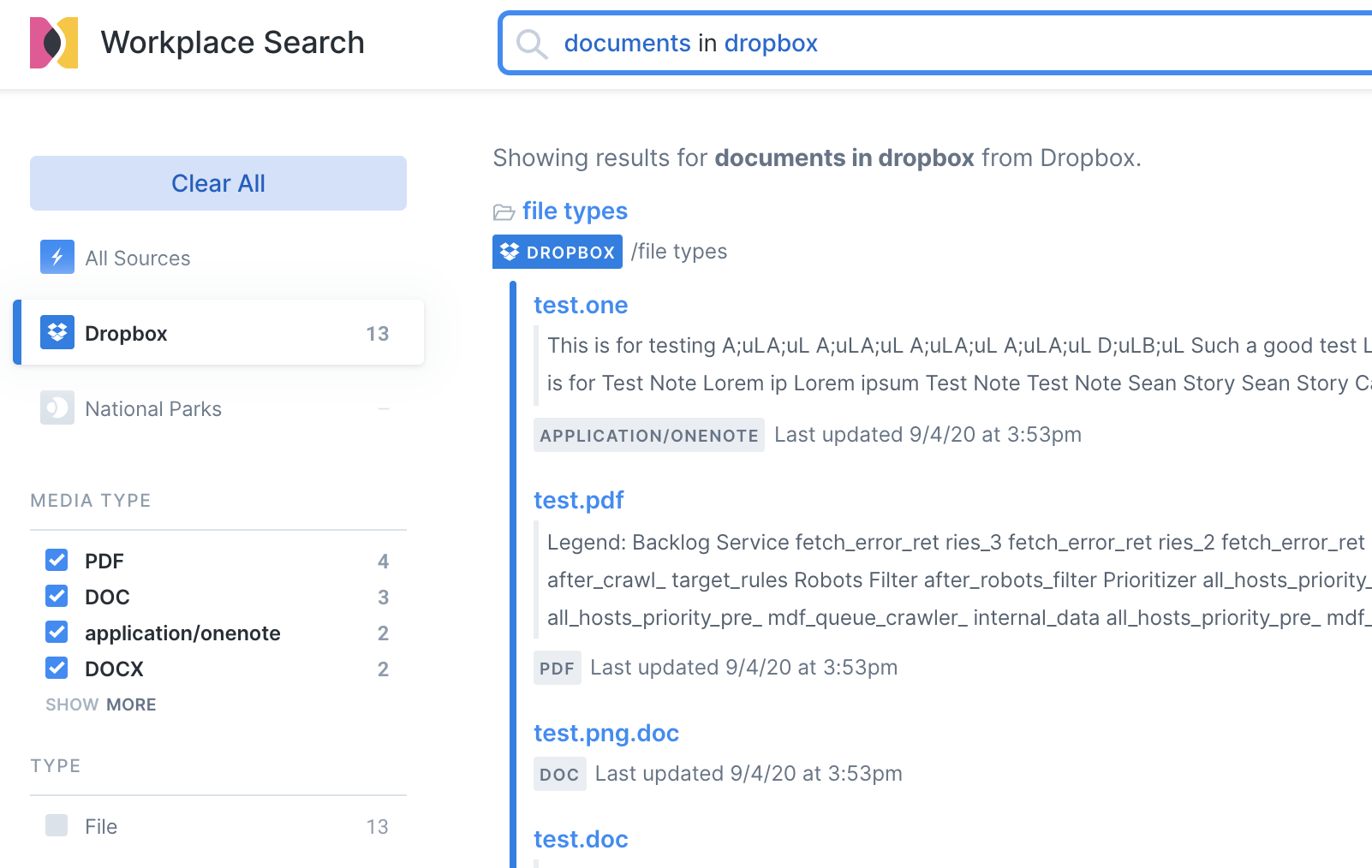

Step 3. Finally, we can see the search experience hides the Extension filter:
