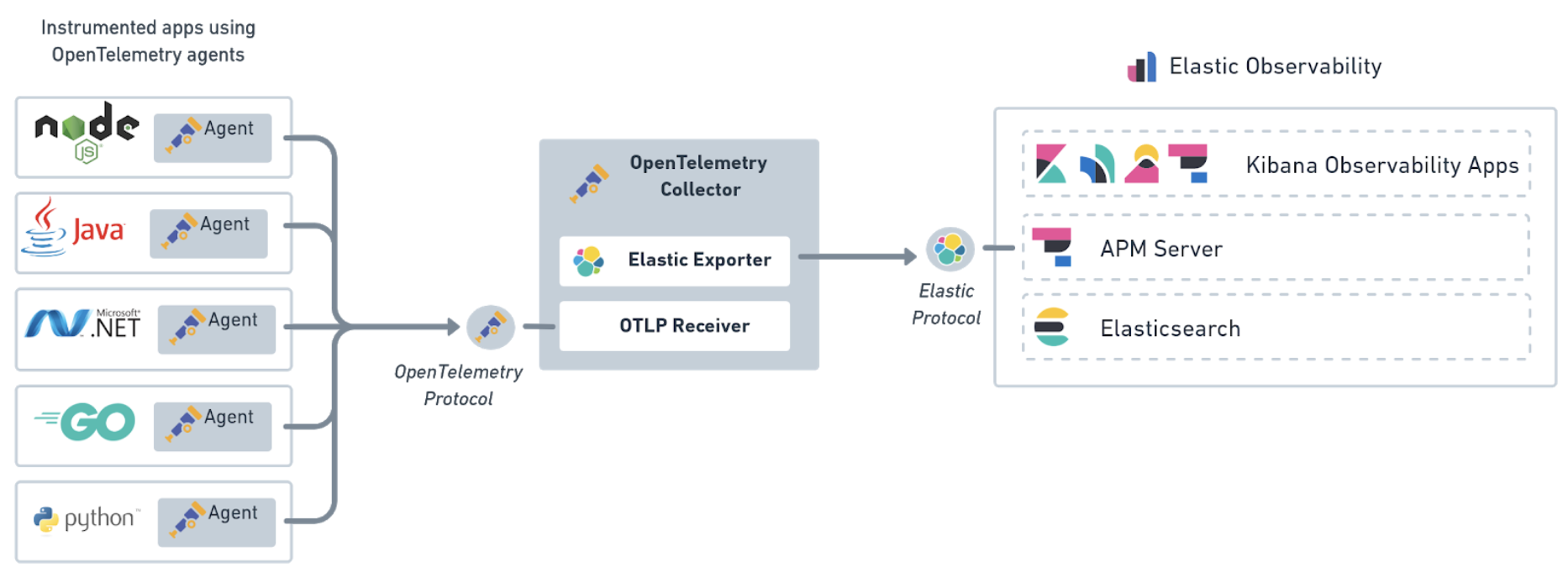

The architecture consists of three main components.
OpenTelemetry Elastic exporter architecture diagram
Agents
The OpenTelemetry agents instrument the applications and export the telemetry data to the OpenTelemetry collector.
The receiver collects the telemetry data from the OpenTelemetry agent, and then the processor defines optional transformations on the data before it’s exported using the Elastic exporter.
Elastic exporter
The exporter translates the OpenTelemetry data collected from your services, applications, and infrastructure to Elastic’s protocol. The data includes trace data and metrics data. By extending the OpenTelemetry collector, no changes are needed in your instrumented services to begin using the Elastic Stack.

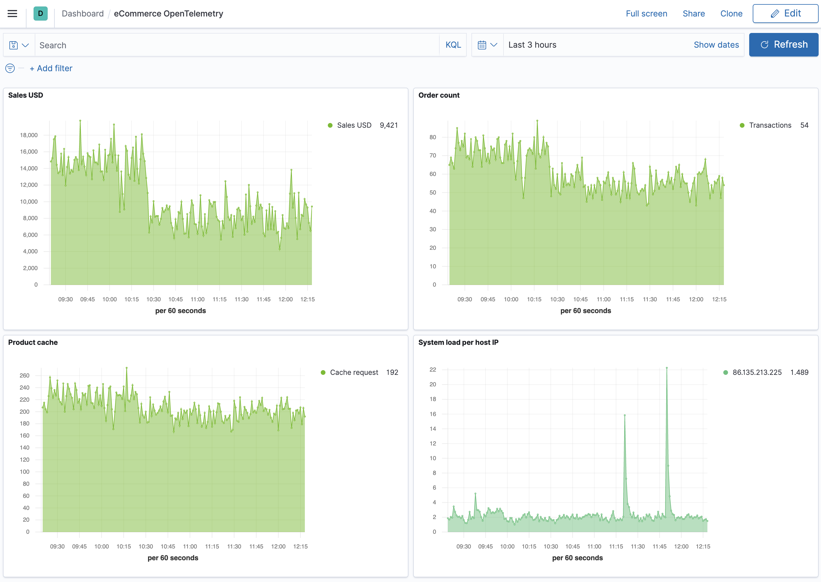

Visualize in Kibana
TSVB within Kibana is the recommended visualization for OpenTelemetry metrics. TSVB is a time series data visualizer that allows you to use the Elasticsearch aggregation framework’s full power. With TSVB, you can combine an infinite number of aggregations to display complex data.
In this example eCommerce OpenTelemetry dashboard, there are four visualizations: sales, order count, product cache, and system load. The dashboard provides us with business KPI metrics, along with performance-related metrics.
OpenTelemetry visualizations
Let’s look at how this dashboard was created, specifically the Sales USD and System load visualizations.
  1. Open the main menu, then click Dashboard.
  2. Click Create dashboard.
  3. Click Save, enter the name of your dashboard, and then click Save again.
  4. Let’s add a Sales USD visualization. Click Edit.
  5. Click Create new and then select TSVB.
  6. For the label name, enter Sales USD, and then select the following:
    • Aggregation: Positive Rate.
    • Field: order_sum.
    • Scale: auto.
    • Group by: Everything
  7. Click Save, enter Sales USD as the visualization name, and then click Save and return.
  8. Now let’s create a visualization of load averages on the system. Click Create new.
  9. Select TSVB.
  10. Select the following:
    • Aggregation: Average.
    • Field: system.cpu.load_average.1m.
    • Group by: Terms.
    • By: host.ip.
    • Top: 10.
    • Order by: Doc Count (default).
    • Direction: Descending.
  11. Click Save, enter System load per host IP as the visualization name, and then click Save and return.
    Both visualizations are now displayed on your custom dashboard.
