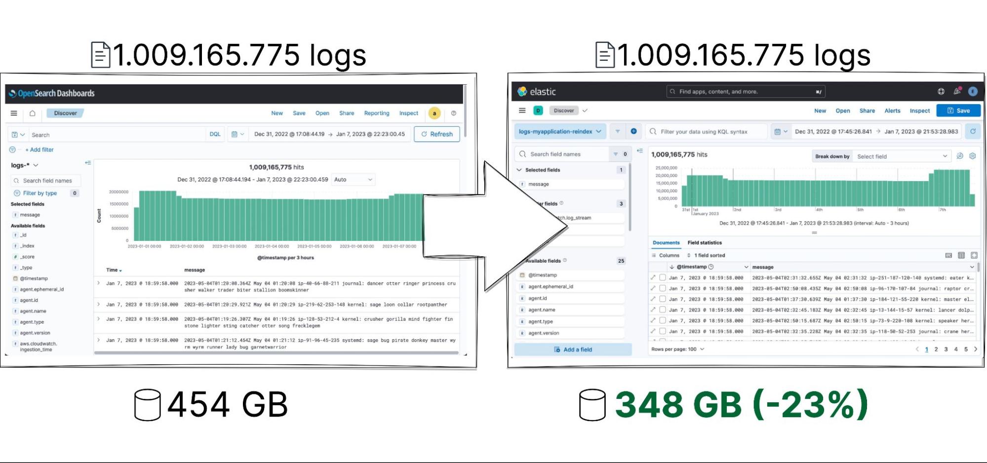

We have in total 1,009,165,775 documents that take 453.5GB of space in OpenSearch, including the replicas. That’s 241.2KB per document. This is going to be important later when we enable a couple optimizations in Elasticsearch that will bring this total size way down without sacrificing performance!
This billion log line data set is spread over nine indices that are part of a datastream we are calling logs-myapplication-prod. We have primary shards of about 25GB in size, according to the best practices for optimal shard sizing. A GET _cat/indices show us the indices we are dealing with:

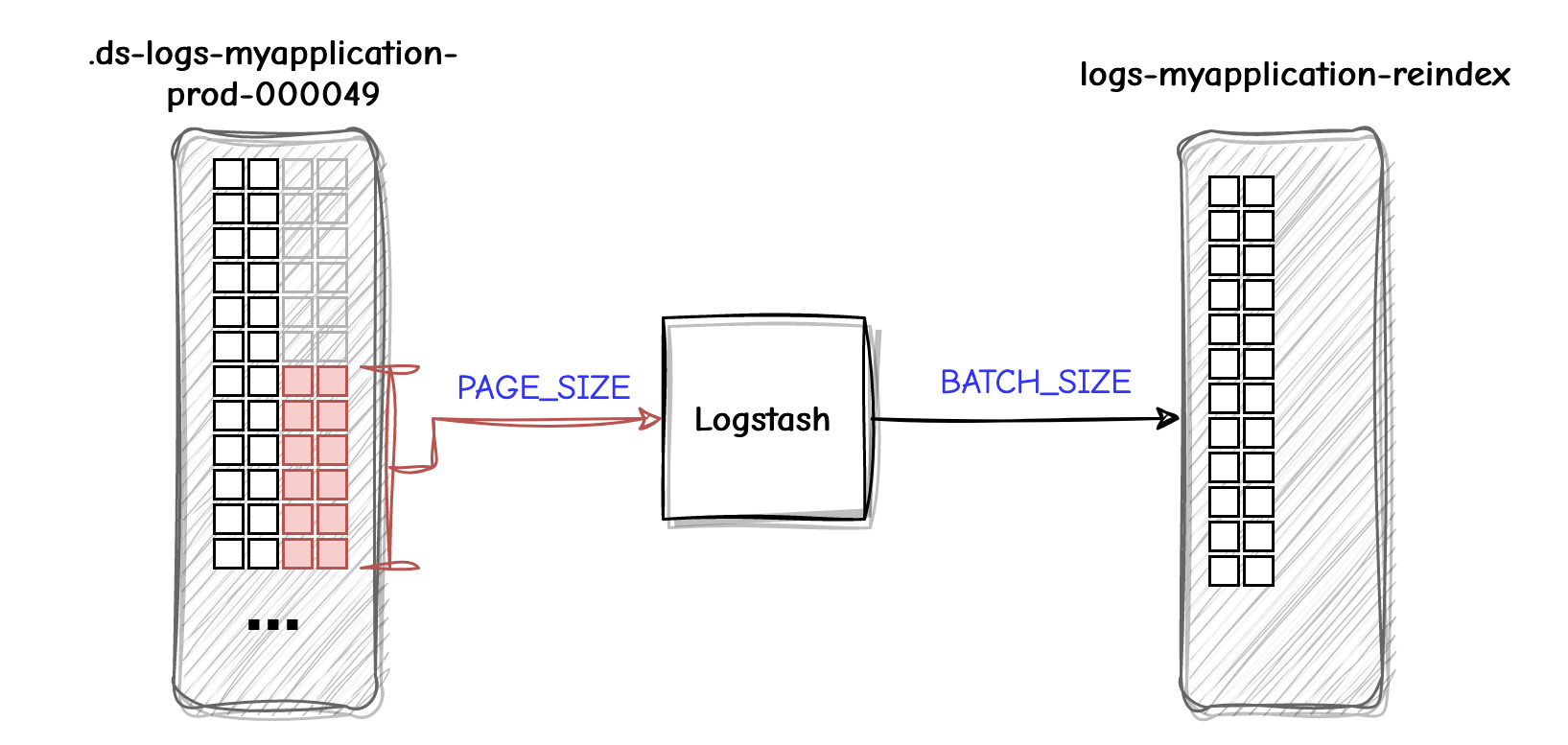

Reading from A and writing in B in can be slow without optimization because it involves paginating through the results, transferring each batch over the network to Logstash, which will assemble the documents in another batch and then transfer those batches over the network again to Elasticsearch, where the documents will be indexed. So when it comes to such large data sets, we must be very efficient and extract every bit of performance where we can.
Let’s start with the facts — what do we know about the data we need to transfer? We have nine indices in the datastream, each with about 100 million documents. Let’s test with just one of the indices and measure the indexing rate to see how long it takes to migrate. The indexing rate can be seen by activating the monitoring functionality in Elastic® and then navigating to the index you want to inspect.

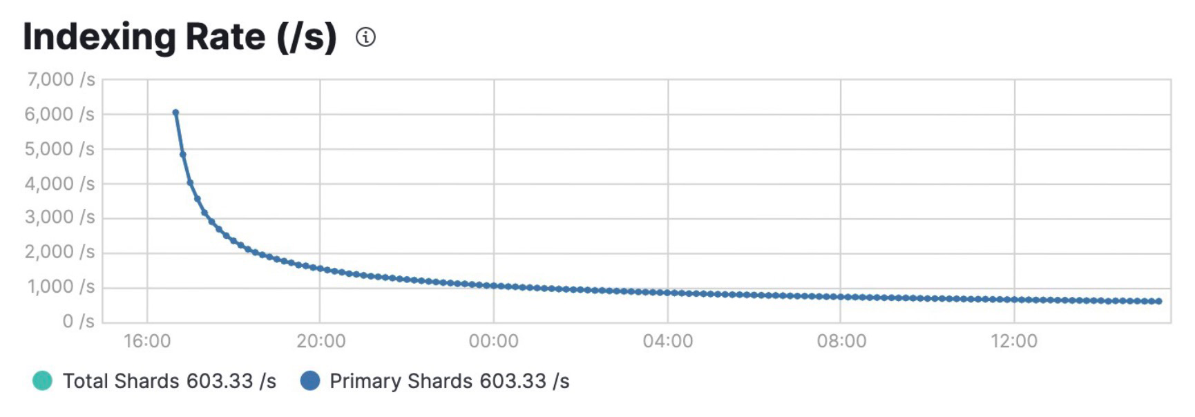

Scrolling in the deep
The simplest approach for transferring the log lines over would be to make Elasticsearch scroll over the entire data set and check it later when it finishes. Here we will introduce our first two variables: PAGE_SIZE and BATCH_SIZE. The former is how many records we are going to bring from the source every time we query it, and the latter is how many documents are going to be assembled together by Logstash and written to the destination index.
With such a large data set, the scroll slows down as this deep pagination progresses. The indexing rate starts at 6,000 docs/second and steadily descends down to 700 docs/second because the pagination gets very deep. Without any optimization, it would take us 19 days (!) to migrate the 1 billion documents. We can do better than that!

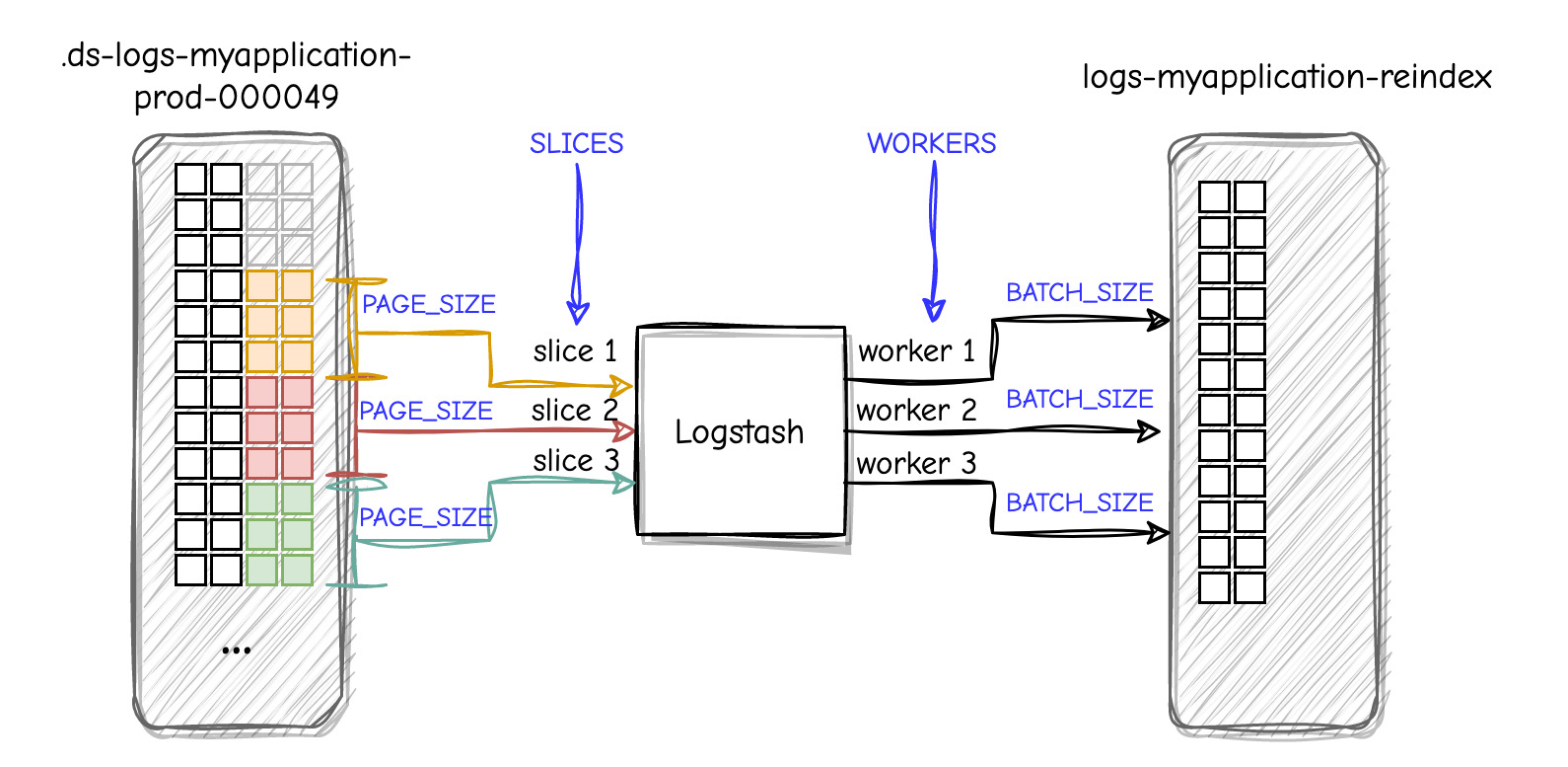

Slice me nice
We can optimize scrolling by using an approach called Sliced scroll, where we split the index in different slices to consume them independently.
Here we will introduce our last two variables: SLICES and WORKERS. The amount of slices cannot be too small as the performance decreases drastically over time, and it can’t be too big as the overhead of maintaining the scrolls would counter the benefits of a smaller search.

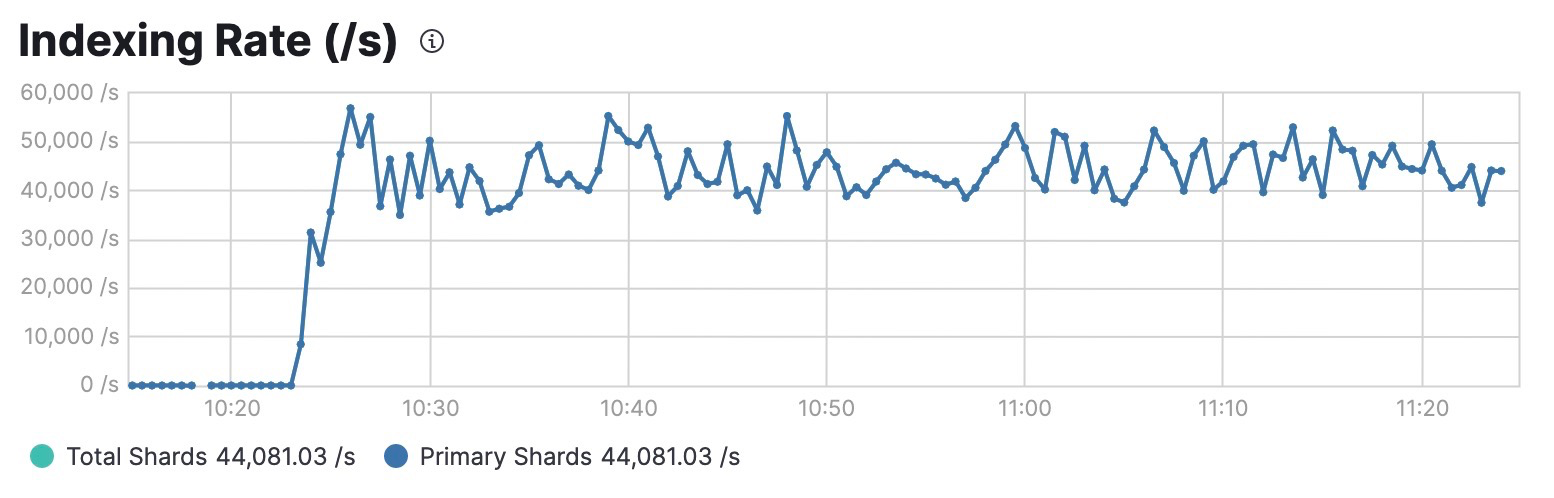

Let’s start by migrating a single index (out of the nine we have) with different parameters to see what combination gives us the highest throughput.
SLICESPAGE_SIZEWORKERSBATCH_SIZEAverage Indexing Rate
3500350013,319 docs/sec
31,00031,00013,048 docs/sec
4250425010,199 docs/sec
4500450012,692 docs/sec
41,00041,00010,900 docs/sec
5500550012,647 docs/sec
51,00051,00010,334 docs/sec
52,00052,00010,405 docs/sec
102501025014,083 docs/sec
1025041,00012,014 docs/sec
1050041,00010,956 docs/sec
It looks like we have a good set of candidates for maximizing the throughput for a single index, in between 12K and 14K documents per second. That doesn't mean we have reached our ceiling. Even though search operations are single threaded and every slice will trigger sequential search operations to read data, that does not prevent us from reading several indices in parallel.
By default, the maximum number of open scrolls is 500 — this limit can be updated with the search.max_open_scroll_context cluster setting, but the default value is enough for this particular migration.

Index template (and saving 23% in disk space)
Since we are here, we’re going to go ahead and enable Synthetic Source, a clever feature that allows us to store and discard the original JSON document while still reconstructing it when needed from the stored fields.
For our example, enabling Synthetic Source resulted in a remarkable 23.4% improvement in storage efficiency , reducing the size required to store a single document from 241.2KB in OpenSearch to just 185KB in Elasticsearch.

After a couple hours, we successfully migrated 1 billion documents from OpenSearch to Elasticsearch and even saved 23% plus on disk storage! Now that we have the logs in Elasticsearch how about extracting actual business value from them? Logs contain so much valuable information - we can not only do all sorts of interesting things with AIOPS, like Automatically Categorize those logs, but also extract business metrics and detect anomalies on them, give it a try.
OpenSearchElasticsearch
IndexdocssizeIndexdocssizeDiff.
.ds-logs-myapplication-prod-00003711684215827285520870logs-myapplication-reindex-0000371168421582199843532921.46%
.ds-logs-myapplication-prod-00003811099411627263291740logs-myapplication-reindex-0000381109941162154001108223.45%
.ds-logs-myapplication-prod-00004011336282327872438186logs-myapplication-reindex-0000401133628232223464193222.50%
.ds-logs-myapplication-prod-00004111240001927618801653logs-myapplication-reindex-0000411124000192205945386822.38%
.ds-logs-myapplication-prod-00004211385917426686723701logs-myapplication-reindex-0000421138591742109376610823.41%
.ds-logs-myapplication-prod-00004311382101627657006598logs-myapplication-reindex-0000431138210162205945475222.52%
.ds-logs-myapplication-prod-00004411109359627281936915logs-myapplication-reindex-0000441110935962155951342223.43%
.ds-logs-myapplication-prod-00004811427353928111420495logs-myapplication-reindex-0000481142735392226439893923.21%
.ds-logs-myapplication-prod-00004910251933423731274338logs-myapplication-reindex-0000491025193341930725000120.56%
