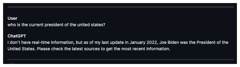

An LLM's knowledge is frozen, which means it doesn't know anything about events that happen post-training. This means it will not be able to reliably answer questions about current events. Models are typically trained to qualify the answers they give for such questions.

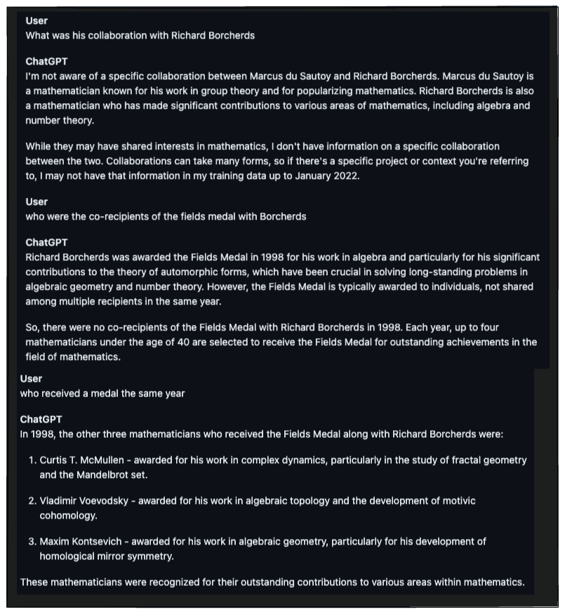

It has been suggested that LLMs capture in their parameters something like a knowledge graph representation of general ontology: representing facts about and relationships between entities. Common facts that appear frequently in the training data are well represented in the knowledge graph. However, niche knowledge which is unlikely to have many examples in the training data is only approximately represented. As such LLMs have noisy understanding of such facts. The alignment process, where models are calibrated about what they know, is essential. Mistakes often occur in the gray area between known and unknown information, highlighting the challenge of distinguishing relevant details.
In the example above, the question about Fields Medal winners in the same year as Borcherds, is a prime example of this sort of niche knowledge. In this case we seeded the conversation with information about other mathematicians and ChatGPT appeared to get confused about what information to attend to. For example, it missed Tim Gowers and added Vladimir Voevodsky (who won in 2002).

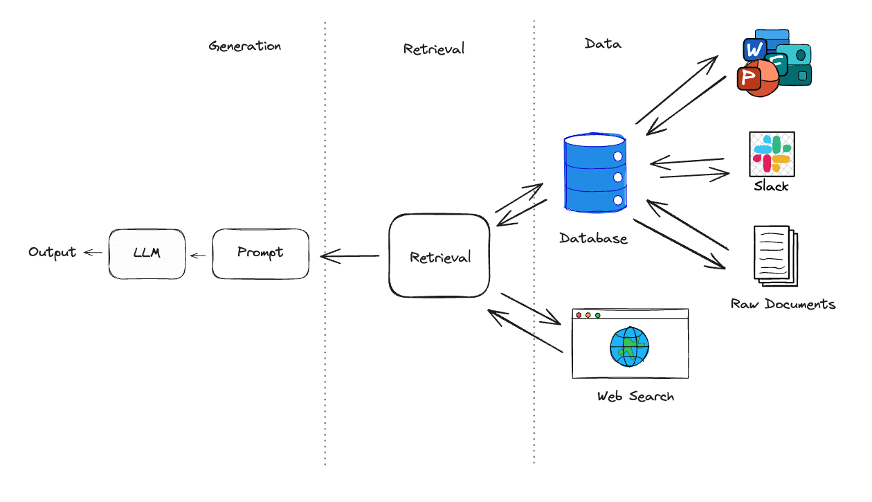

RAG pipeline flow
When directly interacting with a model, the LLM is given a question and generates a response based on its parametric knowledge. RAG adds an extra step to the pipeline, using retrieval to find relevant data that builds additional context for the LLM.
In the example below, we use a dense vector retrieval strategy to retrieve relevant source knowledge from the data. This source knowledge is then passed to the LLM as context to generate a response.
RAG doesn't have to use dense vector retrieval, it can use any retrieval strategy that can retrieve relevant source knowledge from the data. It could be a simple keyword search or even a Google web search.

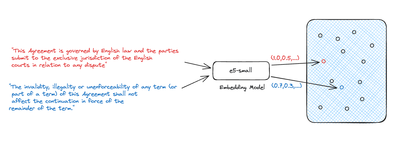

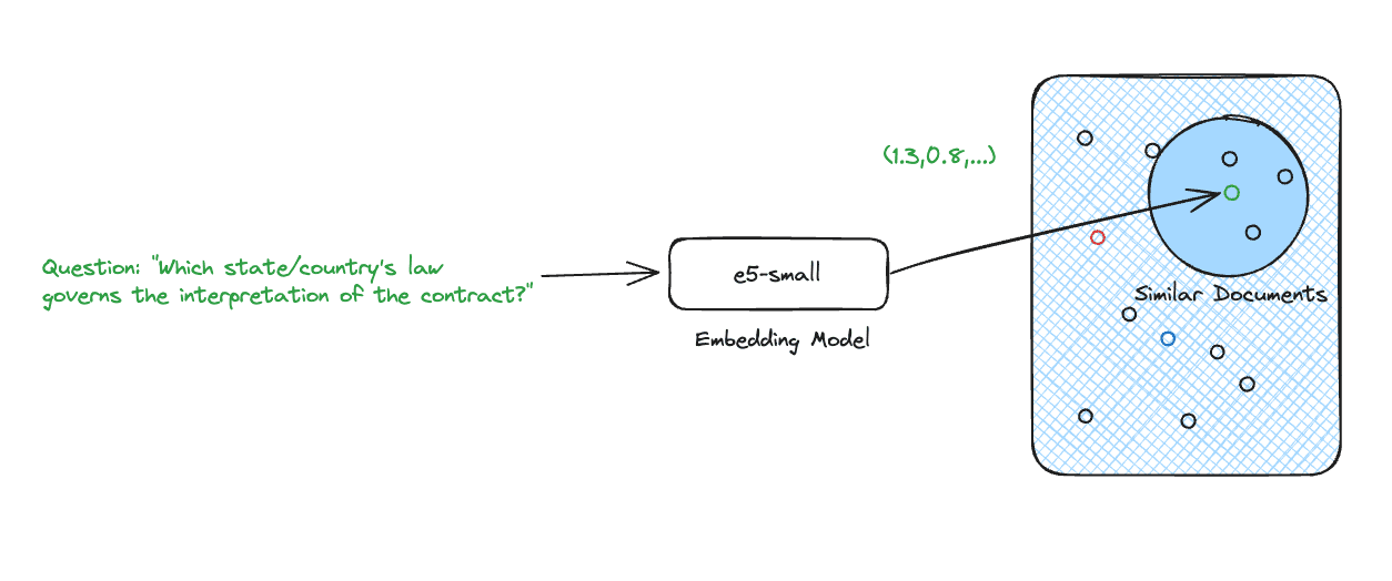

The most common approach for retrieval with Generative AI is using semantic search with dense vectors. Semantic search is a technique that requires an embedding model to transform natural language input into dense vectors which represent that source knowledge. We rely on these dense vectors to represent the source knowledge because they are able to capture the semantic meaning of the text. This is important because it allows us to compare the semantic meaning of the source knowledge with the question to determine if the source knowledge is relevant to the question.
Given a question and its embedding, we can find the most relevant source knowledge.

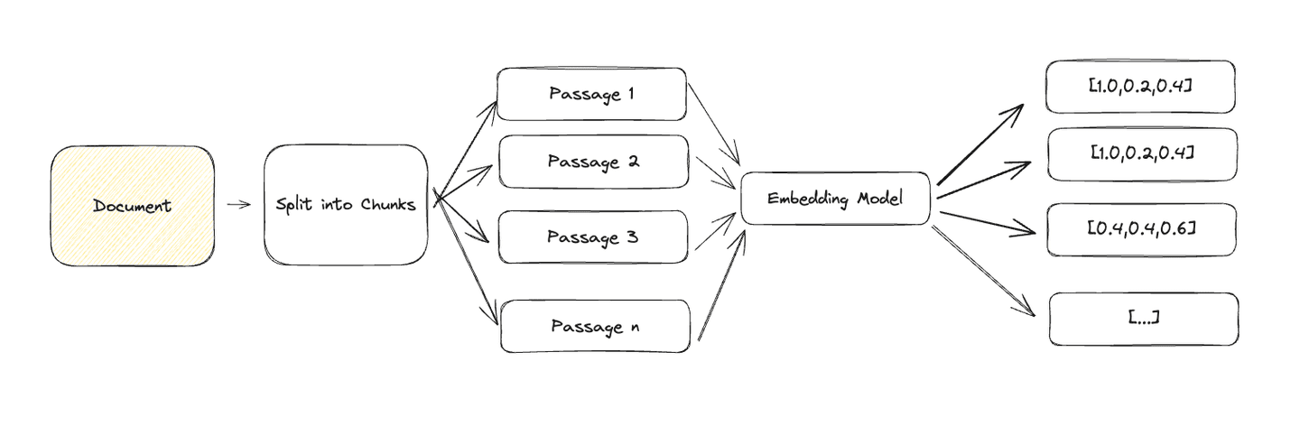

Large documents are difficult to represent as a single dense vector because they contain multiple semantic meanings. For effective retrieval, we need to break down the document into smaller chunks of text that can be accurately represented as a single dense vector.
A common approach for generic text is to chunk by paragraphs and represent each paragraph as a dense vector. Depending on your use case, you may want to break the document down using titles, headings, or even sentences, as chunks.
