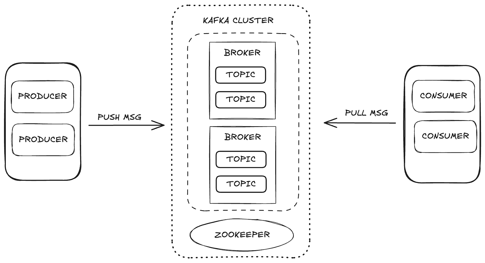

A brief introduction to Apache Kafka
Apache Kafka is a distributed streaming platform that enables high scalability and availability, as well as fault tolerance. In Kafka, data management occurs through the main components:
  • Broker: responsible for storing and distributing messages between producers and consumers.
  • Zookeeper: manages and coordinates the Kafka brokers, controlling the state of the cluster, partition leaders, and consumer information.
  • Topics: channels where data is published and stored for consumption.
  • Consumers and Producers: while producers send data to the topics, consumers retrieve that data.
These components work together to form the Kafka ecosystem, providing a robust framework for data streaming.

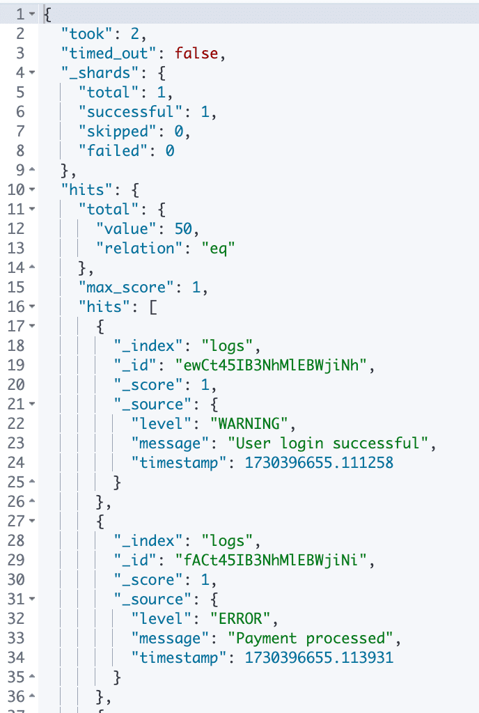

Visualizing Data in Kibana
With Kibana, we can explore and validate the data ingested from Kafka and indexed in Elasticsearch. By accessing Dev Tools in Kibana, you can view the indexed messages and confirm that the data is as expected. For example, if our Kafka producer sent 5 batches of 10 messages each, we should see a total of 50 records in the index.
To verify the data, you can use the following query in the Dev Tools section:
GET /logs/_search
  "query": {
    "match_all": {}
Response:

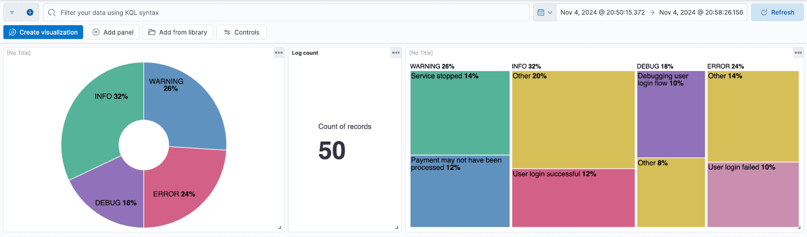

Additionally, Kibana provides the ability to create visualizations and dashboards that can help make the analysis more intuitive and interactive. Below, you can see some examples of the dashboards and visualizations we created, which illustrate the data in various formats, enhancing our understanding of the information processed.
