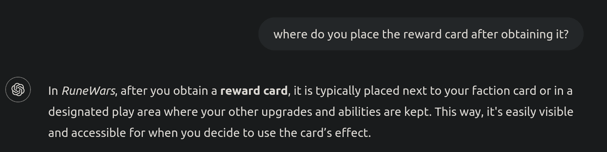

Runewars is a miniature game with a fairly complex set of rules explained in its 40 pages manual, and going back to play it after a few years since the last match means forgetting most of the rules. Let's try and ask ChatGPT (version GPT-4o) for some refreshers:
That's not just generic, it's wrong: reward cards must be hidden from other players. It's clear that it does not know the rules to this game, so let's augment the model with the rules!
