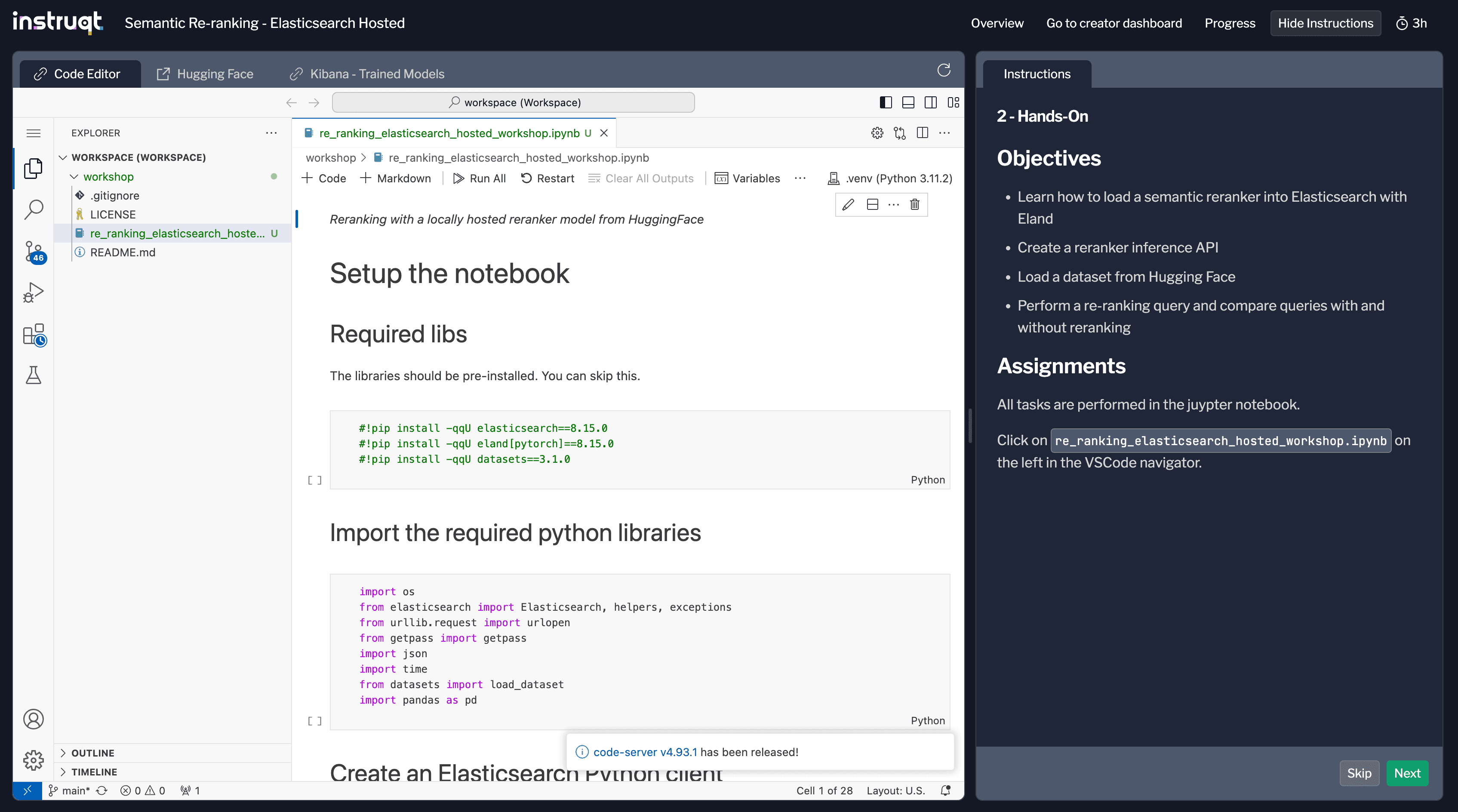

You can try the accompanying notebook in a live workshop environment for free!
Click here to head over to the lab now.
If you haven't clicked on one of the many links to the accompanying notebook, now's the time!
