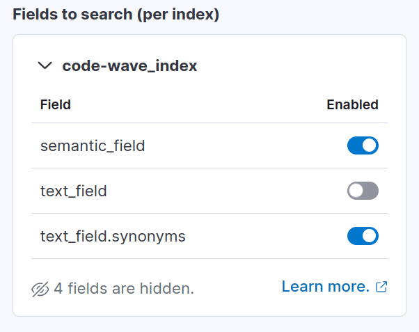

We'll use the semantic_text field to do semantic search and the synonyms graph token filter to handle multiword synonyms.
We also created both a text_field.synonym version and a text_field version of the field for more control on how we query the field with, or without considering the synonyms.
Finally, we use copy_to to copy the value of text_field to the semantic_text version of the field to enable both full-text and semantic queries.

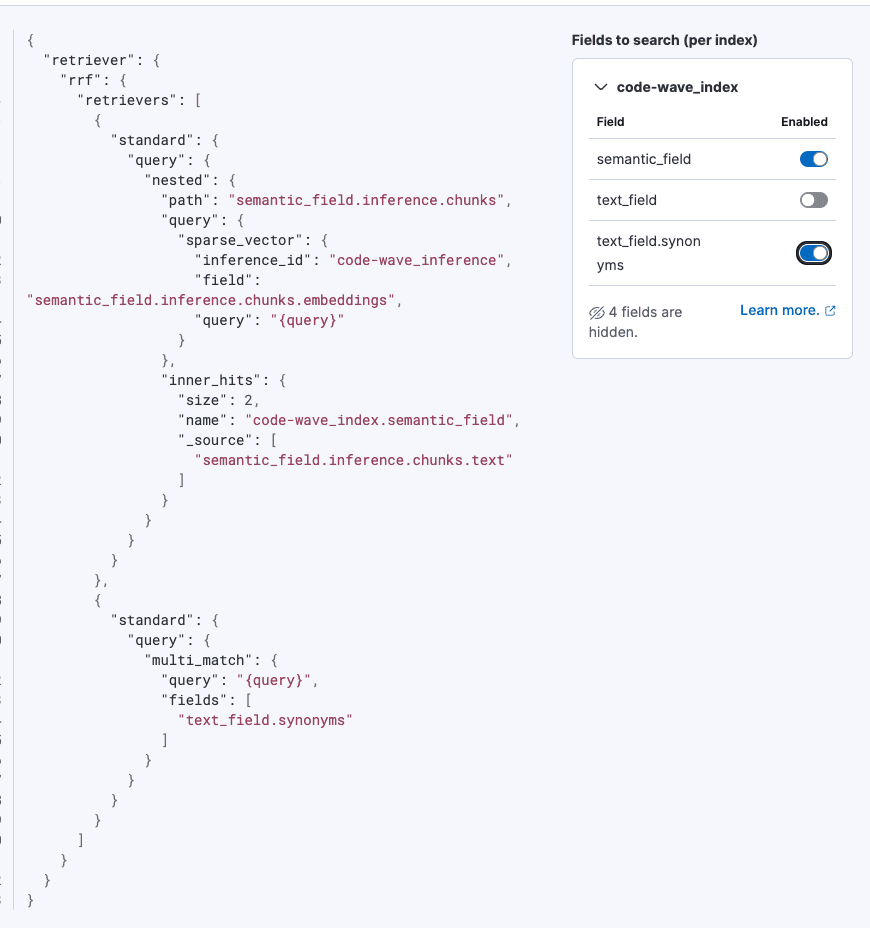

When using semantic search, the documents that are relevant for the query do not come in the first positions since the dataset includes the term "holidays" in contexts unrelated to "Paid time off".
Hybrid search gives us the ability to combine the results of both full-text and semantic search queries into one, normalized result set by using RRF (Reciprocal Rank Fusion) to balance the scores from different retrievers.
GET code-wave_index/_search
"_source": "text_field",
"retriever": {
"rrf": {
"retrievers": [
"standard": {
"query": {
"nested": {
"path": "semantic_field.inference.chunks",
"query": {
"sparse_vector": {
"inference_id": "code-wave_inference",
"field": "semantic_field.inference.chunks.embeddings",
"query": "holidays"
"standard": {
"query": {
"multi_match": {
"query": "holidays",
"fields": [
"text_field.synonyms"

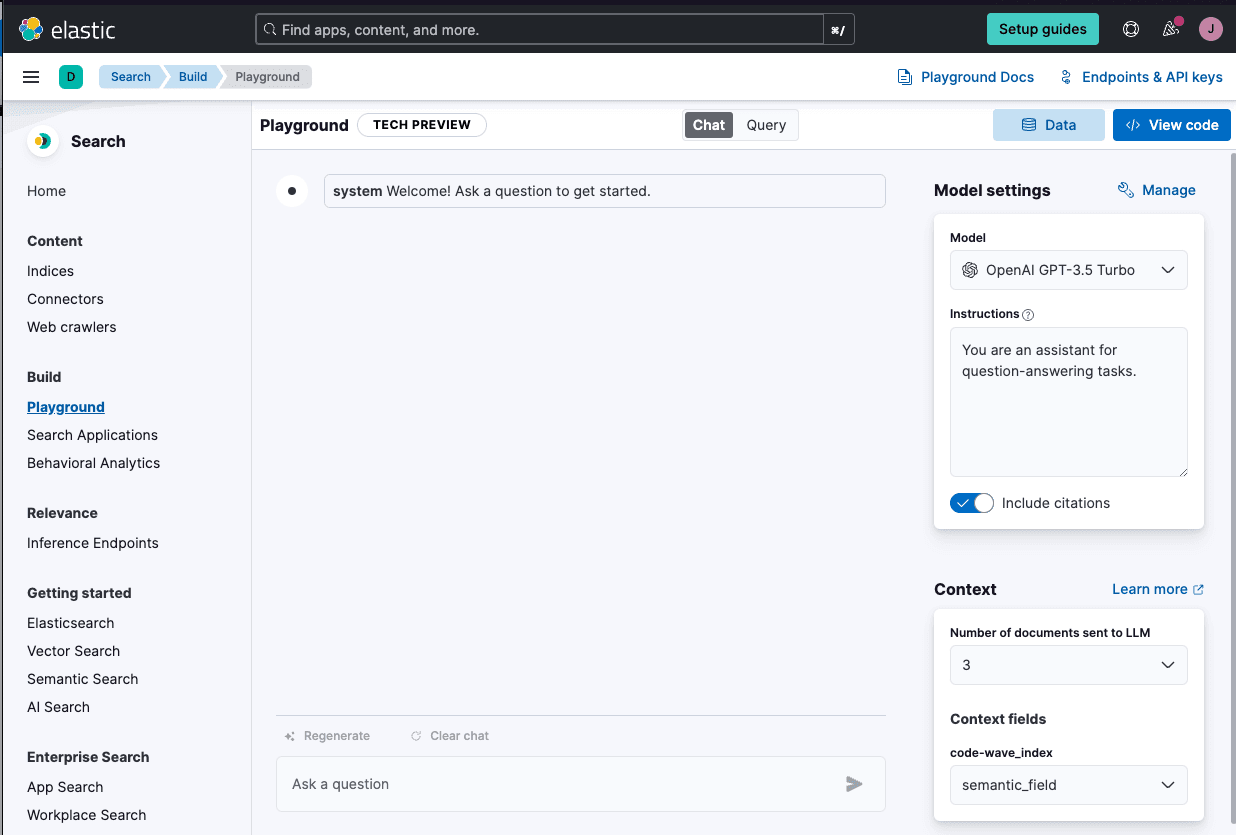

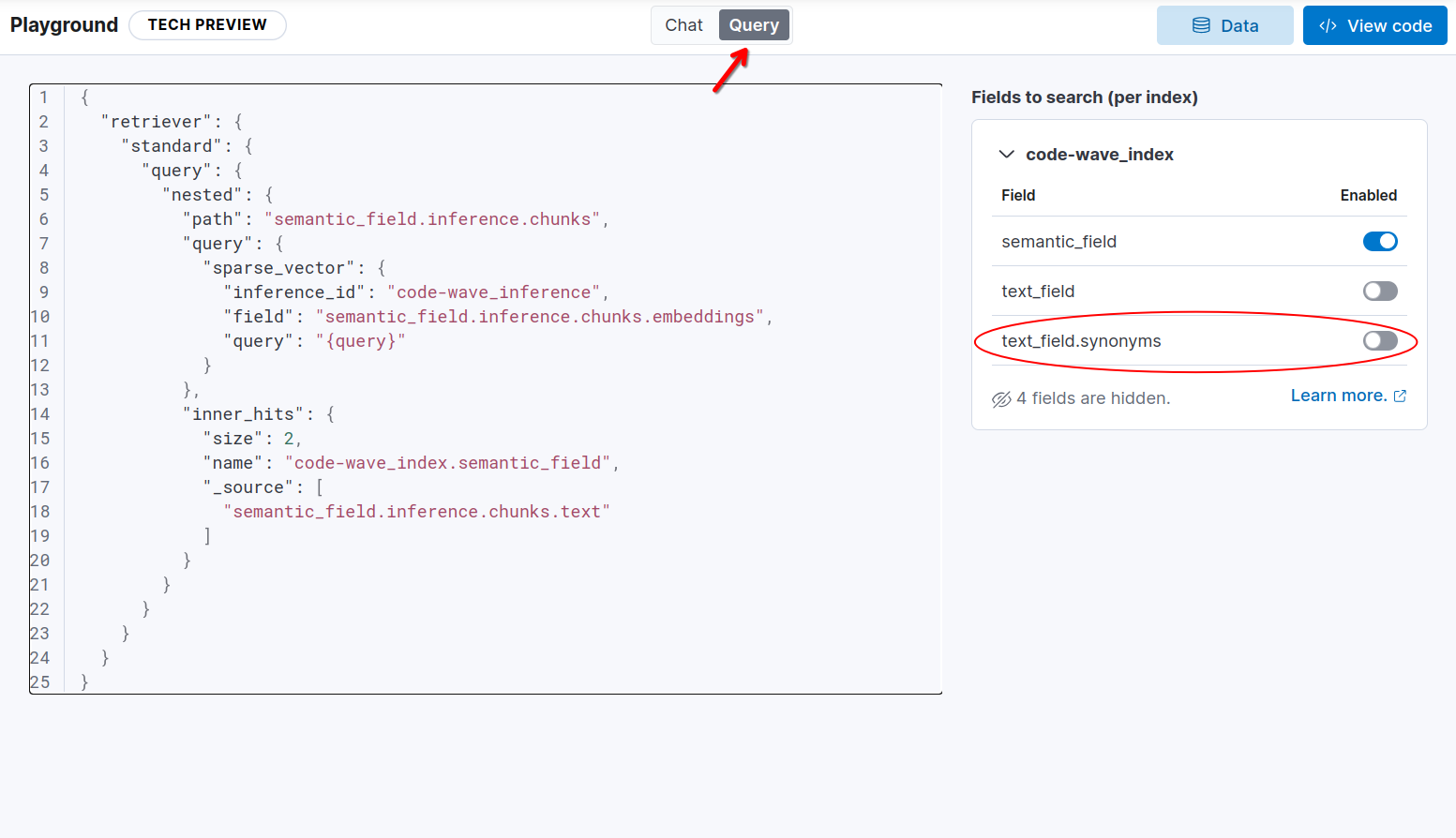

You can access Playground from Search>Playground. From there, you need to configure the LLM you want to use and select the index we've already created to be sent as context. You can read more about Playground and its configuration here
Once Playground has been configured, if we click the query button, we can see that synonyms are deactivated:

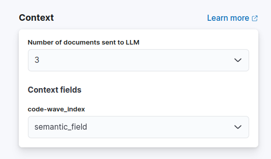

For each question, we'll send the first three hits of the previous query to the LLM, as context:

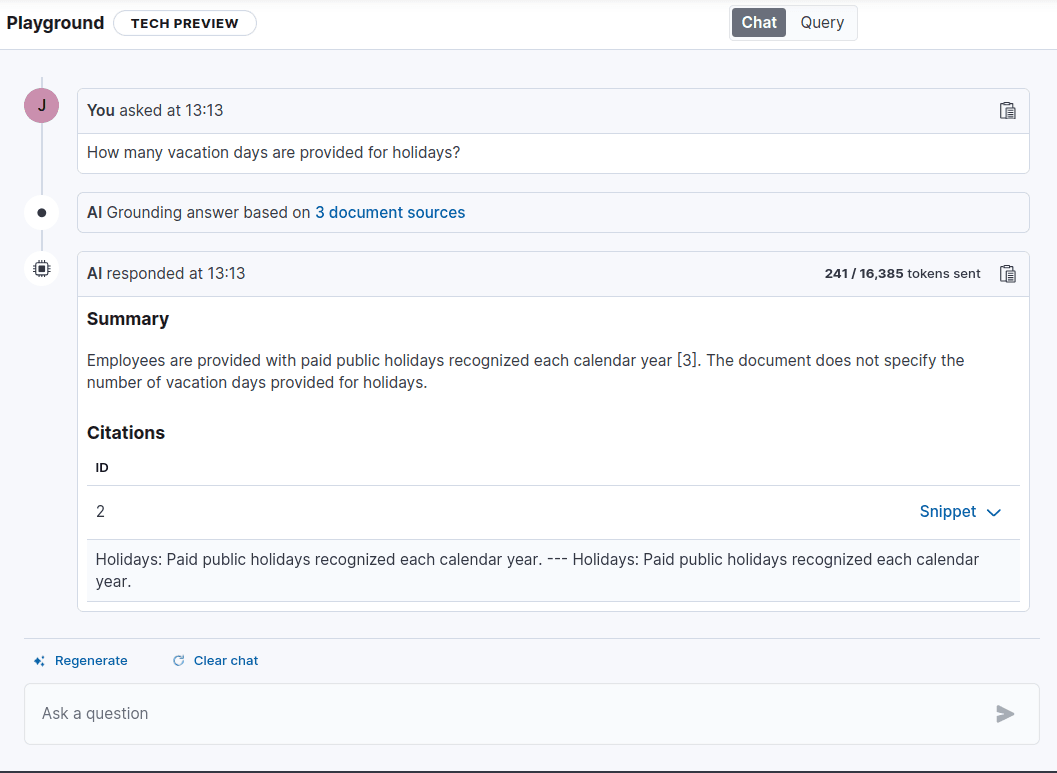

Now, let's ask the question to Playground and check the results with synonyms deactivated:
Since the document specifying the amount of holidays employees get a year is not among the first three hits, the LLM cannot answer the question. In this case, the closest result is in document [2].
Note: By clicking on "Snippet", we can see the specific content in Elasticsearch from where the answer comes.

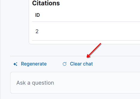

Let's clean up the chat, activate synonyms and ask the same question again:
Note that when you enable a semantic_text field, and a text field, Playground will automatically generate a hybrid search query:

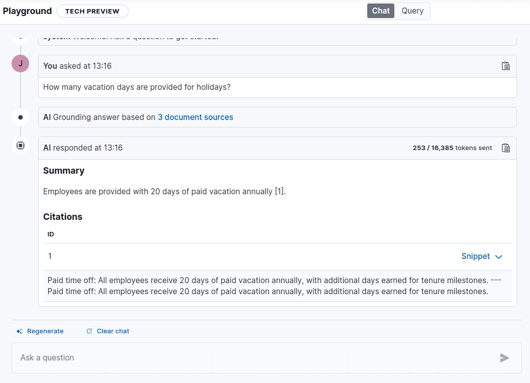

Let’s repeat the question, now with synonyms activated:
Now, the answer does include the document we were searching for, since the synonym allowed for document [1] to be sent to the LLM.
